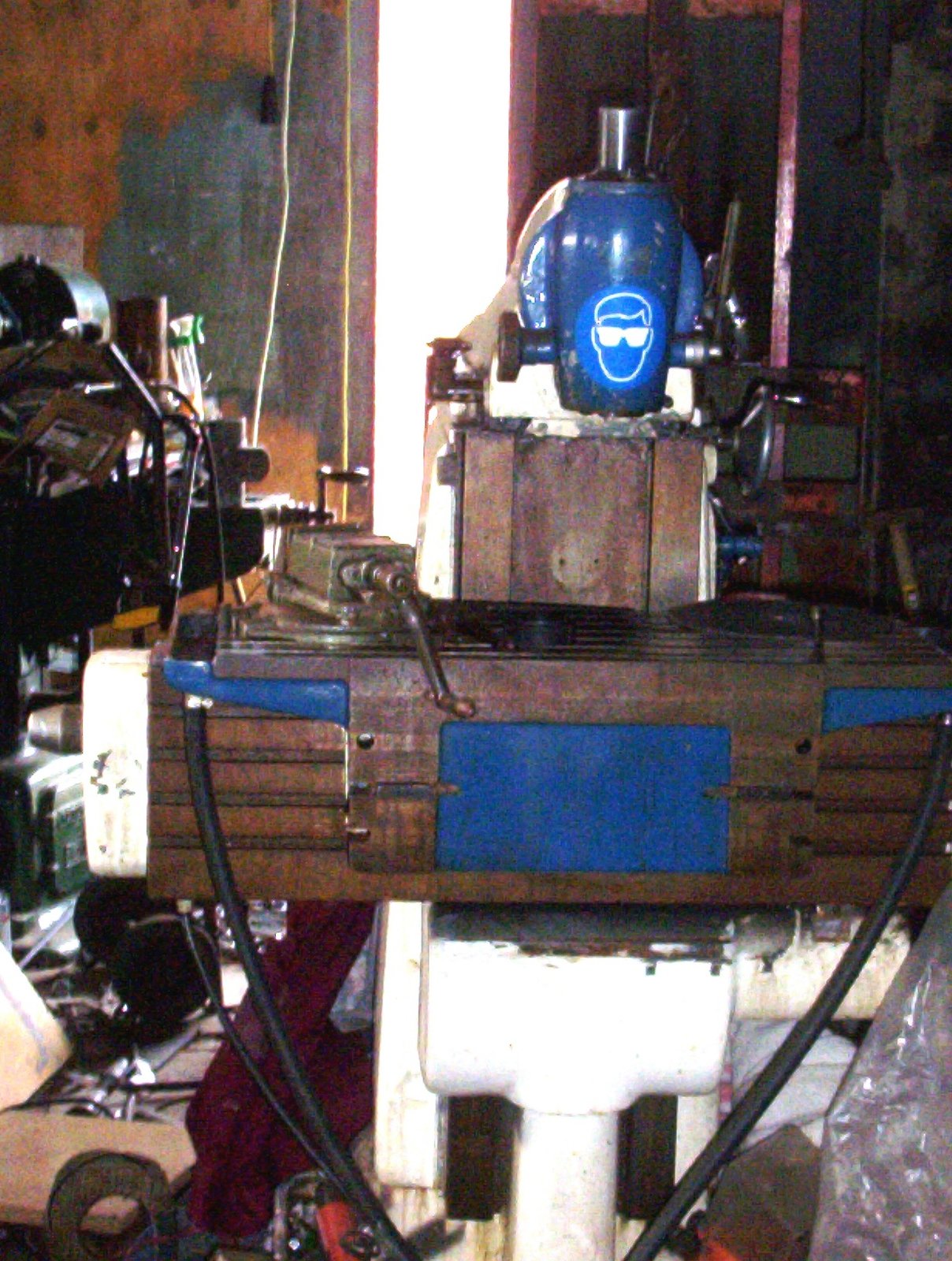

OK I am making a dedicated thread in the interests of keeping things clear and separated.
This is the mill when I got it home:
I noticed pretty much straight away that the X-axis is still stuck, the problem is that the tapered gib is really, really stuck, the gib screw looked like this:
The bit on the tapered gib that retains the screw has sheared off, the screw is bent and the gib has gotten stuck.
And a closer look at the scale head... Don't think a repair is possible of this.
