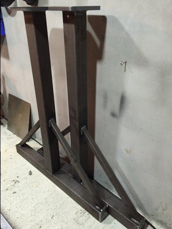

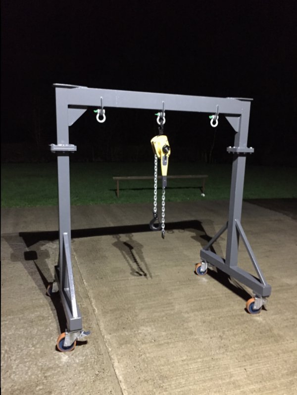

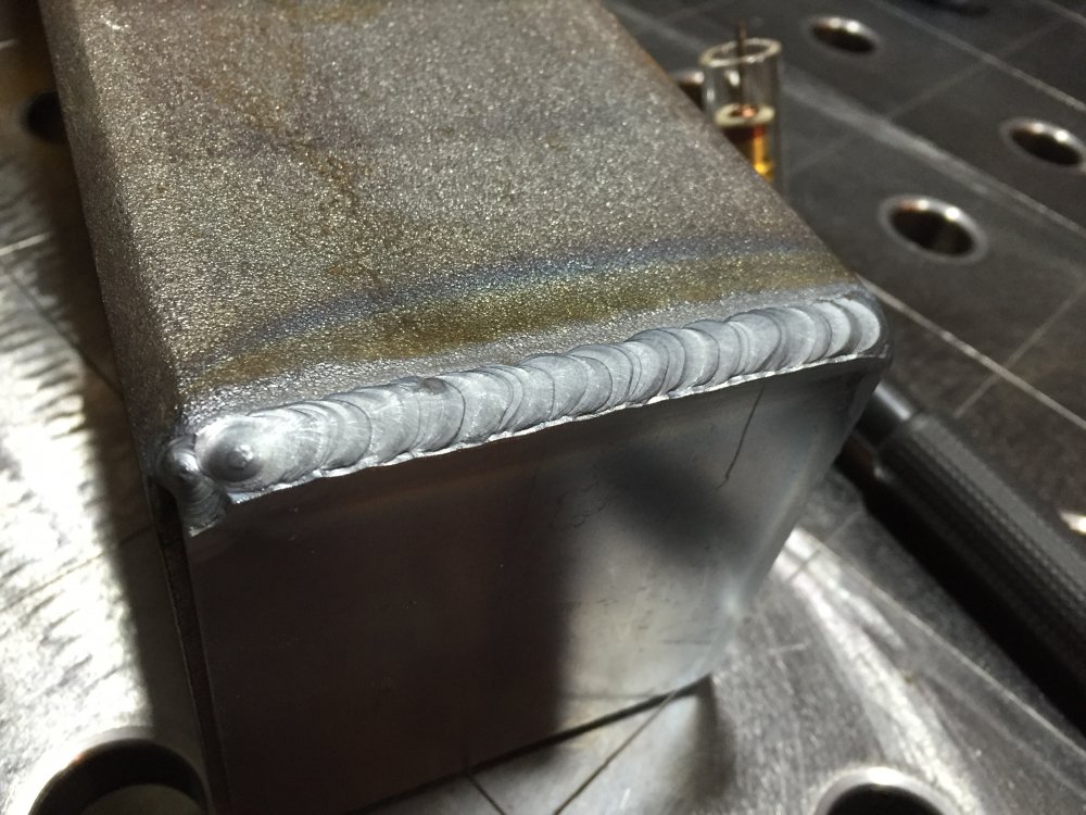

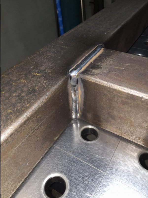

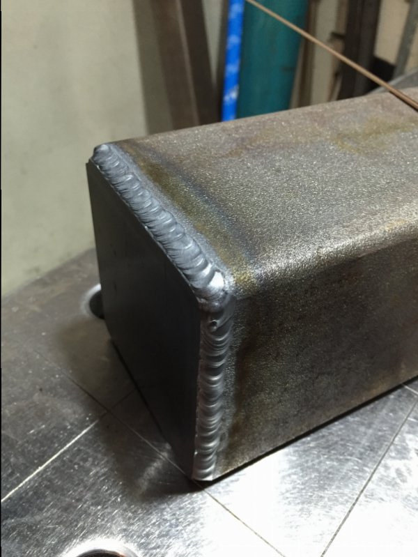

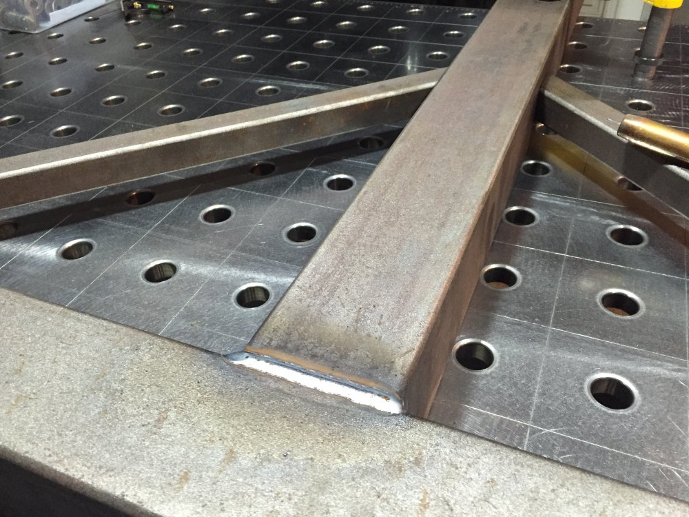

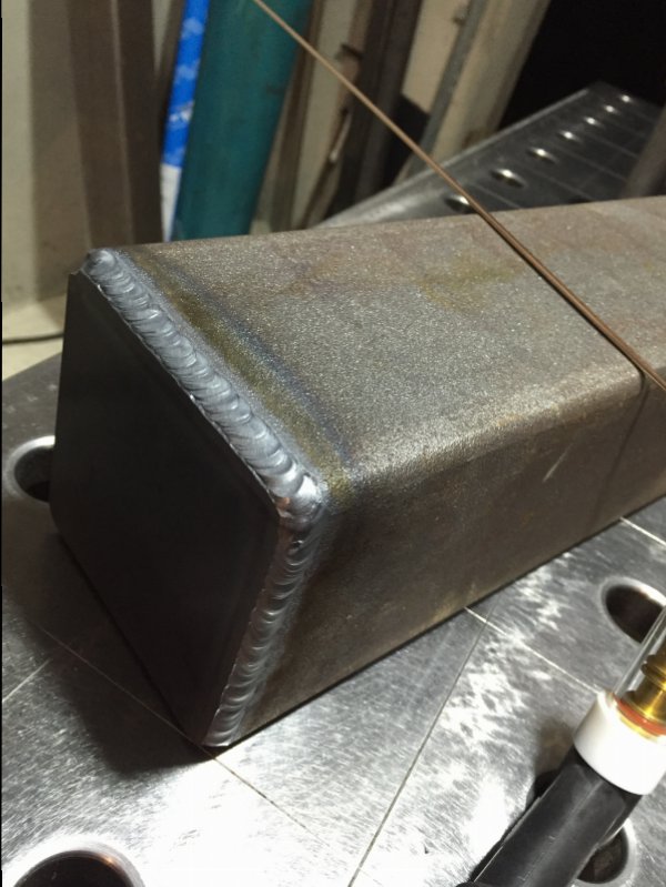

Cap plates TIG welded onto the ends of the rails. I'm a total TIG novice, so any comments from the experts are very welcome. I used 2.4 mm ER70S-2, a 2.4 mm 2% lanthanated electrode, at 150 amps, DCEN obviously. A few wee nips eaten out of the plate edge
