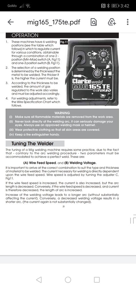

Hi folks.... I've been working away on the body shell for my project, mostly structural so far with no problems. However now I'm starting on the panels and I'm finding the performance of the 160te is a bit hit and miss... I'm wondering if maybe the 5kg wire roll is a bit heavy for the old girl. Any thoughts?
....found the user guide from the clarke website & it says they're designed to accept 5 or 15kg rolls
