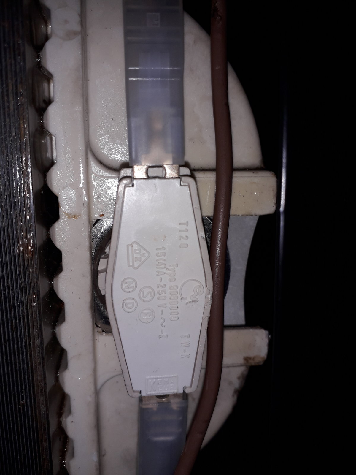

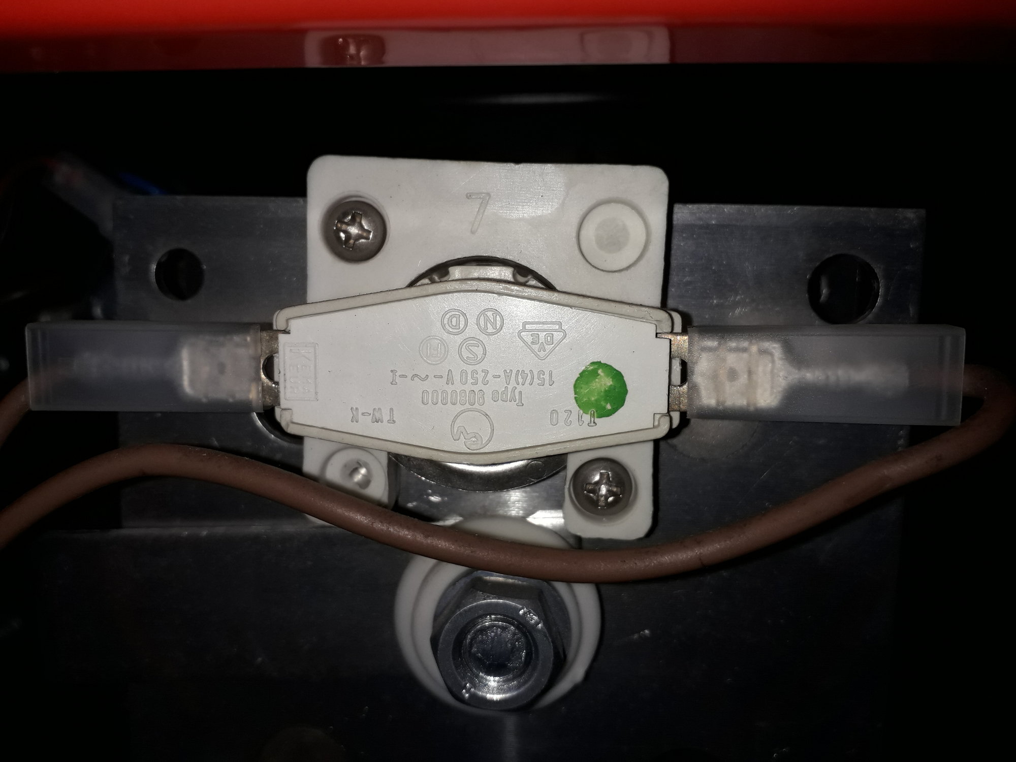

wasn't 100% sure the red, yellow or blue crimps would be suitable.
look for somewhere that does good quality crimps and use a decent ratchet crimper otherwise you will be storing up more problems for the future
Don't be tempted to use Lucas connectors which afaik are limited to about 30 amps max but instead use something like http://www.vehicle-wiring-products.eu/product.php/1277/butt-splice-connector in the correct size for the wires and don't forget to put the heat shrink on the wire BEFORE you crimp
