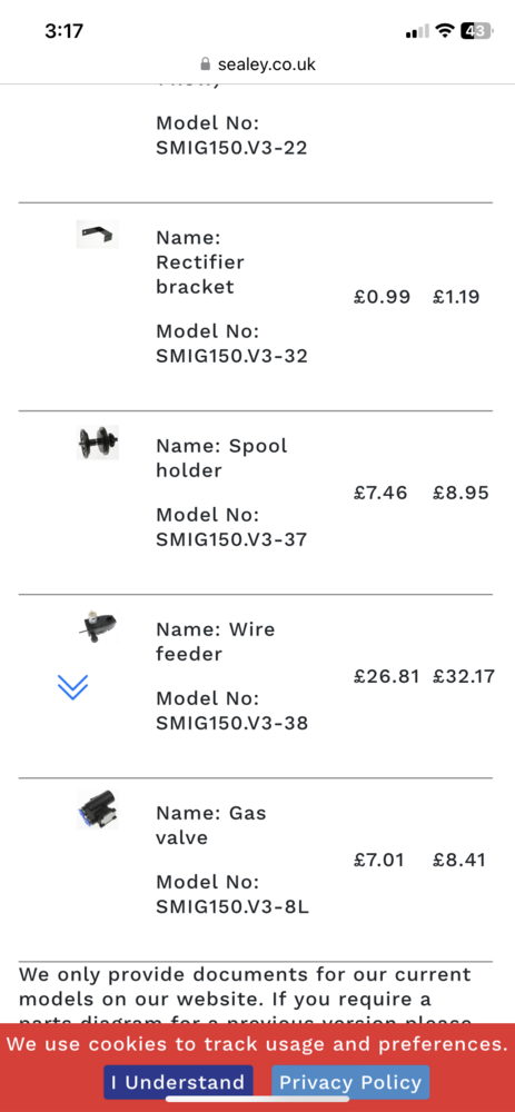

Many thanks - I'd found each of the links you've given, but missed finding the part numbers.Pictures of the spool holder here:

@eddie49 - where did you get the part numbers from please?Clarke part numbers are
EM21690714 Spool Holder
and
EM21690715 Spool Holder Retaining Ring
From the parts list on Page 33 of the Clarke manual:@eddie49 - where did you get the part numbers from please?
