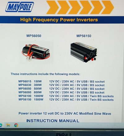

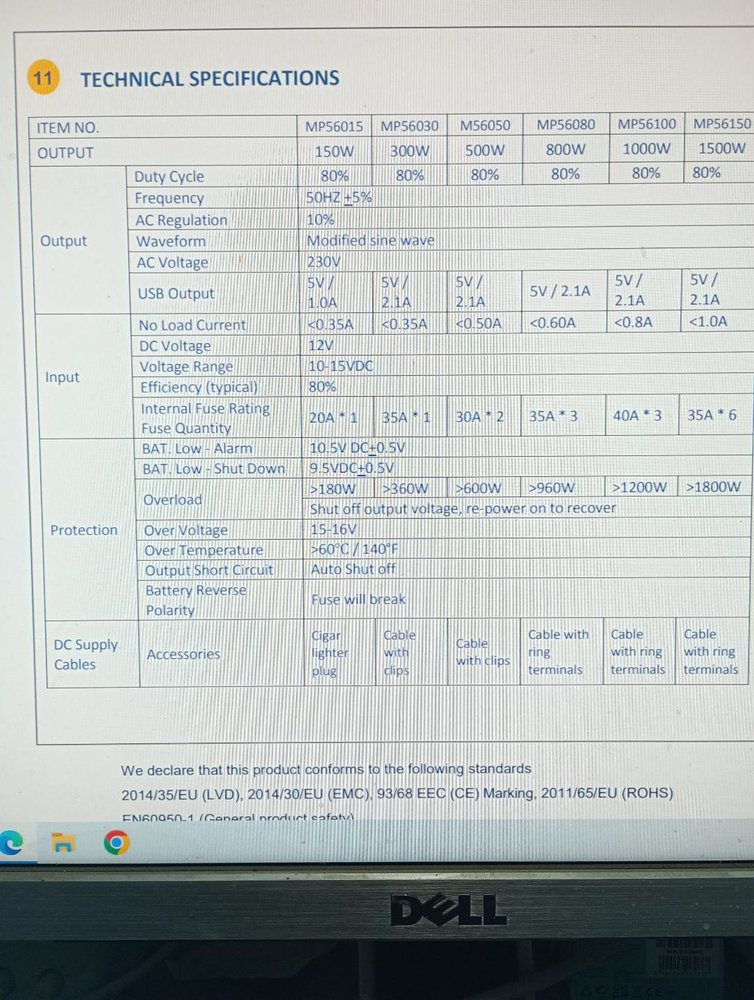

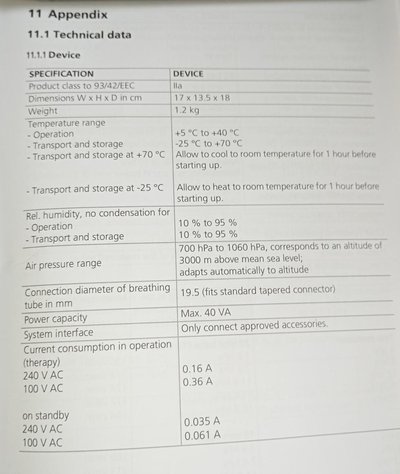

When I look at electrical things my brain fogs over! I need to take my CPAP machine away with me in my caravan on Thursday, no mains hook up at the rally, will any of these (screwfix) inverter
s run my machine for 6 or so hours non stop off my caravan battery, looking at duty cycle etc. some seem to only work for an hour at a time,
