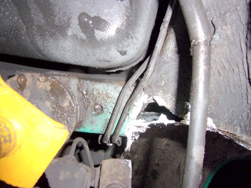

Your trouble is the boat floor is the inner sheet so really you need to weld that.
Thanks Rocketman,
Luckily, there's no holes from inside the boot,
infact there's no rust bubbles etc, looking inside the boot ...it all looks perfect (for now)

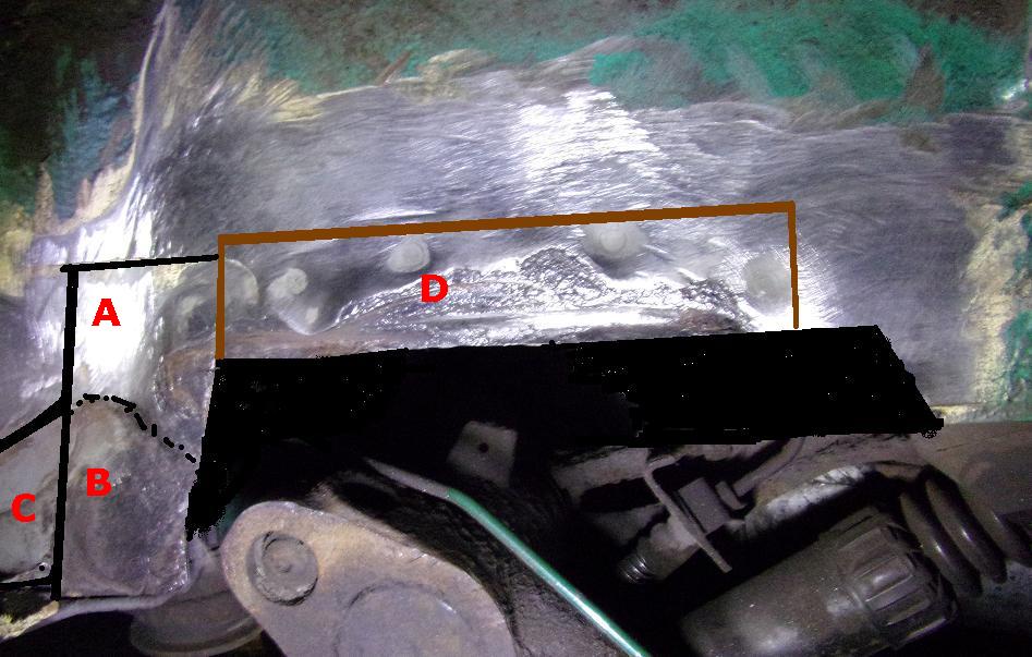

This is it to metal
Are we talking about the blue bit, (below) as I think that is the boot panel.
I was thinking of putting some individual blobs over that, joined up to make a continuous blob
..which would give it another 2mm metal thickness..
and then welding on the top,

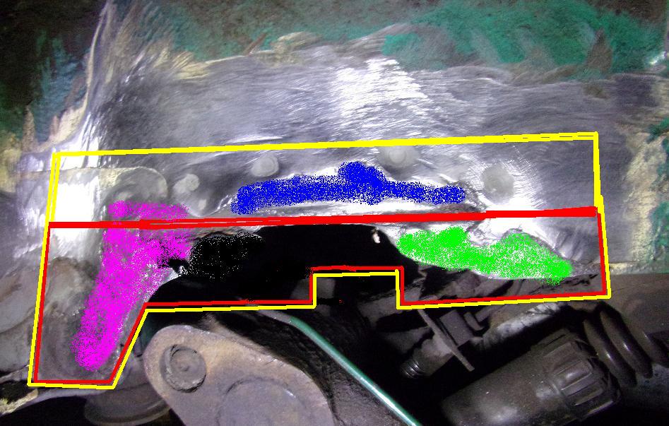

either , over those blue blobs, (ie the yellow fabrication)
or just below the blue blobs (ie the red fabrication)
I don't know if I have to do any touch ups on the green or pink side,
I'm hoping to just put the fabrication on top to cover it,
and then some roof and gutter sealant
ps the car has at most, 2 years left,in it... I'd imagine
so botchit is the name of the game, for me
