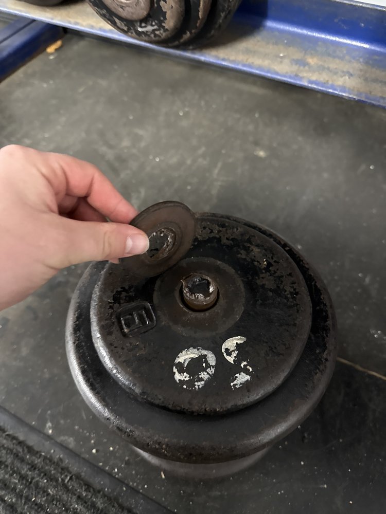

I used a flux core welder last weekend on some 6mm steel and I was surprised at how good it was.I have to weld a pro dumbbell, it’s just a washer on the end of a solid steel handle that holds 3 plates on one of the sides. I just noticed I am out of 75/25 mig gas but have 100% argon, should I use the straight argon or use flux core?

You wouldn't want it failing. Dropping a weight onto someone's foot would spoil their day.Not sure if the plates are cast or not but It’s a steel washer to the solid steel handle.
This is the picture that was sent to me. Obviously the old weld will be grinded off.
If you need it done now, and you have some flux core wire, I'd give it a go.
