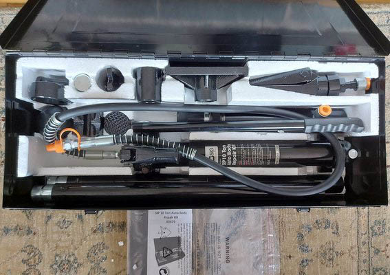

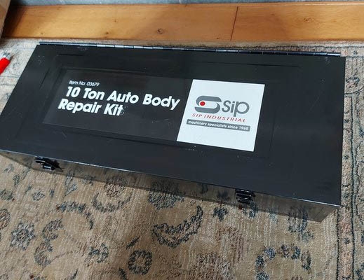

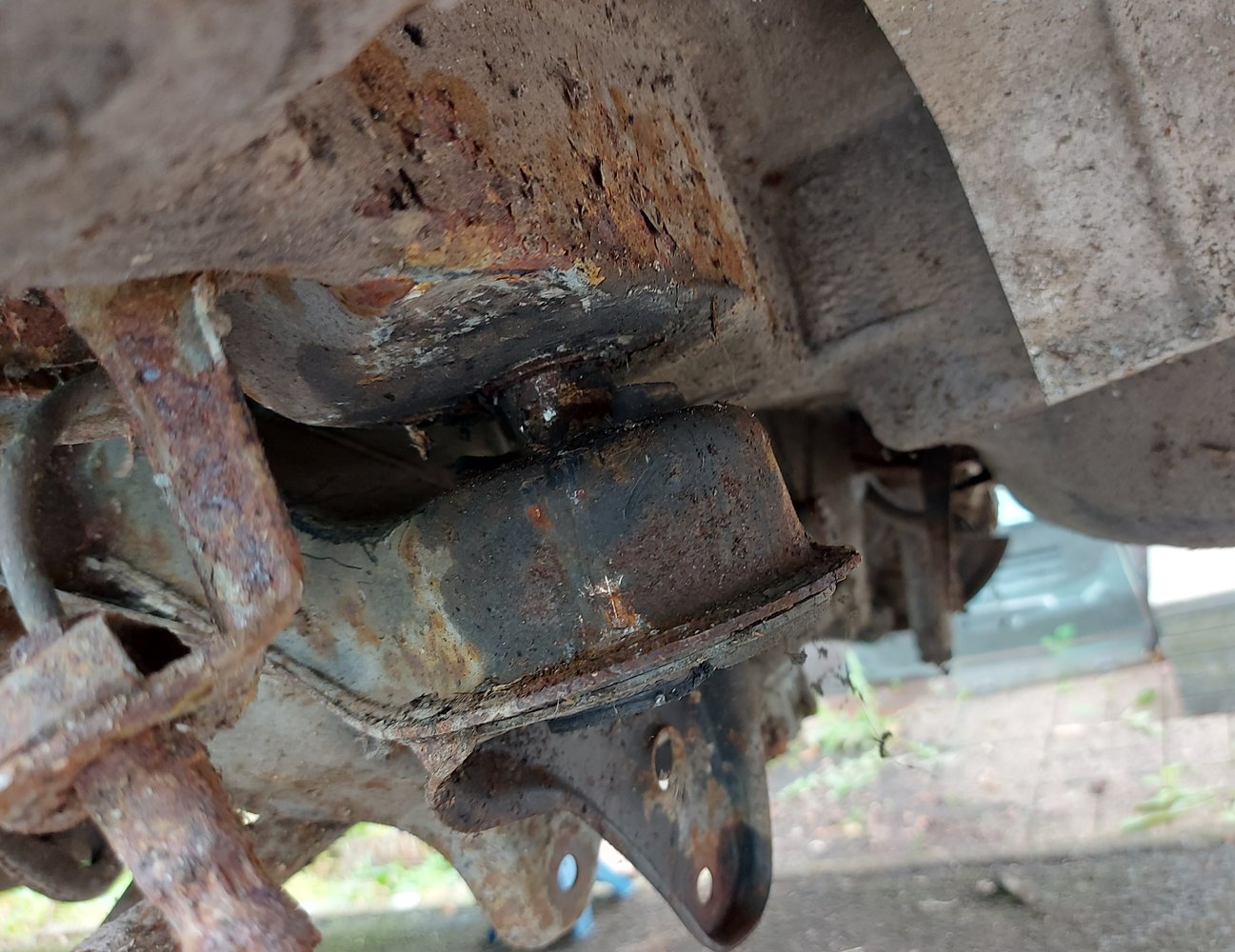

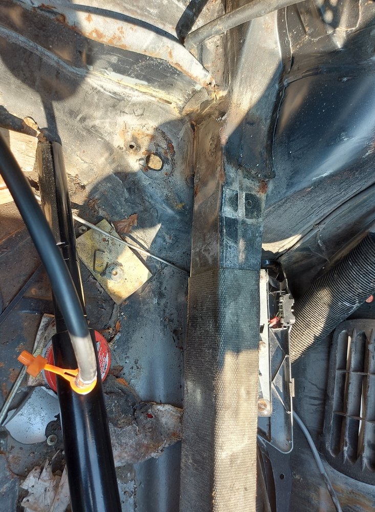

Classic 80s and 90s Mercedes have a habit of seizing the rear axle mounts. So after my current parts car's axle was stuck last night I went looking for one of these today.

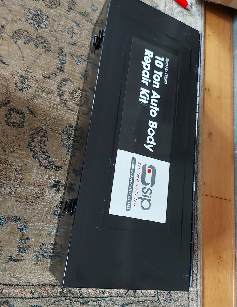

I went for a SIP one which came in a steel case. I intend to use this for DIY autobody work etc only but its one of those tools that when you need it, you really need it.
And good tools always keep their value.

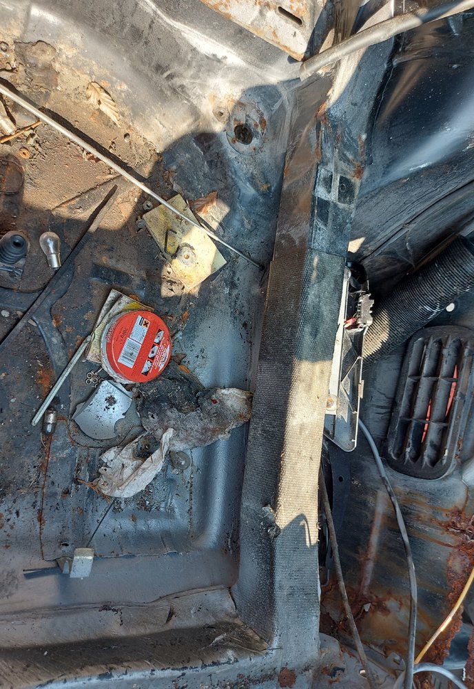

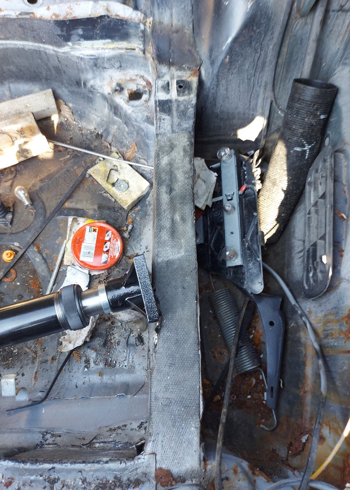

Going to test this out now.

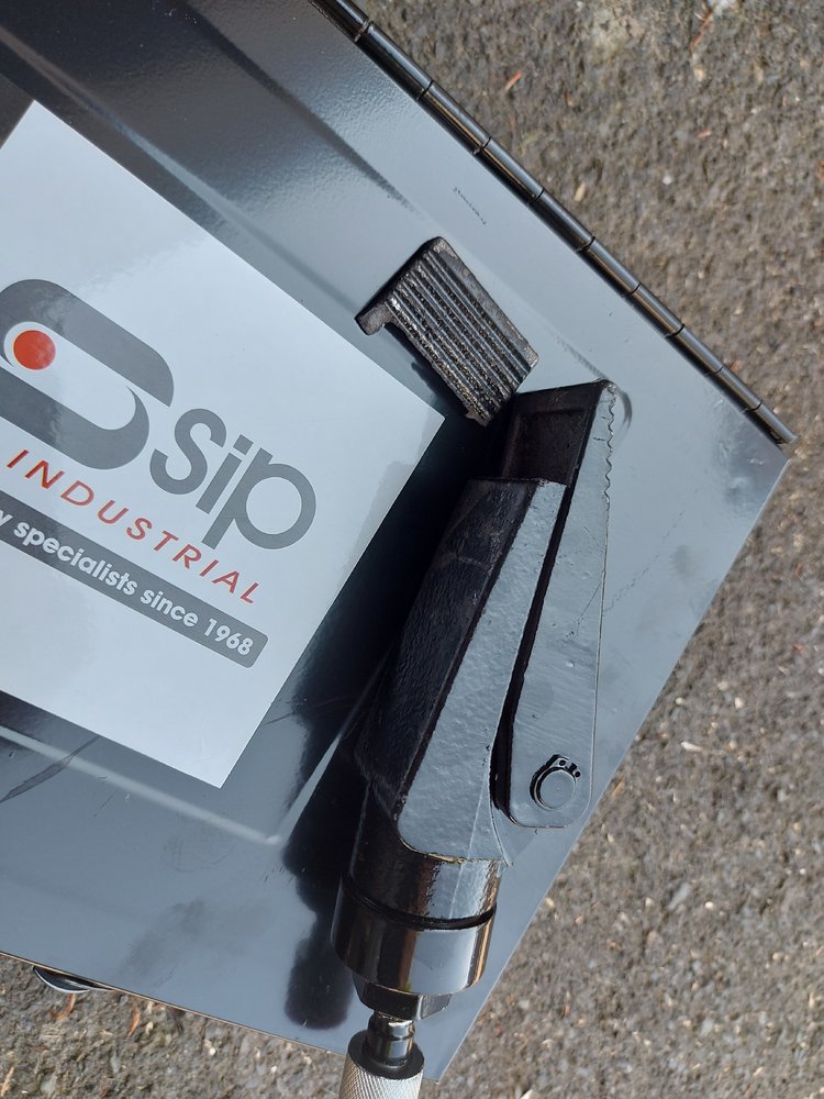

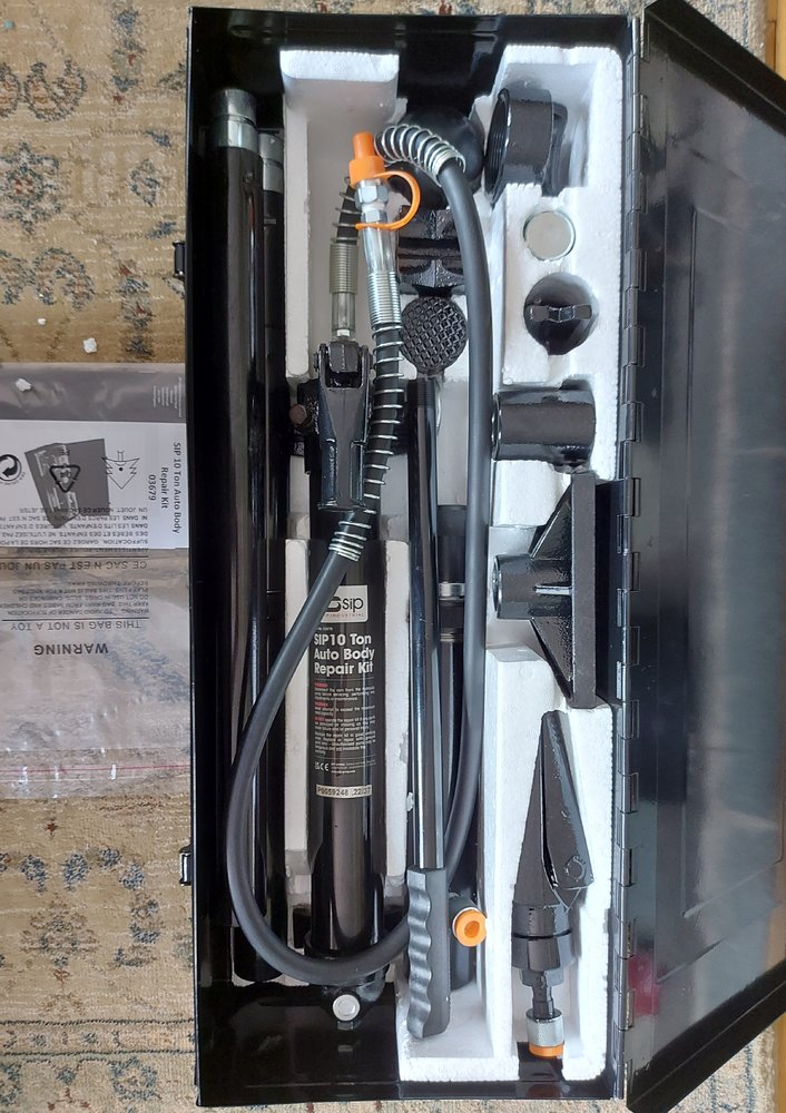

I need to use the duck bill. Which is marked as 1/2 tonne max. I guess I'll be careful to not overload it.

Saved time having to cut and air chisel the mount apart to get the sub frame off.

i have a clarke one all made by the same outfit by the looks . payed 110 quid new dunno how much they are now
