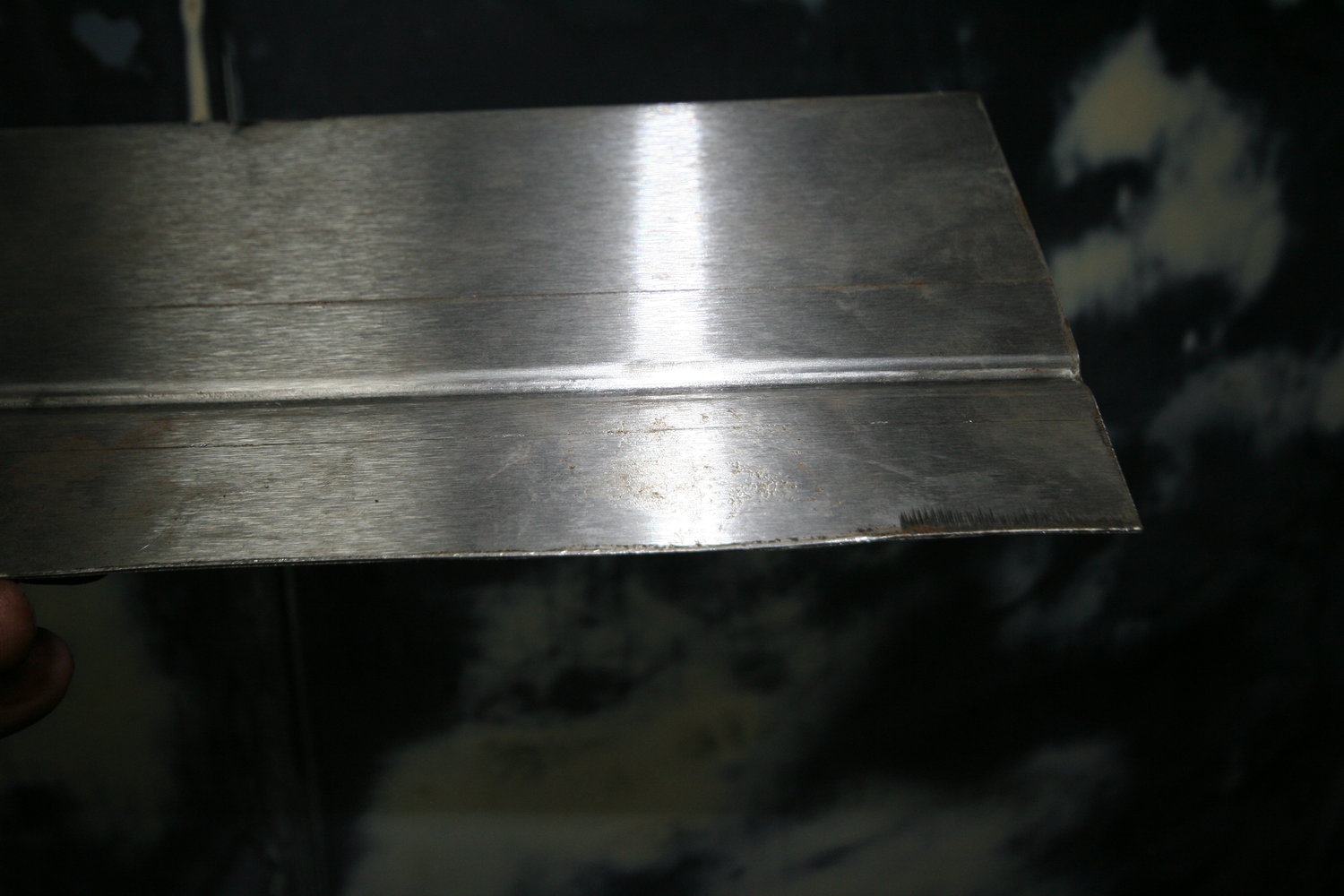

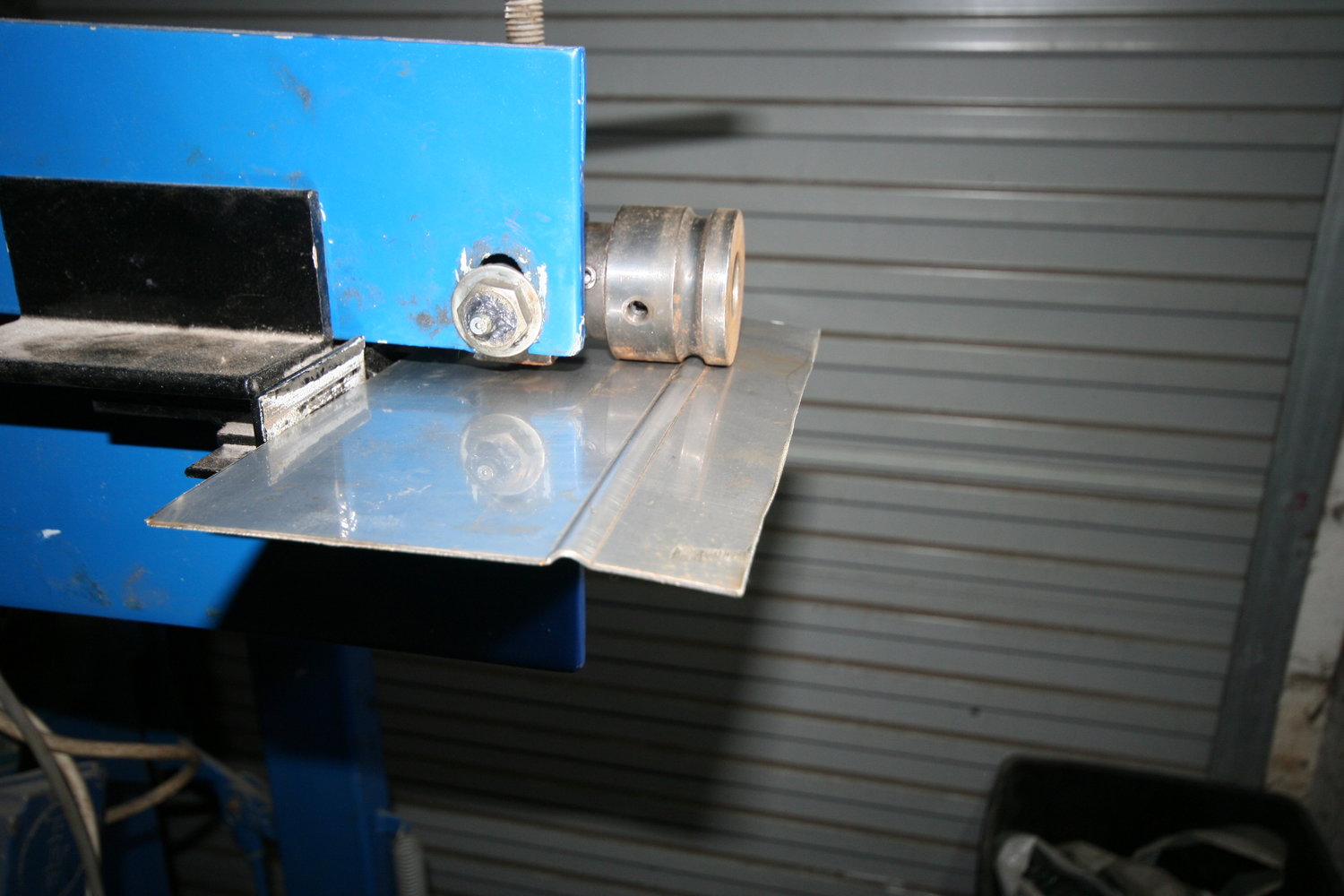

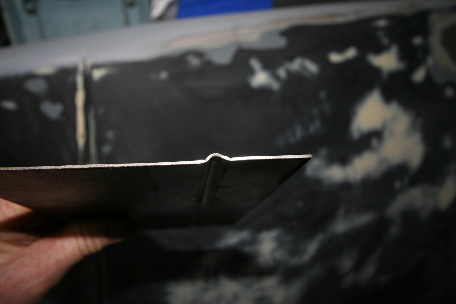

Damn dude, you did it! So much appreciation for taking the time.I had a pay with 1.2 stainless on my bead roller and it will roll it but I had to dog the machine to get it to work, took about 5 passes.
This is with 1/2 inch dies.
Forgive my ignorance but what does it mean to dog the machine?
Also, never used one of these but I am presuming correctly that 5 passes means incremental depth adjustments or same depth setting just pushed through 5 times?
