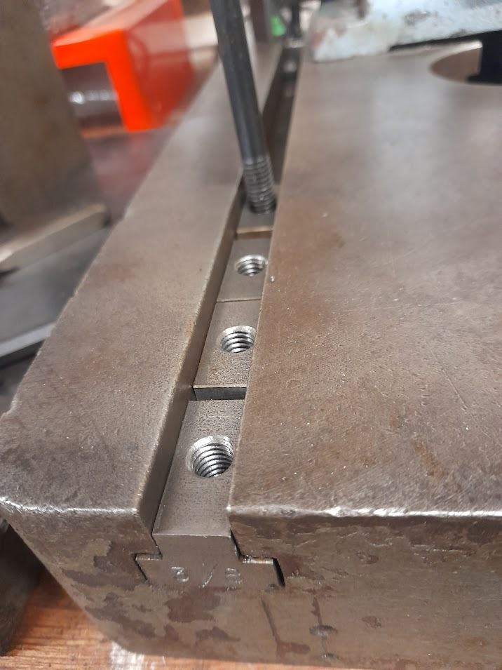

Which leads us to.ask.how much for 10 blocks posted.Next task will be to drill, tap and cut into half lengthways, making 4 t-nuts in total.
My conclusion so far is this material machines nicely.
Nice! 1 more job if you haven't already - distress the threads on the underside of each nut, so the stud cannot go right through and possibly break the tee slot.
Already done. I used a centre punch to close the thread.Nice! 1 more job if you haven't already - distress the threads on the underside of each nut, so the stud cannot go right through and possibly break the tee slot.

That's as good a way as any I think. Some on here just may not know the importance of doing it.Already done. I used a centre punch to close the thread.
Like me for example.That's as good a way as any I think. Some on here just may not know the importance of doing it.

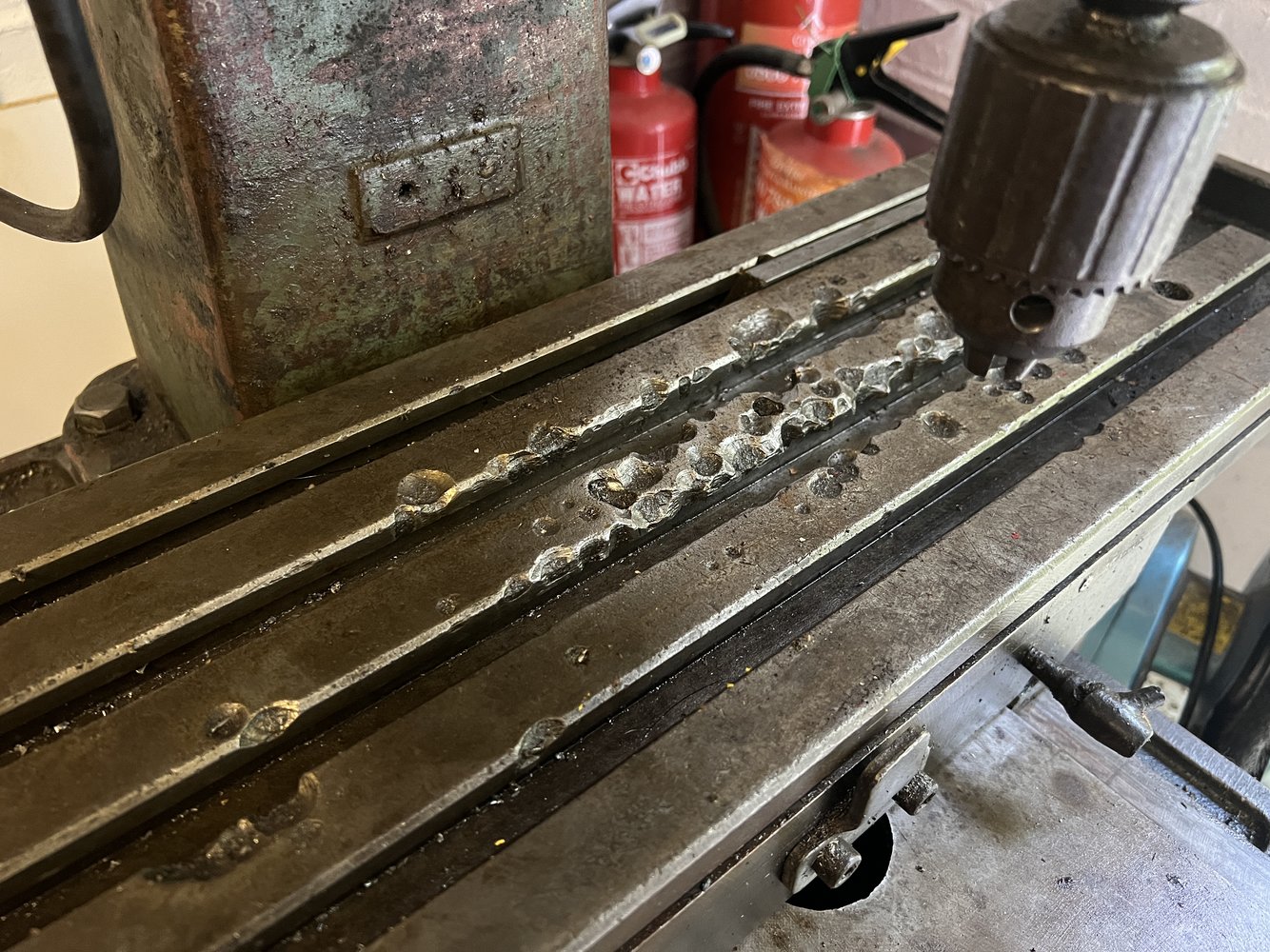

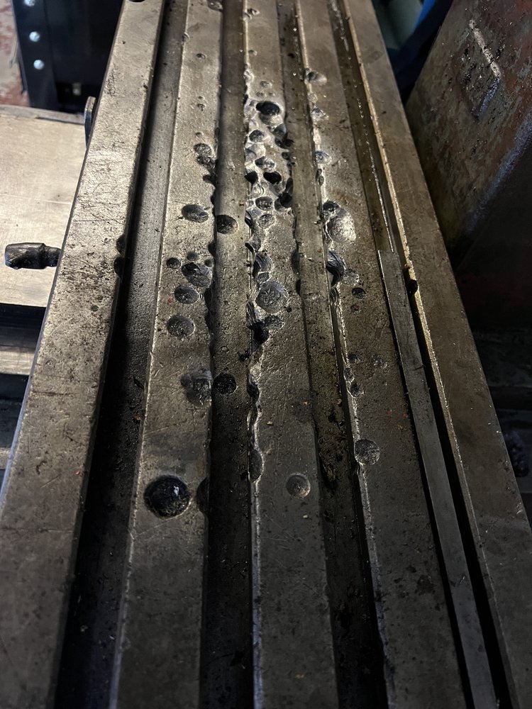

Thanks for posting such a good illustration. Many do not realise just how weak cast iron tee slots are.Ever seen a mill or a lathe cross-slide with the T-slots gaping like a speedfreak's teeth? That's the importance - if you wind the hold-down studs right through the T-nut you put the edges of the slots under pressure in the wrong way and snap 'em off - the idea is the T-slot edge is clamped between the T-nut and the work, overtightening the stud jacks the nut out of the slot and ping...
Both ugly and sad, isn't it? Have you ever seen such cruelty?
Welcome - it's damage that's easy to avoid, damn hard to repair... A whack with hammer and cold-chisel to the end of the threads as mentioned by Laurie does the job, or a spot of weld in the thread (my preference) will save the cruelty happening!Thanks for posting such a good illustration. Many do not realise just how weak cast iron tee slots are.
Laurie
…Both ugly and sad, isn't it? Have you ever seen such cruelty?
This is the result of employees not respecting the company's tools. If it were their mill they would not do, its understandable that mistake happen but that table is nothing short of abuse & I would if sacked the person responsible for it as its clearly not a one off.Unfortunately yes I have. This is my mill/drill table. I hasten to add that I’m not responsible for any of this carnage - it’s how I bought it.
So far it’s not been an issue for me as I do 99% of my milling in the vice, but I’m sure one day it will be a problem!
View attachment 422744View attachment 422745
It is still working well though. I was using it less than an hour ago!This is the result of employees not respecting the company's tools. If it were their mill they would not do, its understandable that mistake happen but that table is nothing short of abuse & I would if sacked the person responsible for it as its clearly not a one off.
