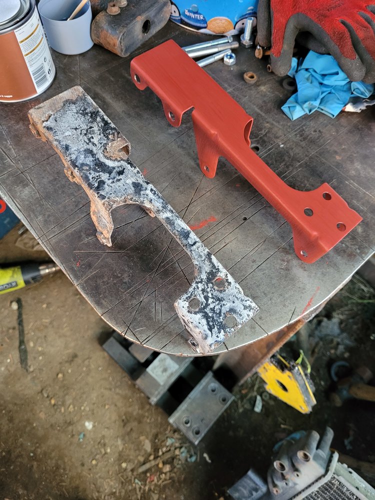

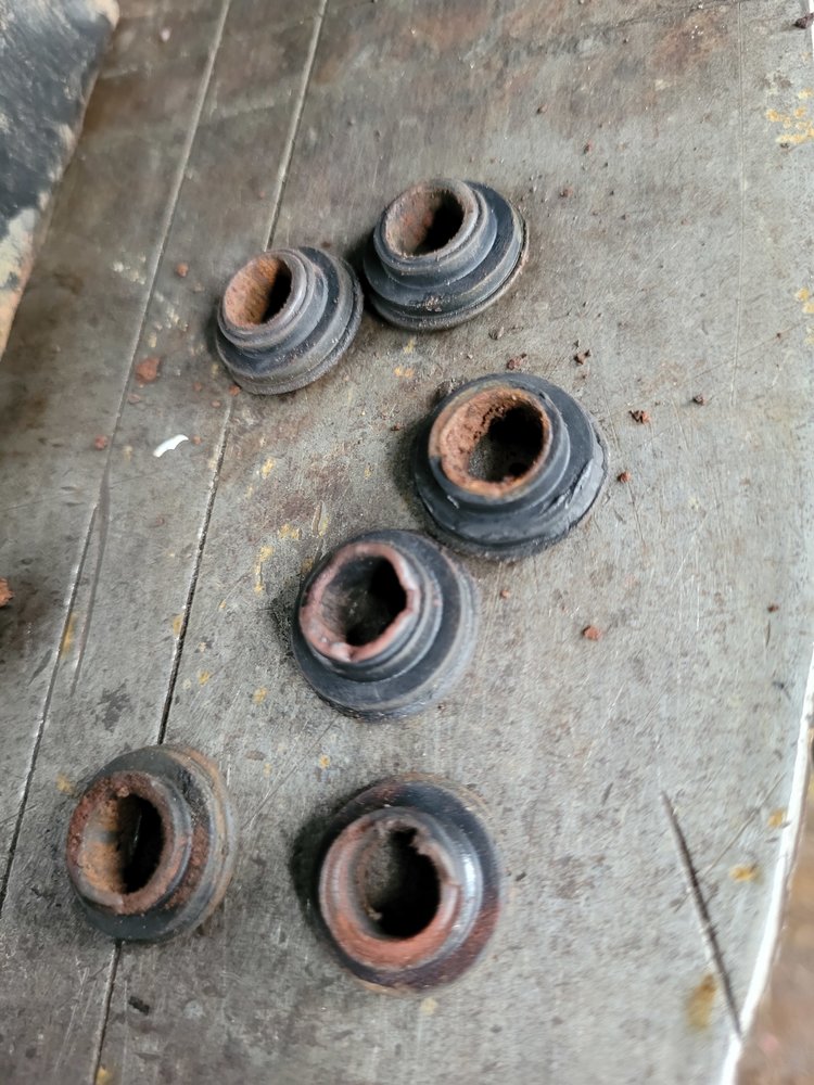

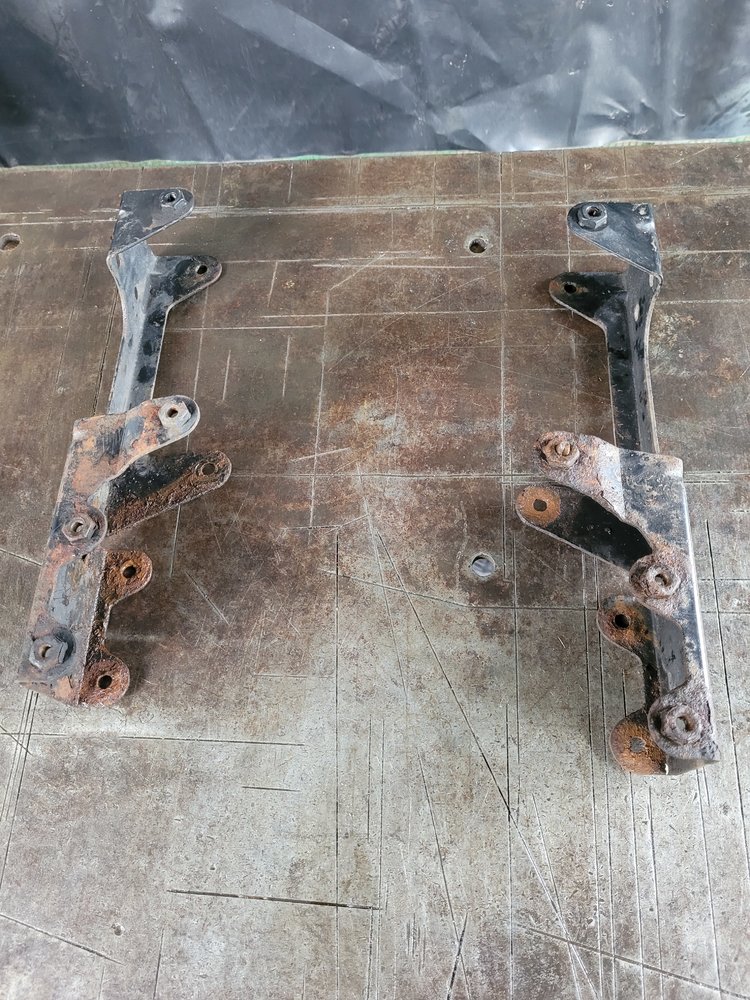

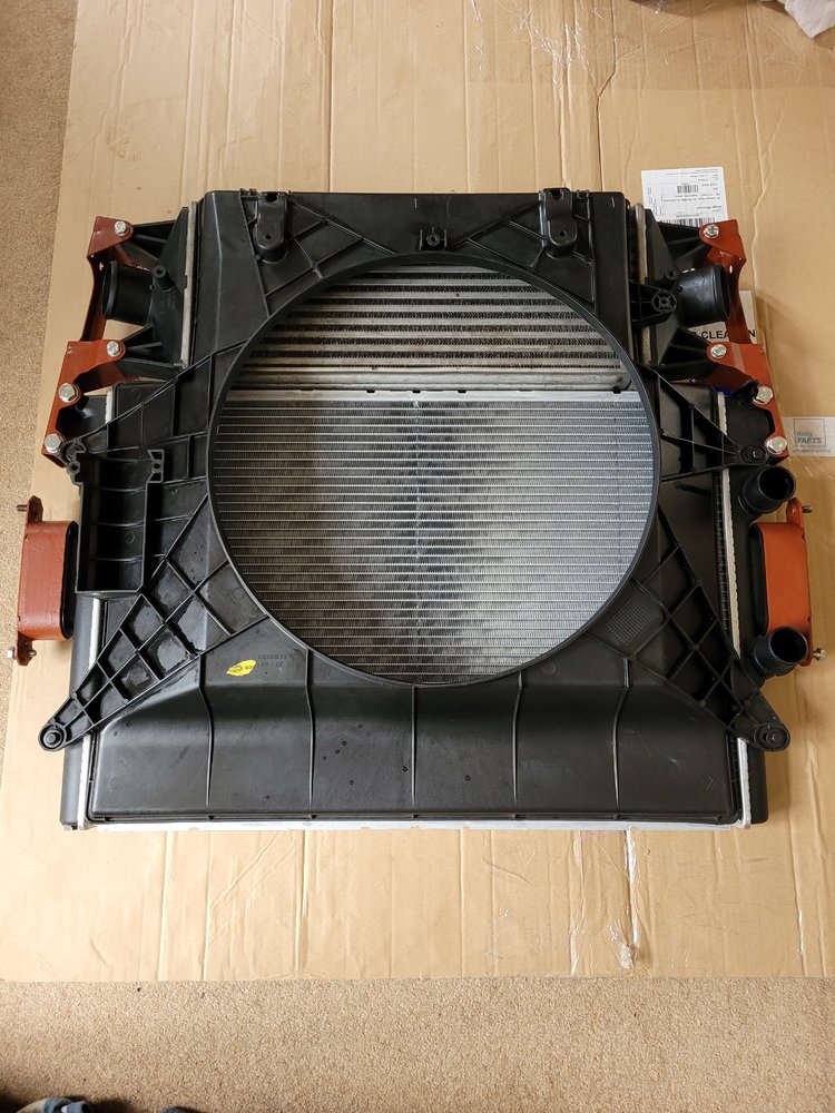

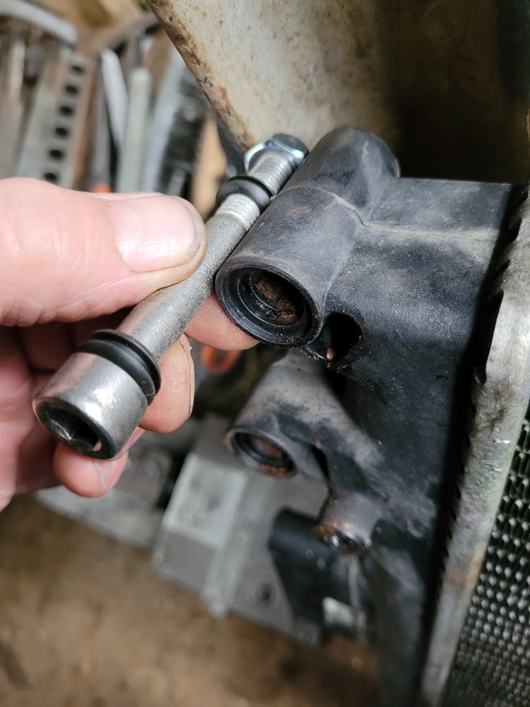

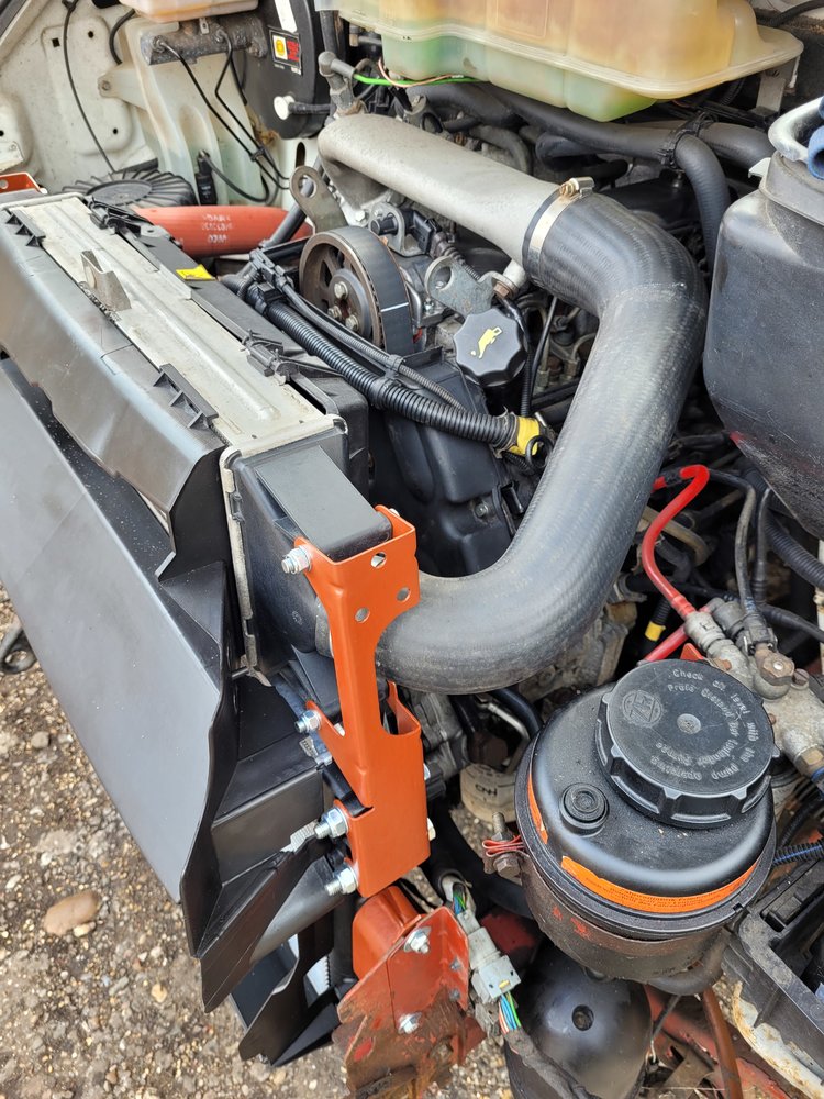

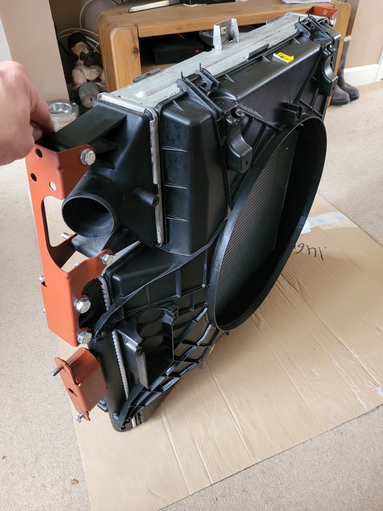

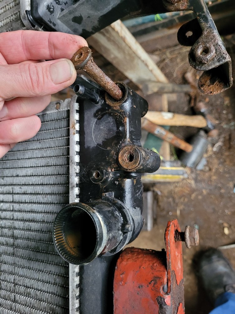

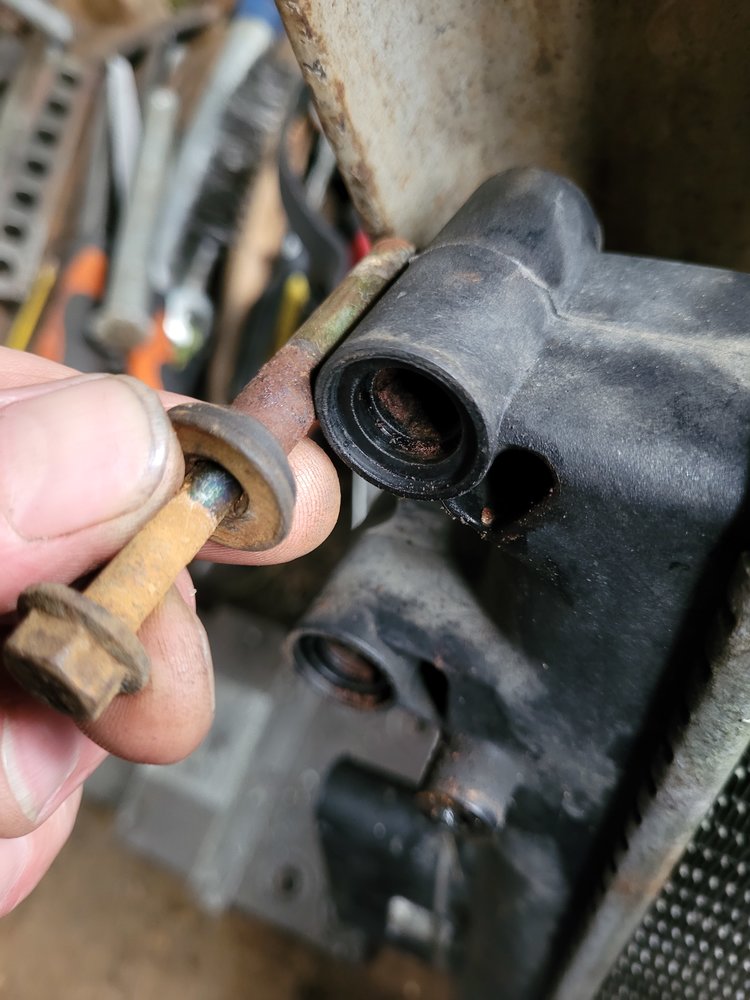

They are. Probably because the brackets are made of washing machine metal. Will make new ones later. But for now I will make some rubber spacersThey could be crush tubes?
Known over here as "Spaghetti Mobile's".....IVECO, after years using them I thought this up, Italian Van Electrical Co operation Optional

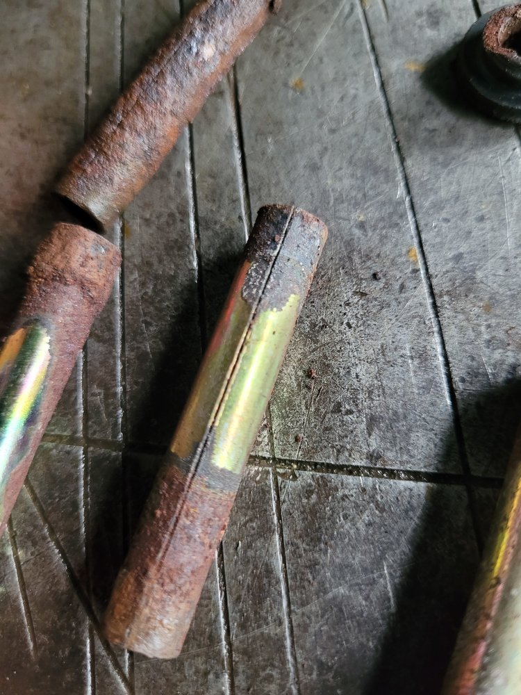

I'd suggest they are simply spacers - you tighten the bolt that passes through them, so the bolt is tight and doesn't come undone - the tubes ensure there is room for the rubber isolators to actually isolate, as they look to locate on the diameter, keeping the plastic clear of the tube, the rubber flange allowing a bit of axial movement - stop radiator type bits breaking as things flex, warm up etc.They are. Probably because the brackets are made of washing machine metal. Will make new ones later. But for now I will make some rubber spacers

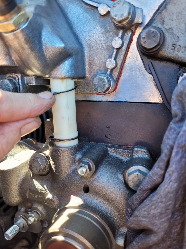

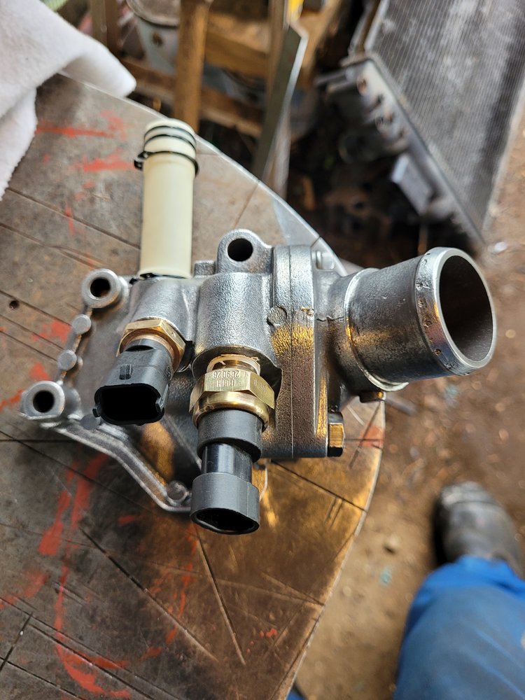

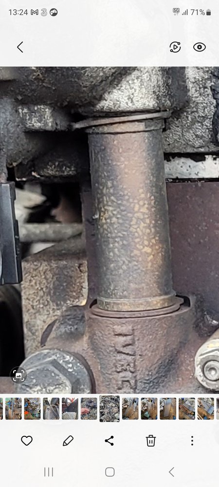

This is the old one. As you can see. My new tube has inserted past its retaining clip. Meaning I am not sure if it's insert in the water pump properlyI'd suggest they are simply spacers - you tighten the bolt that passes through them, so the bolt is tight and doesn't come undone - the tubes ensure there is room for the rubber isolators to actually isolate, as they look to locate on the diameter, keeping the plastic clear of the tube, the rubber flange allowing a bit of axial movement - stop radiator type bits breaking as things flex, warm up etc.

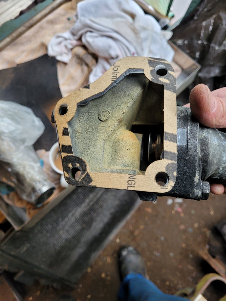

Water pump and stat housing on. The plastic tube has just slightly gone past it clip. I really do not want to take that lot off again. Am hoping it's sealed.
Have sorted it now. Took it all over and reset the clips and the tubeStrange that both tubes appear too long, has the head had a savage skim in a past life?
If all of the thermostat housing and waterpump bolts were slackened off would there be enough jiggle room on the bolts/studs in the holes to gain a tad of space?
Bob
Is that the one with a temp/pressure switch that screws into the rad?
Thankfully no. That temp/pressure is located on the thermostat housingIs that the one with a temp/pressure switch that screws into the rad?
The threads are easy to cross when refitting.
Start to fit it, then add a blob of silicon grease.
The plastic or alloy one?Thankfully no. That temp/pressure is located on the thermostat housing
