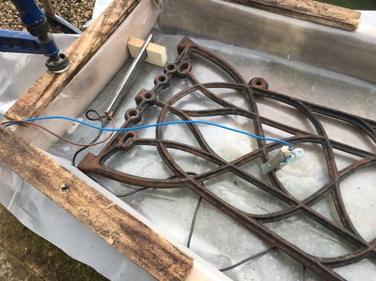

made a set up over the weekend and it's not working, what's the potential issue ?
Both anodes about 200 mm long 5x25 flat bar polished shiney, contact point on job polished shiney, power source is a ring battery charger, first tried at low and nothing, then tried at medium setting and nothing, hen tried at full whack which is used for jump starting and still nothing.
Solution is Made of Asda washing soda crystals made up to about half a bag to a little over one bucket of water.
There is no fizzing and the water has remained crystal clear with rust still on the job
