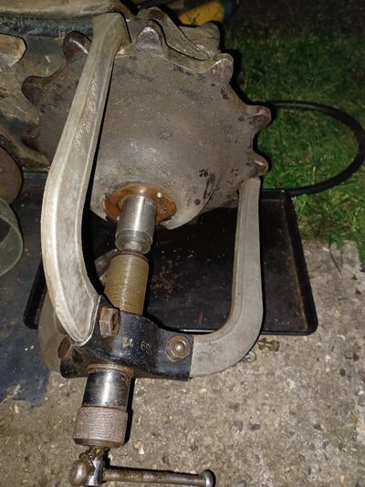

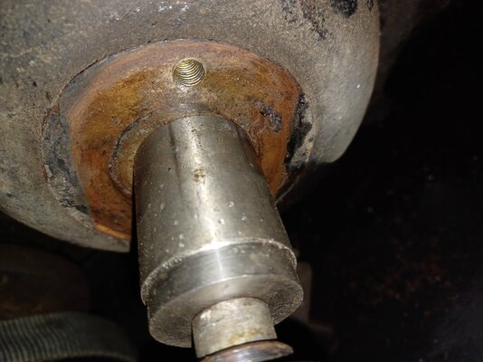

Decided the weekend to do a bit of undercarriage maintenance on the mini digger tracks off the main idler was sloppy thats another story but i have a drip from the left track motor output. Looks like its a parallel shaft at least a 1 1/2 diameter with a keyway . Damn thing wont budge got a hydraulic puller on it nothing , not sure what they are rated at but im tempted to put a short 10ton ram in its place as I have one for my porta power .
Looks in photos worse than it is but its been there happily for nearly 30 years so i expected a fight , whats the best course of action now ?
Im a bit worried to put too much heat into it as if i fudge the seal and still cant get it off then im really screwed

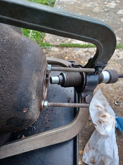

I can put a 10ton ram in that puller frame but not 100% it will take it
Last resort i can FAB up a puller that will be strong enough but its a lot of work .

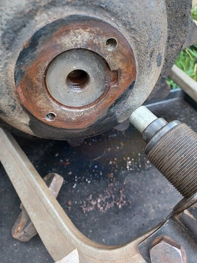

there are 2 13mm tapped holes but i doubt they would exert enough pressure before shearing
unfortunately the sprocket traps the motor in the track frame so i cant even get it out to put in the big press
any ideas welcome
