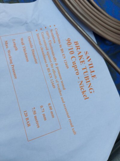

Ill take it to RT autoparts and see what they say RE new hose. I dont know if the male fitting in my photos is standard. I guess if they dont have that they could use other fittings to create a new hose section if I bring them the new kunifer pipe sections pre bent and the new banjo fittings brazed on.
Before brazing anything I would bolt on the banjos and dry assemble the whole thing with the kunifer pre bent and your rubber hose tightened up.
With everything clipped in place make clear alignment marks between the pipe and the fittings so that you can braze it in the correct orientation.

Brazing is the way to go.....just a thought about kunifer if your still thinking of that...the wall thickness is going to limit the max pressure it can handle. There's no doubt it will "work" everything else being equal in normal operation...... just remember that the system is designed at higher max pressure than the kunifer will take......the alternative?....trying to hand bend steel pipe in complicated runs is a pita....
Practically, I'd probably do the same as you though![]()
I assume, an 8 mm OD pipe would be 0,008 m.While I appreciate your concern on gut feel, it feels a touch sensationalist in the context of some maths (also 200 bar is knocking on 3000psi).
Google reckons silver solder will develop somewhere between 70 and 250MPa in shear depending on silver content. Feels about right, so assume worst case, but consider both. Assuming an 8mm OD pipe and some decent high silver solder, that means you need a joint length somewhere between 1.6mm and 5.7mm. That's to react 200bar, which exceeds the 190bar PRV set pressure, not the 50bar normal operating pressure.
I'd be quite confident of making a fully wetted 8-10mm long silver solder joint, but if you're concerned, make some test pieces and section them to make sure you can do it repeatably.
Standard disclaimer - this is merely opinion, not advice.
Cunningham's law in action!I assume, an 8 mm OD pipe would be 0,008 m.
That just pop into my eyes, haven't checked or calced the other columns.
I'd probably try Kunifer as well, but design pressure for even 1mm thickness 8mm steel pipe is 333bar-The kunifer tubing I have is rated for 120 bar. I believe it will be fine and im using it.
If it bursts then Ill know it was not fine
