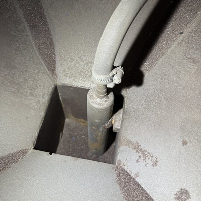

Would anyone be able to guide me with my small Guyson blaster?
Obviously it was well used when I got it. I have changed every part of the gun including new witches hat and 6.4mm tungsten. I have also changed all the hoses, new pressure regulator and anything else that could be considered consumable / service items.
I’m running 80/100 aluminium oxide.
The issue issues I have is based around the siphon / pickup or lack of action therein.
It did initially pull some media through and I could blast but it was so unreliable that I changed all the hoses as they were pretty stiff. This made no difference.
My model has an air inlet regulator as part of the siphon tube which is adjustable to regulate the flow of media, this projects through the front of the media sump.
I’ve lost quite a lot of media because it blew out of the air inlet / mixture vent.
I’m currently using a 105cfm compressor through 1/4” PCL fittings varying the pressure up and down to see if I can get a tune out of it… I can’t…!
It has stopped blowing the media out of the front now as I lowered the amount of media in the sump to below the air inlet vent. Still nothing.
My question is, what is the best / most satisfying way to burn / blow up this machine?
Pics of the siphon tube coming shortly.
