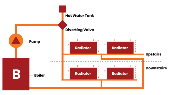

Our house central heating seems to have a real mish mash of microbore in places and 15 and 22mm pipework in others. Most of it works ok to be honest so we have left it alone, but our extension has a set of five rads that work poorly. To try to fix this, we fitted a JG Speedfit underfloor heating manifold with a separate pump to the rest of the system. The flow branches into two before the pumps and one of these , eeds the pump to the manifold. The return from the manifold feeds into the system return. Each rad as its own flow and return to the manifold. Two rads have good flow - these have runs of about 3m and 5m of 10mm pipe to and from the rads. Of the other three, they are 7.5m, 12m and 14m runs of pipe from the manifold. Curiously, the 12m distant rad heats up fairly well. The 7.5m one is ok but not great, and the 14m one rarely gets very hot. If I close the returns on four, whichever is left open heats up nicely so I know the pipework is all clear (we flushed it, and the rads when we fitted the manifold anyway).

The pump is a new Grundfos UPS3 15-50/65 150. Even set on its highest flow rate, water doesnt circulate through these five rads well. Is there a more suitable pump for microbore and manifolds we should have used? The pump on the rest of the house is the same type and that flows just fine and serves 12 rads via a much more convoluted system.
