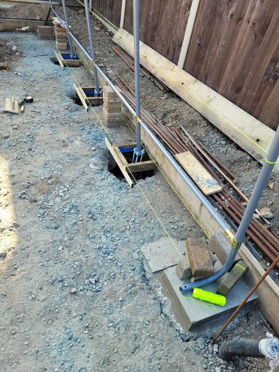

Brought one of these clarke portable garages 12x16 ft..this will go up the top of the garden to house some restoration projects. I put mine on 1ft deep concrete pads and bolted it down via 200mm long threaded m12 bars with plates on the bottom.. assembly is straightforward enough. They are not designed to be the most precise building but I got mine to half inch square.. I will put a clear liner over the top before I put the cover on. I have a large dehumidifier to combat the condensation... floor and lighting I will deal with later...
