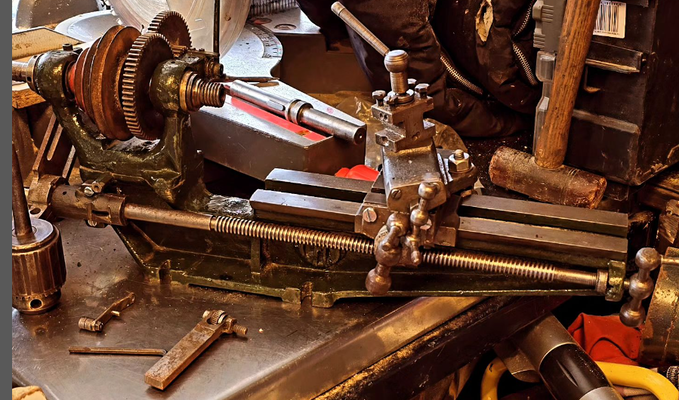

Doing up an old lathe, looks at lot like a "Lineker & Winfield", also acquired some ER32 collets from the local auction, and a tray of assorted offcuts including some bits of ali plate.
Spindle nose is 3/4 UNC, 3/4UNF on the rear. Every thing else is BSF or BA.
Got an ER32 backplate from RDG tools, but it's meant to be mounted on a rotary table so it has no real register on the back. Going to be a bit of a laugh making it run reasonably true.
