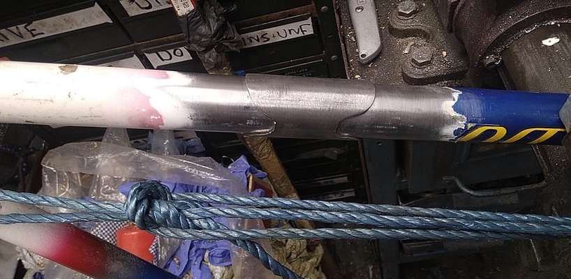

I have a steel frame to repair it is 735 steel.
Clean break in the nain tube .
I have cut it and sleeved it with some seamless chrome alloy tube .
This a really good sliding fit.
I was going to TIG braze it .
Would silver solder be a better option .
I think the rest of the frame has been silver soldered.
I don't want to get it up to welding temp .
