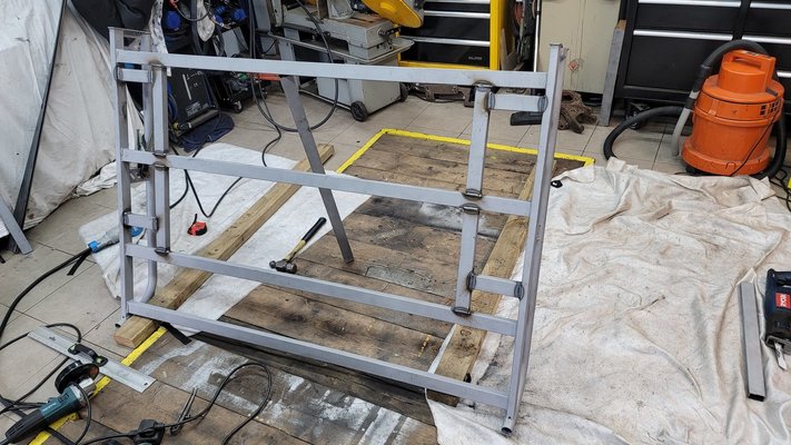

Bet you are getting really quick at doing those!Made 60 strawberry trollies 7 years ago,now due to regular punctures,farmers changing to solid tyres,so I’m putting suspension on each corner and widening them as he’s changed tray suppliers.View attachment 398626View attachment 398627View attachment 398629
