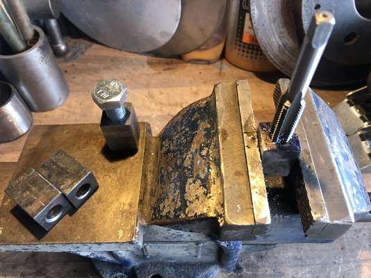

so ive been making a frame with wheels to put this metal stock on. so i can move it out the way and move it about if needed.
using 25x25 box, ive made two U shapes and a beam between them.
got some 100mm wheels and looked for some tube ends,
the shallow ones i feel wouldn't be good enough, too short.
the long ones are way to pricey.
so i found some 30x20 bar in that pile of metal.
so i cut off four bits at 20mm long.
took the corners off on a sander and drilled them out to 10.3mm
to M12 thread them.

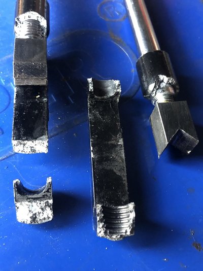

got one done, doing the 2nd one and then the tap holder decided to fall apart in my hands, stopping me in my tracks..

anyone know of a place that does good tap holders. (M4 - M12)
ones that can do the job and not made of cheese.
