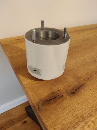

I am sure it is 10 TPIChester 626 riser block complete.
Two coats of primer and two top coat.
Brought into the house to harden off for a couple of days.
I am going to try and make a longer leadscrew for the knee riser to compensate for the extra height. Does anyone know what acme thread it is? @doubleboost ?
Yeah thanks John, it measures 24mm dia. And 10 tpi. Not sure if Acme or trapezoidal though...I am sure it is 10 TPI
I did mine ACME but bushed the nut as well .Yeah thanks John, it measures 24mm dia. And 10 tpi. Not sure if Acme or trapezoidal though...
