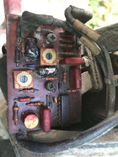

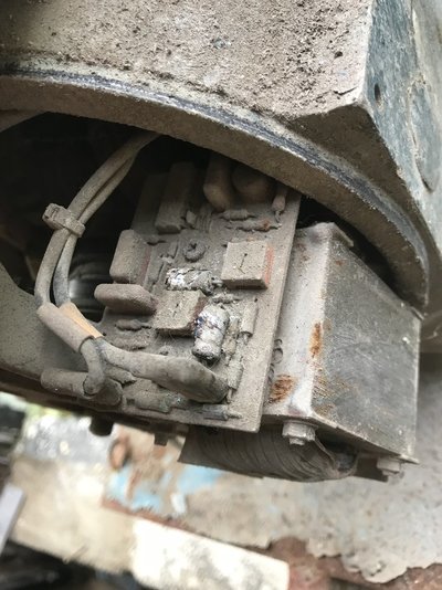

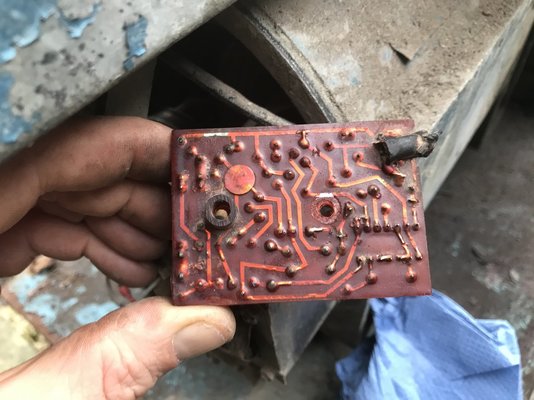

Hello all. I found the forum from doing google searches. I’ve a workshop in Lisburn. I’m an amateur engineer. Welders, oxy, lathe. Play with racing bikes mostly. So I’ve wanted a diesel genny incase of Armageddon etc and got a wee single lister. She was working fine and then one day the voltage dropped off. Checked it all out over. Few wee things were obvious. Give it a service, cleaned the rings, freed up the brush arms and increased the engine speed and voltage came up nicely. Then the next day I started it it was at 300v! I turned engine speed down and it was at 220 then 200 then 100. Now even with her banging away at 3600rpm she’s only making 100v. There is an old circuit board with a transformer beside it that I assume is voltage regulaton. On this board there are two components that I believe are capacitors which have clearly been damaged. Can anyone help me work out if I can repair this board or if I can replace it with an avr? Maybe this isn’t even the problem? I’m unfortunately a half wit with electronics but I’ve no choice but to have a go. I’ve no money to replace it and Santa robs me blind rather than brings me goodies so it’s up to me.
