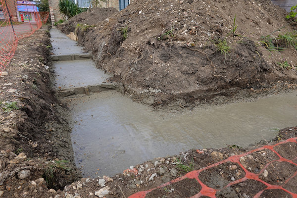

I've got the foundations in for the garden wall. It's a 20m run with 2 steps. Already figured out I can't use a string level for heights as it droops half an inch in the middle and doesn't leave room for bricks.
I can prop up the string line on a brick with spacers using the level every 3m. That'll get me so far. But I've got piers and at some point they will catch my string line and move it sideways.
What do you normally do? Tempted to stick a few bricks in at the right height along the way before putting the piers in. I've got a brick gauge worked out so it should be possible to figure out where the end of the wall should be. Also tempted to put them in using a very weak mix so I can remove the bricks and clean them up and use them again.
