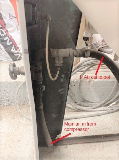

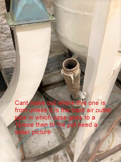

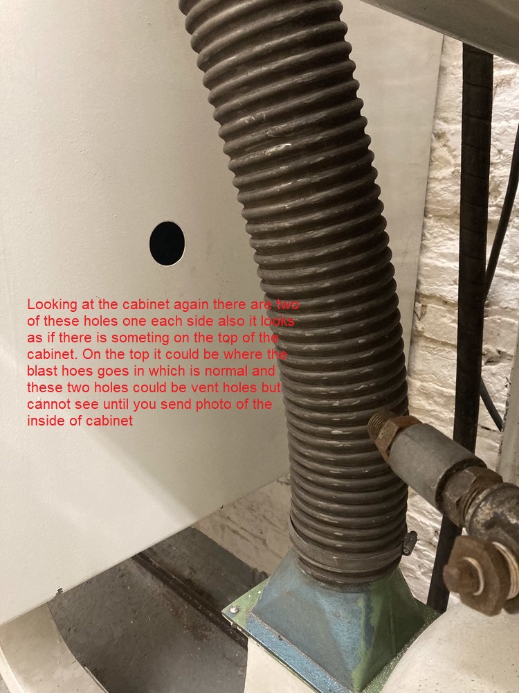

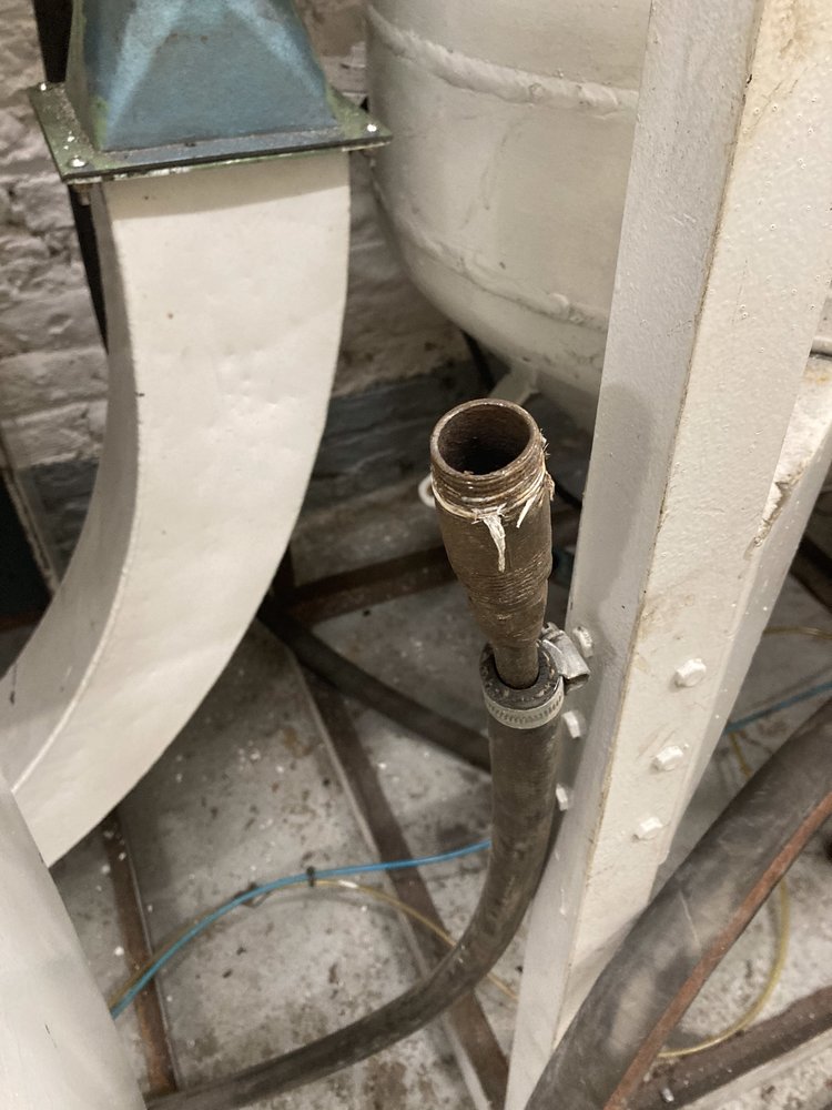

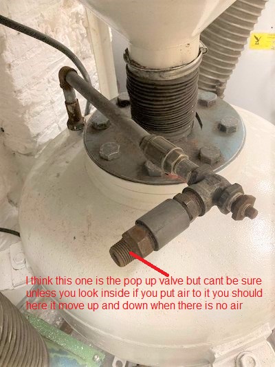

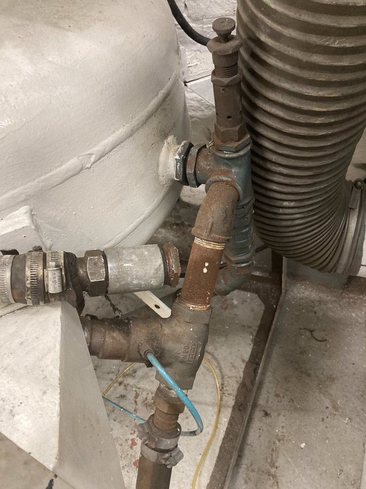

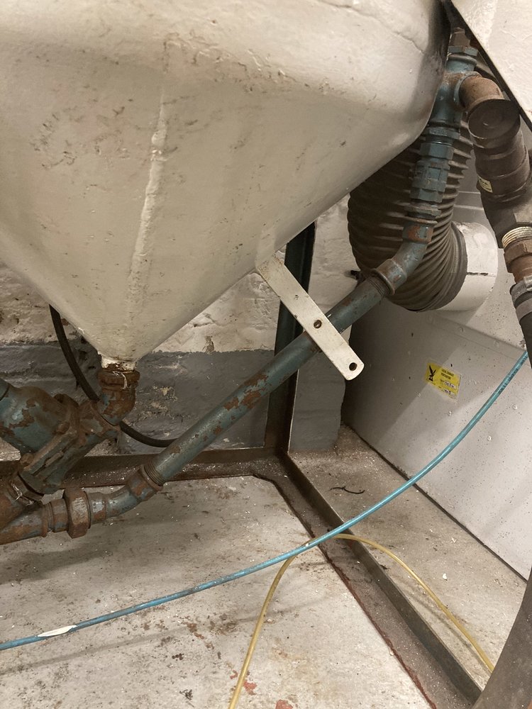

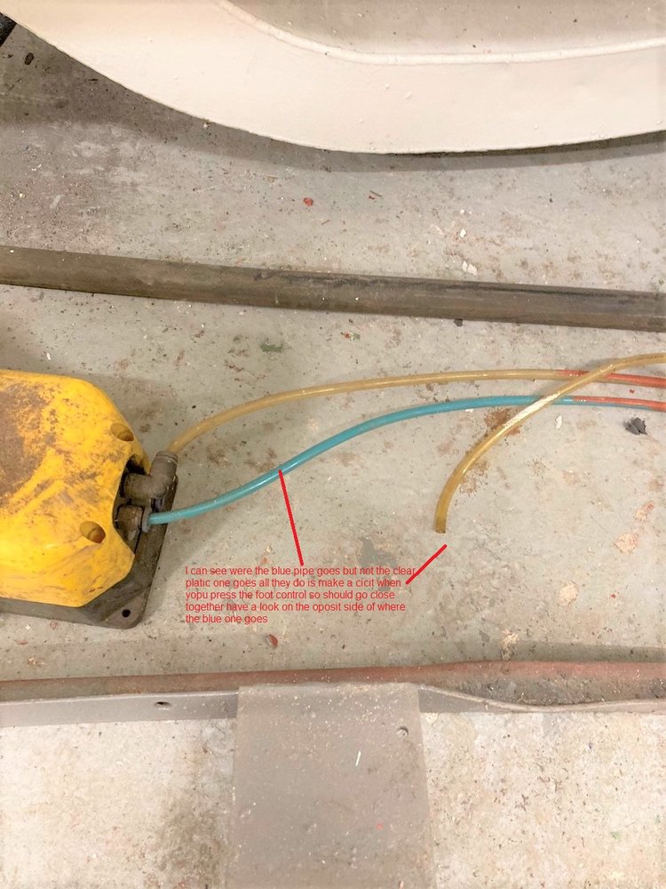

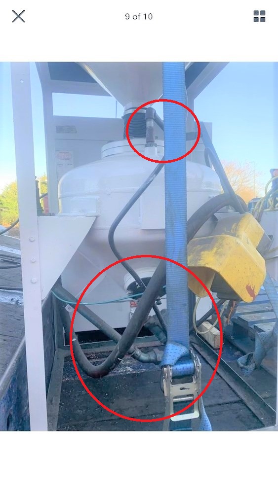

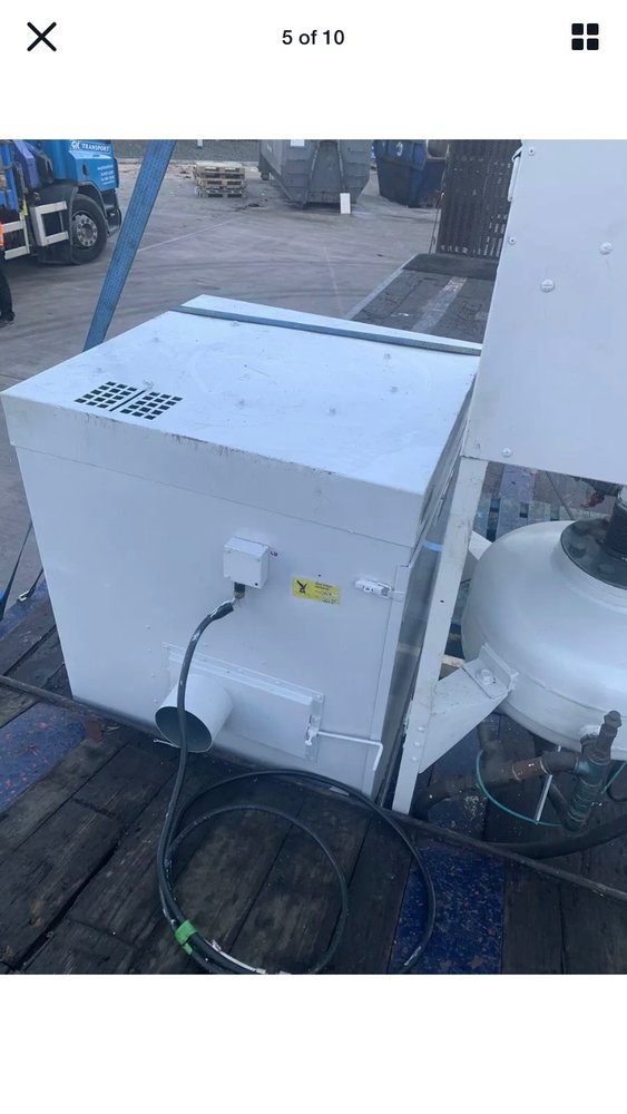

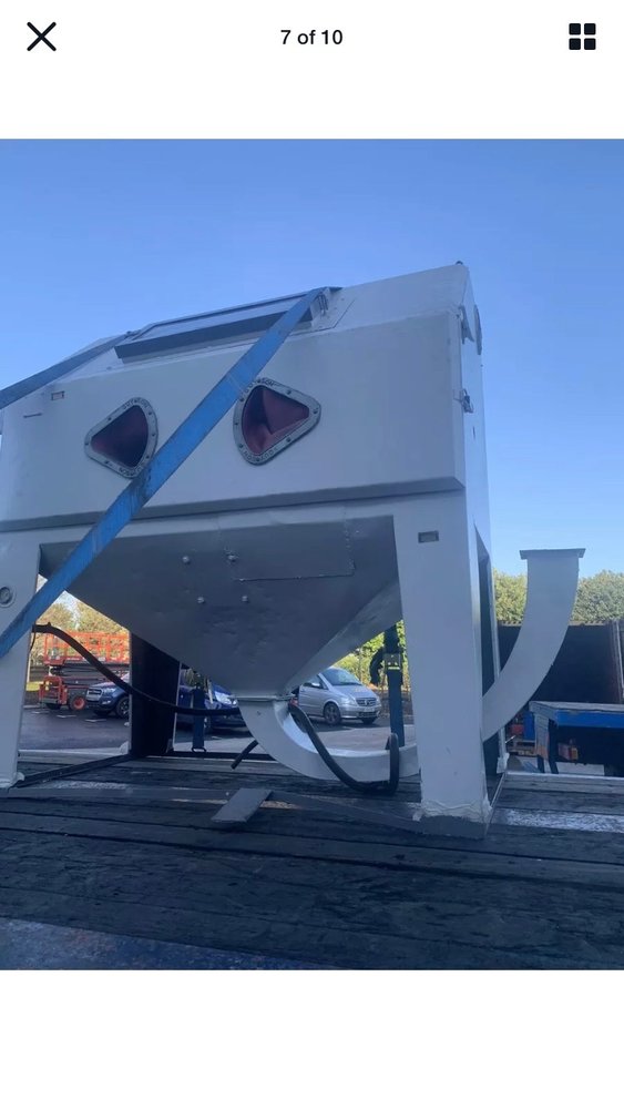

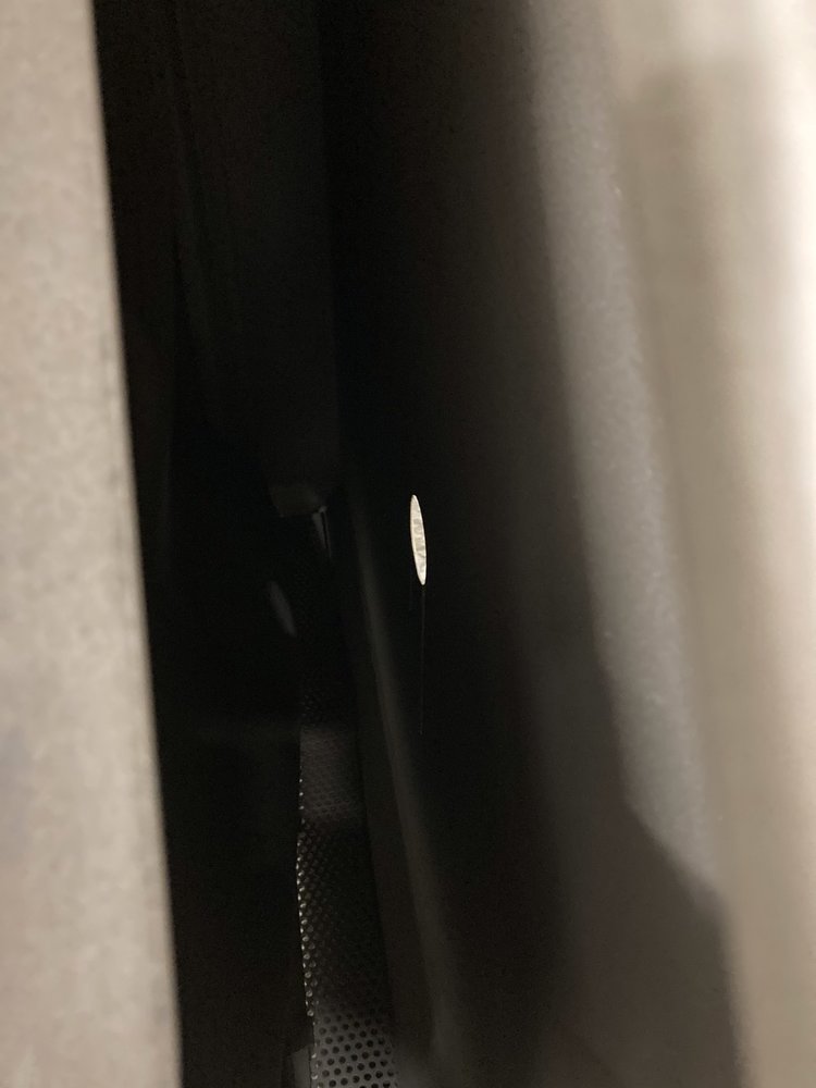

Hi,
I recently bought a bit Guyson blast cabinet which comes with a cyclone and pressure pot and a dust extractor too.
I’ve wired in the cyclone and extractor and hooked up the extraction hoses.
I’m having trouble working out where the air hoses go and how I should plumb it into my air supply.

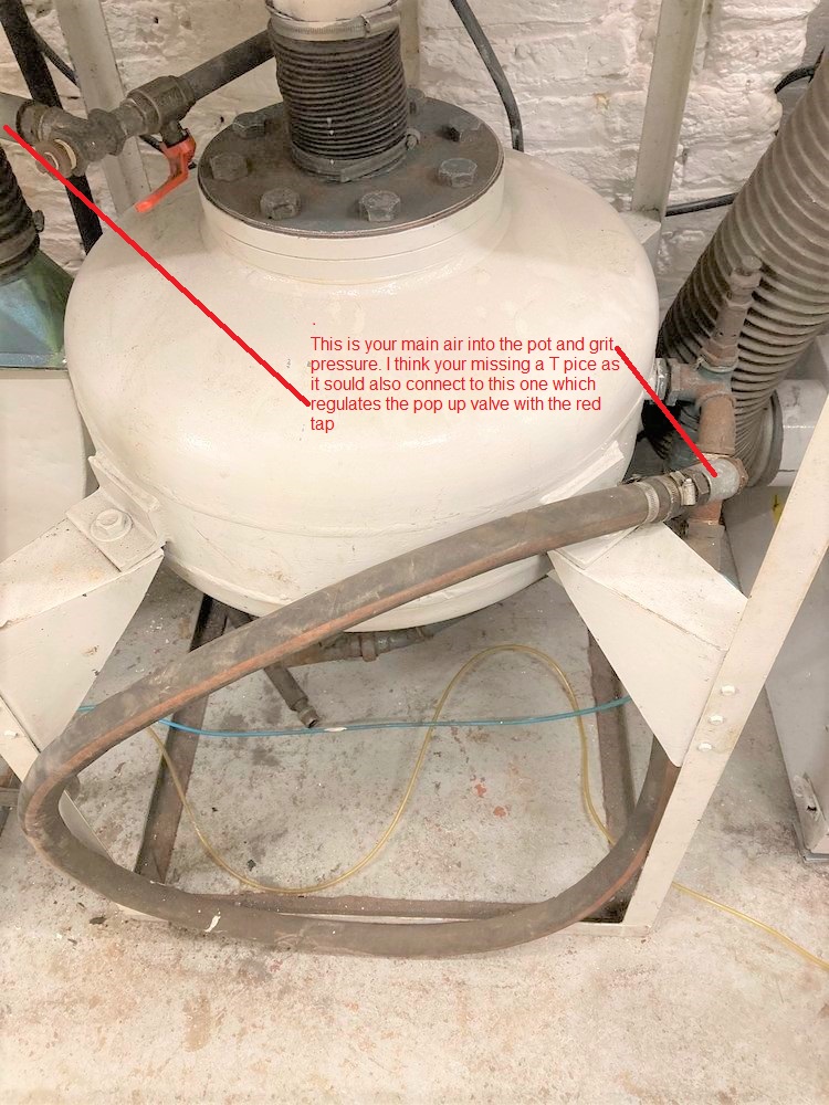

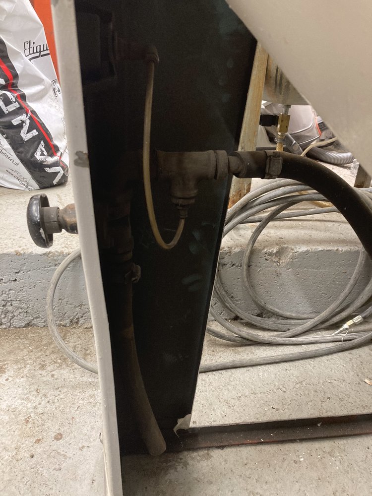

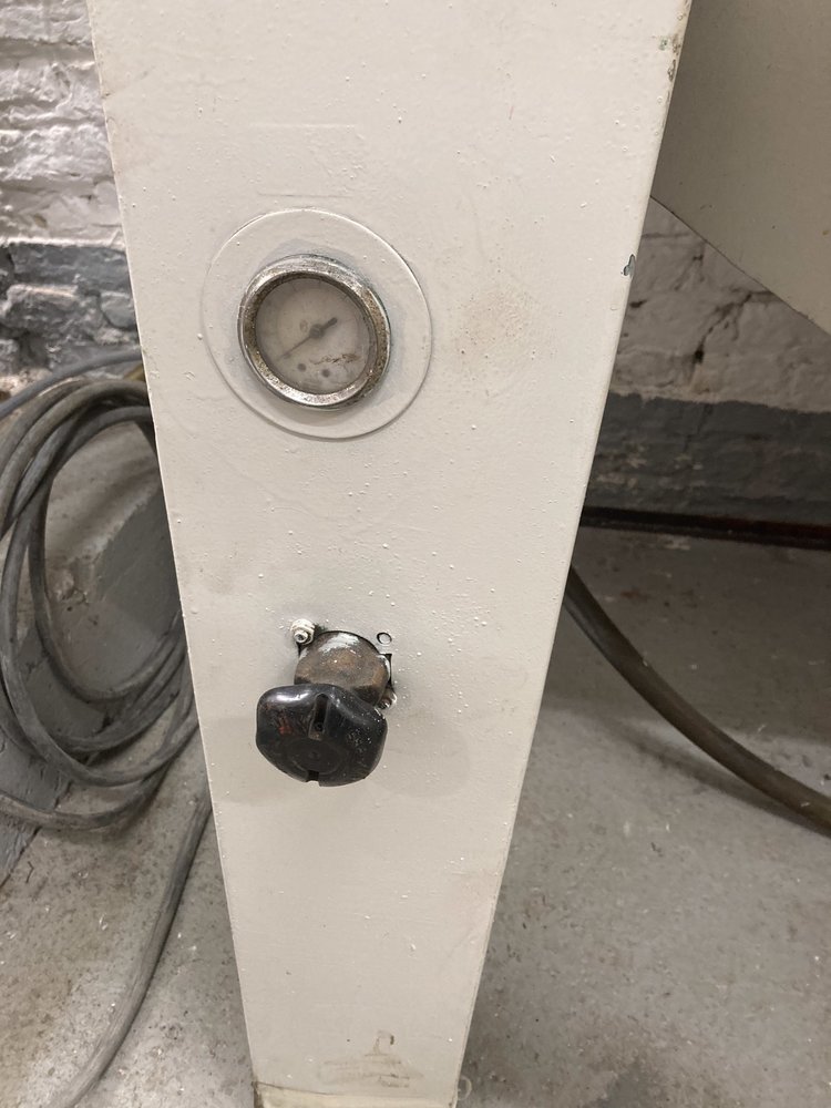

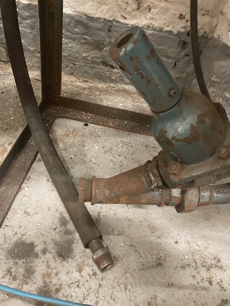

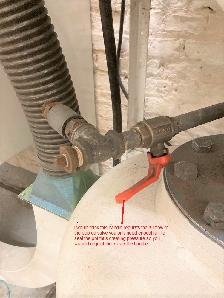

There is a cut hose on the leg of the cabinet which goes to a valve. The valve has a pressure dial coming out of it showin pressure on the leg. The other side of the has the same diameter hose which is long enough to go over to the pressure only problem is the male fitting is too big to screw into any of the 3 fittings on the blast pot.

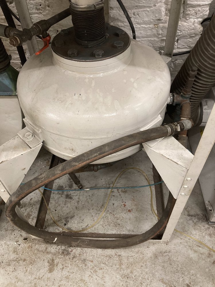

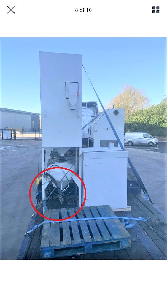

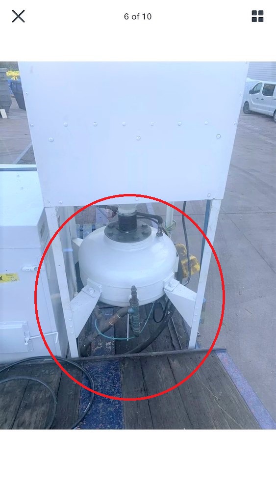

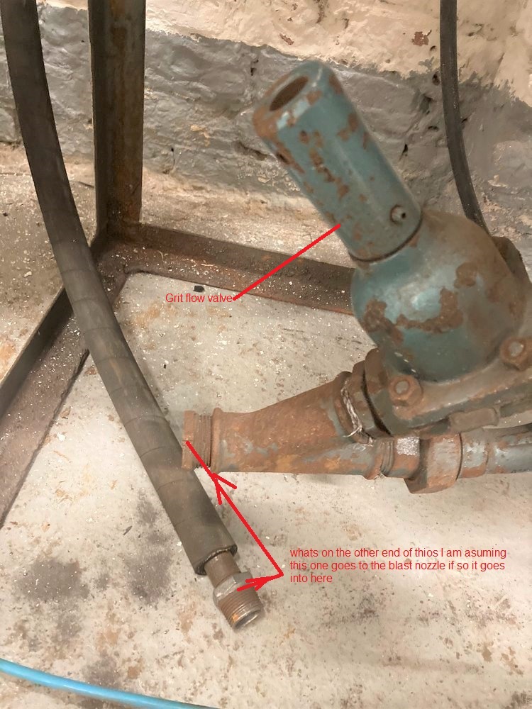

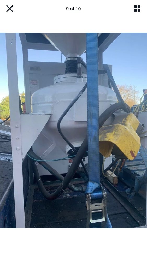

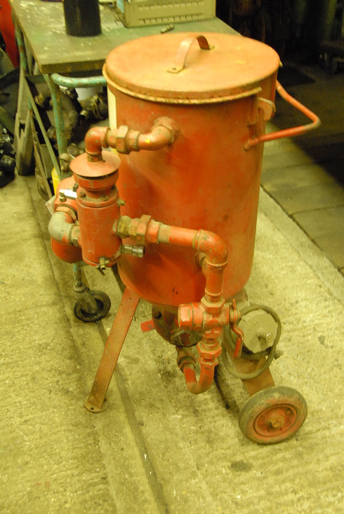

Now to the blast pot. On the bottom there is a mixer tap and female thread which I’m certain is where the media delivery hose to the gun goes. Then I’m left with two other points t need to be hooked up.
There is a hydraulic hose coming from the centre of the blast pot which directly after is a control valve which has a small control hose that goes to the foot pedal. Then the pipe work goes into the pot half way up and also down to the media mixing valve. The thread on this hose is female.

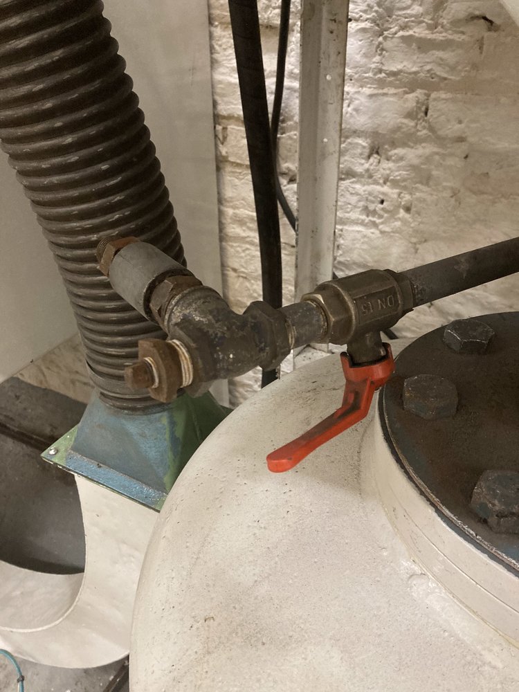

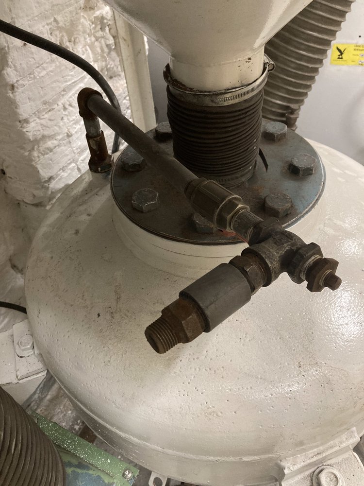

Then there is a pipe coming from the top of the pressure pot. This has a ball valve in it and then other end a T. One end is blanked off and the other is a male fitting. I think this might be the size to fit the mid way up hydraulic hose but I will have to check.

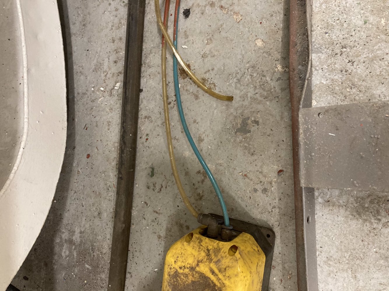

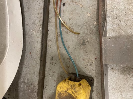

Finally the foot switch has a second air hose which goes to nowhere. There are no fittings anywhere on any of the machines for this to go.
Spoke to Guyson yesterday and it was like pulling teeth to get a little bit of info out of them. Their £100 ph for travelling is taking the pi##.
The info I got from that was the second foot pedal hose needs to go to a air line feed which constant air. When you press the air goes down the first hose to open the air switch to let the pressure pot pressurise.

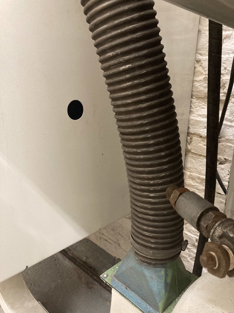

Then the outlet on the top of the pot should be piped into cabinet as that is a air dump for the pot depressurising when you release the foot pedal.
My thongs originally until fittings didn’t match up was to put my mains airline into the cut hose on the cabinet. Then the other end of that hose to go into the hydraulic hose on the pot which is half way up the pot. That would then leave me with running a hose from thte top inlet to the pot through to the cabinet for exhausting the pressure pot air. Then I would also have to get the second hose from the foot pedal to my main airline.
Any advise on this would be really helpful. Had plenty of suction fed systems in the past but never a pressure pot version.
Regards
Ross

if you live anywhere near tell em your interested in buying one and go have a look
i had a good nosey at the cabinets and gear when i went there
