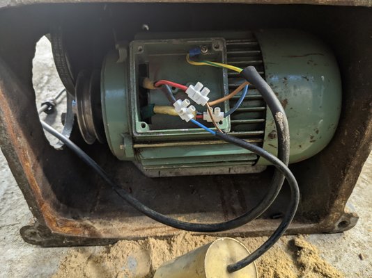

I've lost patience with this now...changed the motor in my little linisher.
Someone had taken the terminal block from the donor so after some head scratching I got it running with some chocolate blocks (I will change these later)
Now it runs absolutely great like this....but in the wrong direction.
No problem says I...reverse the polarity....still runs the wrong way...
Ok I must have made a bottom of it...I try every combination...it either runs the wrong way perfectly...or the right way but has no torque and gets all hot.
Can someone please relieve me of my ignorance?
As far as I know the red wires are the main winding and the blue are the auxiliary.
