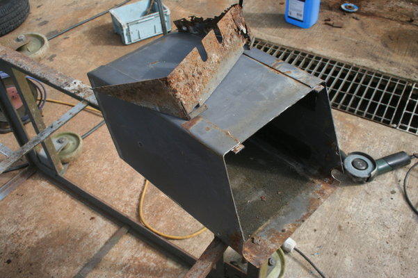

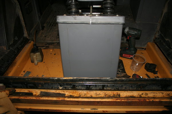

Today I got a bit closer to getting the Ford rubber wheeled digger back together.
Ii was a wet night but I put the cover for the levers back on.
I took it off because there was a bit of rot at the bottom that I discovered when I was investigating the foot pedal for the dipper arm extension.
Thought it was the valve, but it was just the pedal.
Made a new pin and straightened the pedal while I was at it.
I recon someone must have used a crow bar to get the jib extension back in at some time.
Of course once you get in, you see other problems so thought I'd fix the cover.
The steel is 1.2mm so easier than usual for this sort of thing.
I wasn't too fussy with this or bother filling it so just a couple of coats of Jotun 90 epoxy as a primer filler.
Let it dry for a day and a quick sand.
Then some matt grey 2K I got mixed.
The top cover wasn’t painted but the colour looks closer in real life.
I think the flash shows a bigger difference. (well that’s my excuse and I’m sticking to it)
The floor also got the Jotun treatment and some 2k with a brush which goes on really well.
I need to thank @arther dailey for that tip.
