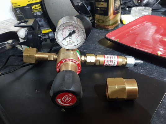

Nope, no confusion. It has a small injector and needs high pressure to get the flow. My torch has a max inlet pressure of 4bar. I’m using an adjustable reg that goes up to 6bar(max you can get from propane as that’s what the cylinder pressure is).
Ovens/gas hobs that sort of thing just let the gas out and it burns with the oxygen in the ambient air.
Forges / big flame devices / blow torches use a smaller nozzle and much higher pressure to up the speed of the gas and use a venturi to draw in the extra air they need.
