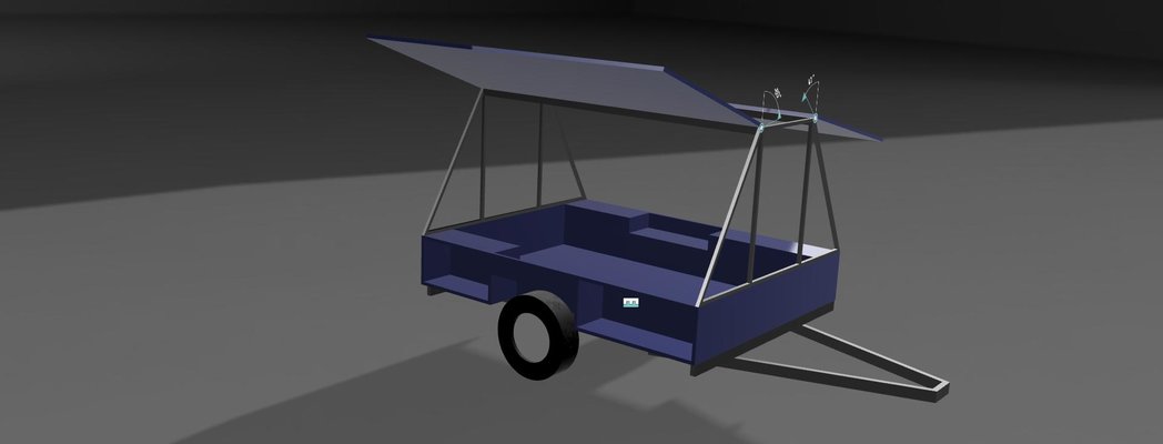

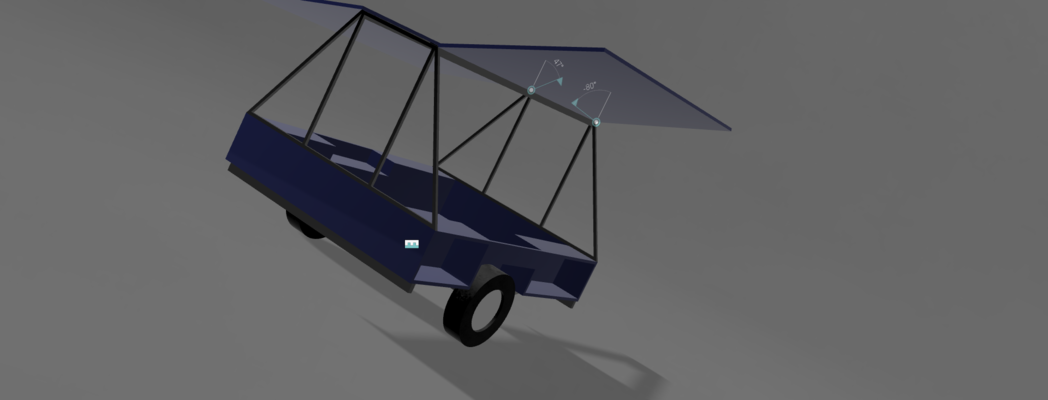

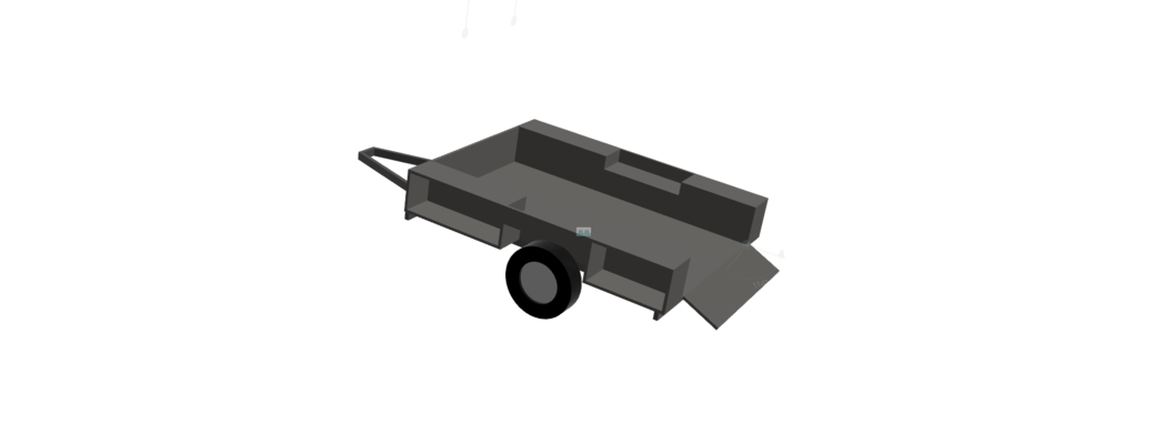

Started work today on my new trailer build.
Cut down a 1.6T caravan base, and built a model in Fusion.
It's basically a tribute to a "Sankey" military tool trailer, but adapted for my uses: Mainly that it will be a little bit bigger, so I can carry 8x4 sheets inside it.
The idea is to have a "tub" that is 76" wide, with a 8x4 space down the centre. Either side will be a "space frame" box about 12" x 12" to which will form the wheel arches and some externally accessible cupboards.
A flap at the back will allow access to the sheet transport area.
On top of this will be a (removeable) bench/tool storage/ open area with hatches which will lift up to form a roof area, and then fold out table/benches
