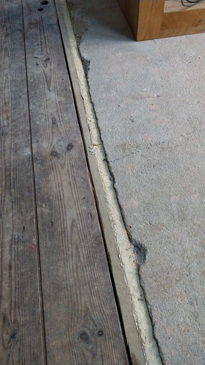

I need some expert advice on flooring I've had an extension done on the back of the house which is why I've not been doing much in the way of metal bashing for the last two years
Anyway I need to lay carpet across the joint between the old floorboards and the new screed floor. I'm thinking of laying 5mm ply down over the old boards as they have shrunk and have gaps between them, but I'm not sure about the screed floor? Do I overlap the ply 6" onto the screed then use self leveling compound on the screed to bring it level.
Any advice is appreciated.
Some photos,
