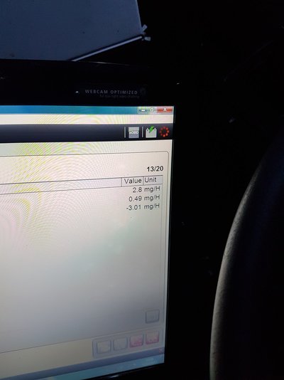

1.4 polo TDI has had injector problems so over a period of 6 months we have changed all 3.
Recently ìt started cutting out after 3 to 5 mins running. So read up on the internet and it all pointed to relay 109.
Changed that today it cut out after 4 mins from cold.
My son then unplugged and plugged back in the cam sensor and it showed up on delphi.
But its now for over 30 mins without cutting out.........its still not right and we think one of the injectors is still fubared.
Does anyone know what they are looking at in relation to the figures in delphi maybe @doubleboost or @normspanners for example.???
Anyone else feel free to chirp up as i need to get in the workshop over the weekend.
I will try and add a video of the 3 injectors in delphi....
Here is a screen shot.
Update. Its also very difficult to start ........and has a lumpy idle.
