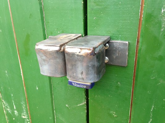

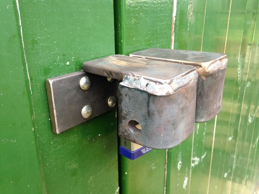

In the process of upping workshop security after an unwelcome visitor asking for scrap. This morning I made a padlock shield for one of my padlocks using 60 x 10mm flat leftover from a strap hinge job I've been doing. The hole on the left is for me to hang the padlock on when I'm in the workshop. I'm going to beef up the washers on the back of the door too in an attempt to make it more difficult for crowbar to rip it off the door face.
yours will stop the average scrote breaking in wanting to buy a bag of smack
