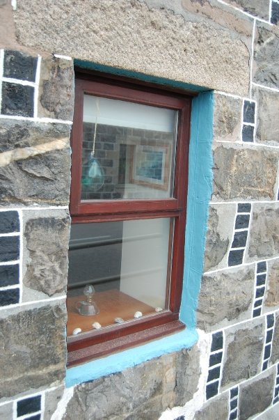

are u fensa registered cant sell your house without the poxy bit of paperI fitted 4 at our house last year no problems. I used the concrete screws the window place gave me as they are the same as they use. Don't dog them in they don't need to be countersunk there is clearance when the window closes and the frames will bend if you pull them in too tight. Get plenty of spacers to square them up and don't overdo the expanding foam or it gets messy.
set em up with the packers and foam them in 1st let set then screw them in
Thanks. Will the concrete screws go into granite okay?
use sparingly and it wont just don't go stupid use low expansion foam here http://www.wickes.co.uk/Great-Stuff-Window-and-Door-Gun-Foam-750ml/p/118354Ive seen this done where so much foam was used it distorted the frame
Never tried on granite, only one way to find out
tell me about it had to core a 100mm hole through a wall was using a slow hammer drill putting the pilot through and sparks were coming off the bit and t took ages even with a quality Norton diamond hole sawThanks guys. Yeah the granite is tough stuff.
A quick google suggests they will be ok on stone.
