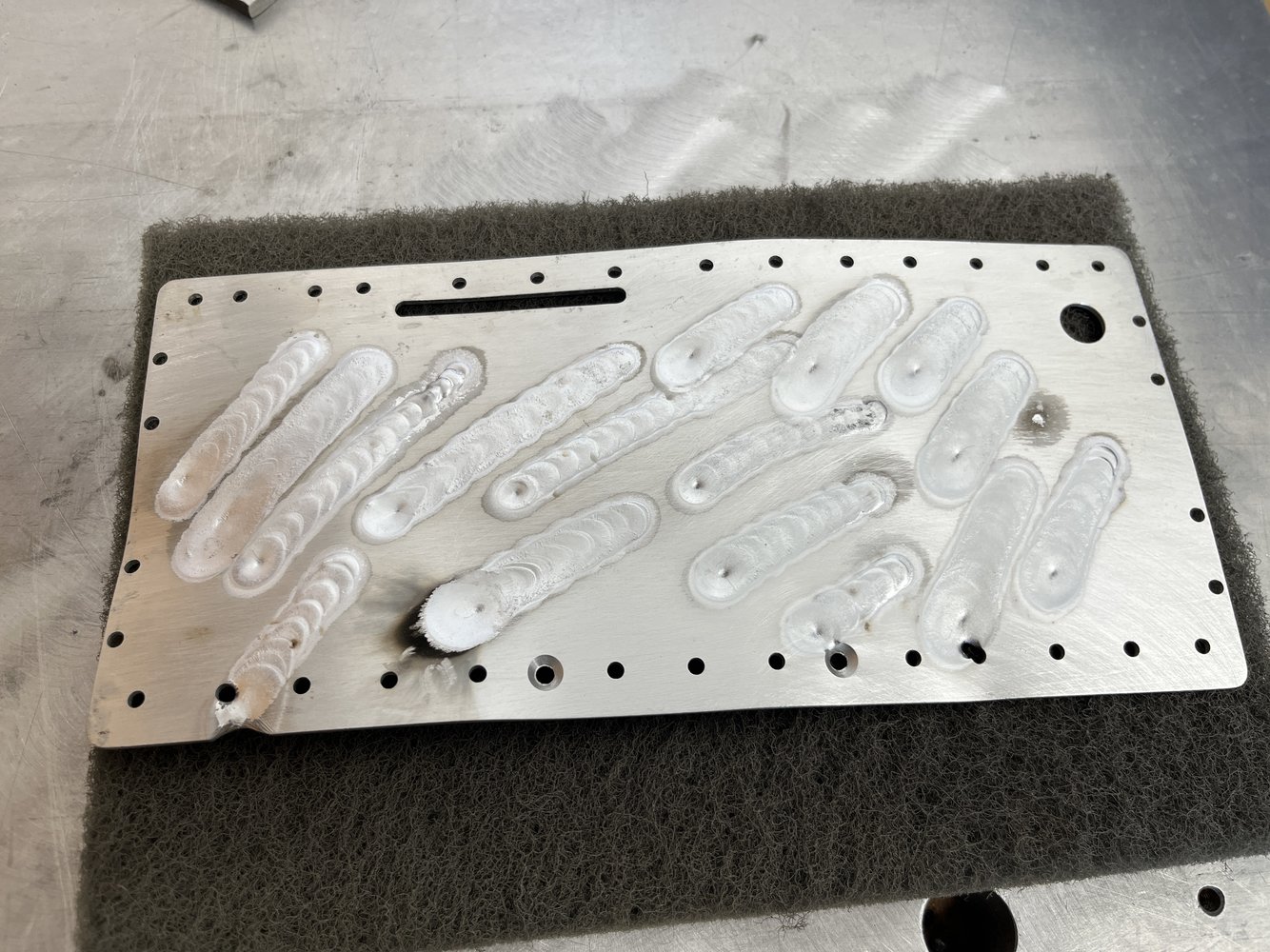

3 mill clean alloy 80 amps 25 % balance 80 hertz

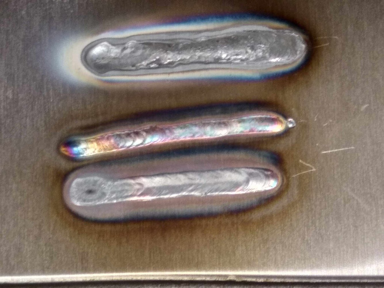

top weld pure argon
bottom weld 5 % co2 mix "argoshield
Top weld 3 mill stainless 80 amp dc no filler rod pure argon
Bottom weld argoshield 5

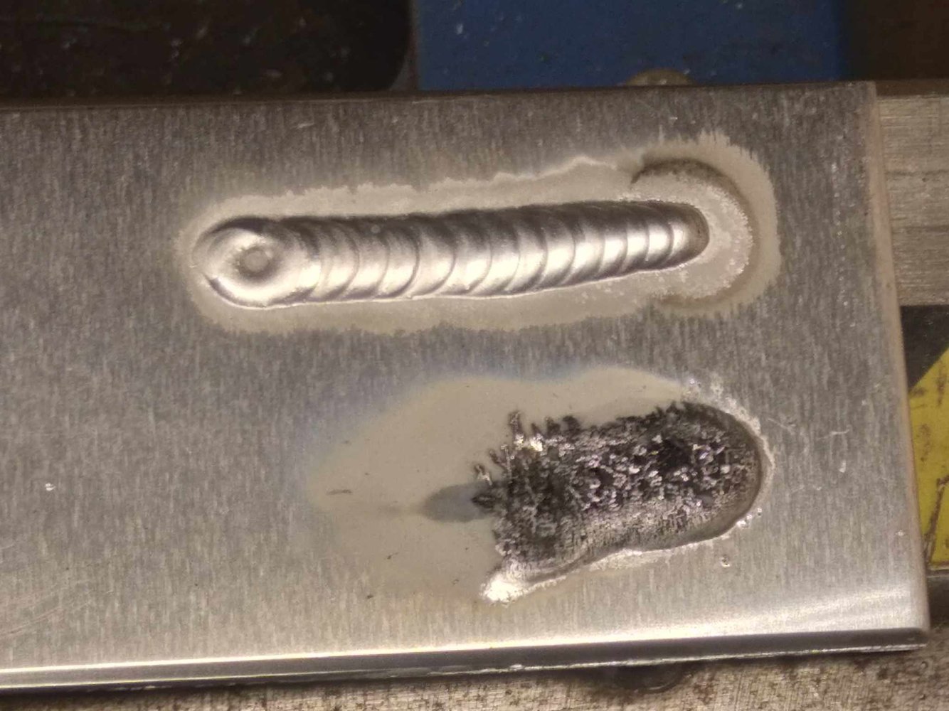

top weld pure argon
