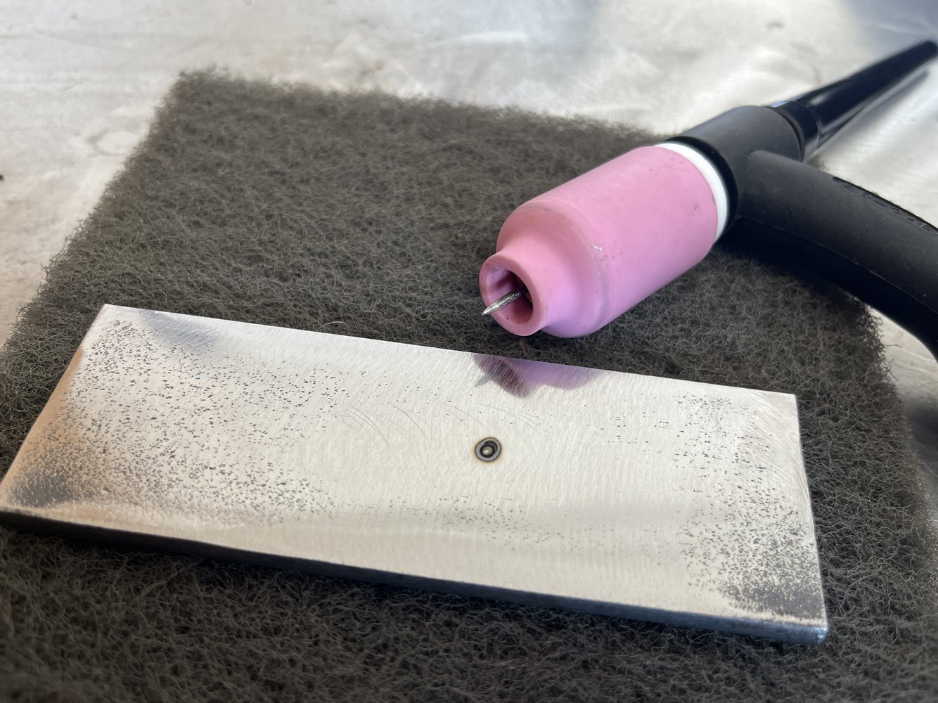

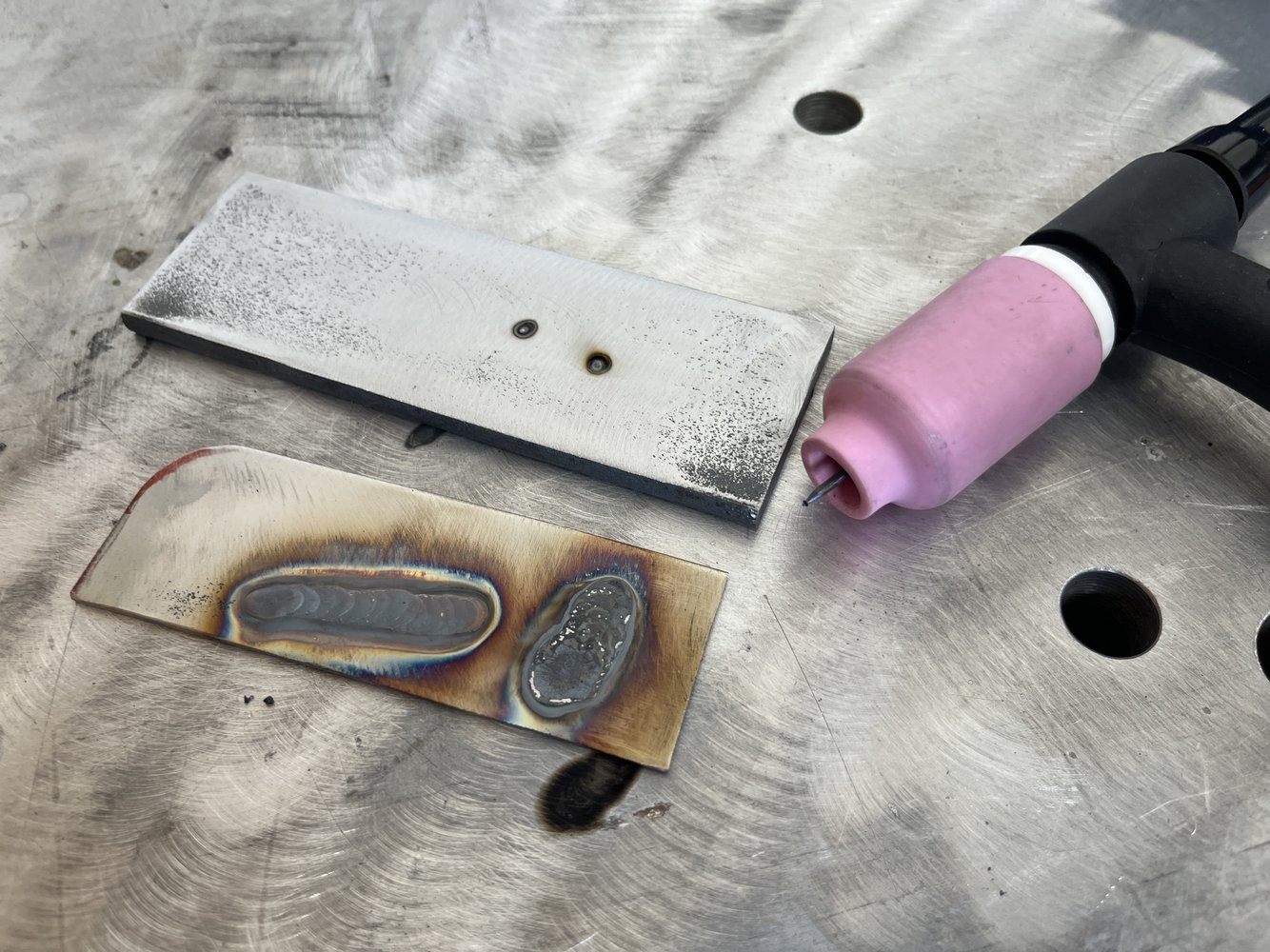

20A DCLets rule out gas. Switch to DC. Sharpen a tungsten, set 20 amps, get a bit of shiny bright clean steel and arc up for a few seconds on it. Take pics of the metal and of the tungsten.

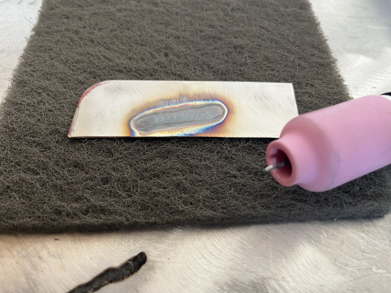

Those both look worse than mine (and that's saying something...) Really looks like a shielding problem to me, that stainless bead should be bright and shiny, not grey and matt. 85A DC - so about 2mm stainless? The puddle on mild steel shouldn't have black smuts either (though 20A is very low!) - did you get given a bottle of Argon/CO2 instead of pure Argon (Argoshield Vs Pureshield)?20A DC
Also ran a bead on 316 stainless with 316 filler, 85A DC
I don't think the current's a problem - too litte can be, as you spend longer putting heat into the work, but going bit hot's not sucha problem.I did 20A because thats what Munkul asked for, the stainless was is about 1.5 - 2mm i just guestimated at 85A but yes its probably a tad much
why not try same test with tig and 5 , to see if the results are the sameI did 20A because thats what Munkul asked for, the stainless was is about 1.5 - 2mm i just guestimated at 85A but yes its probably a tad much... The cylinder says its pure argon, what they filled it with i don't know... though i am tempted to run some mig welds off it to see how it compares to my 5% mix.
