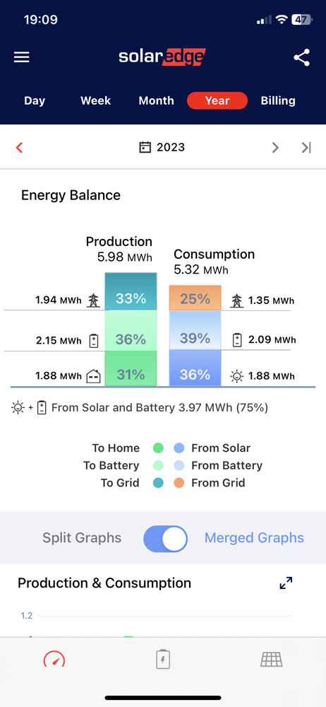

A hybrid inverter. They're a bit more expensive (~1.5x) but can be used with or without batteries. Don't worry about changing over, the inverter will sort that.dumb question possibly.......
