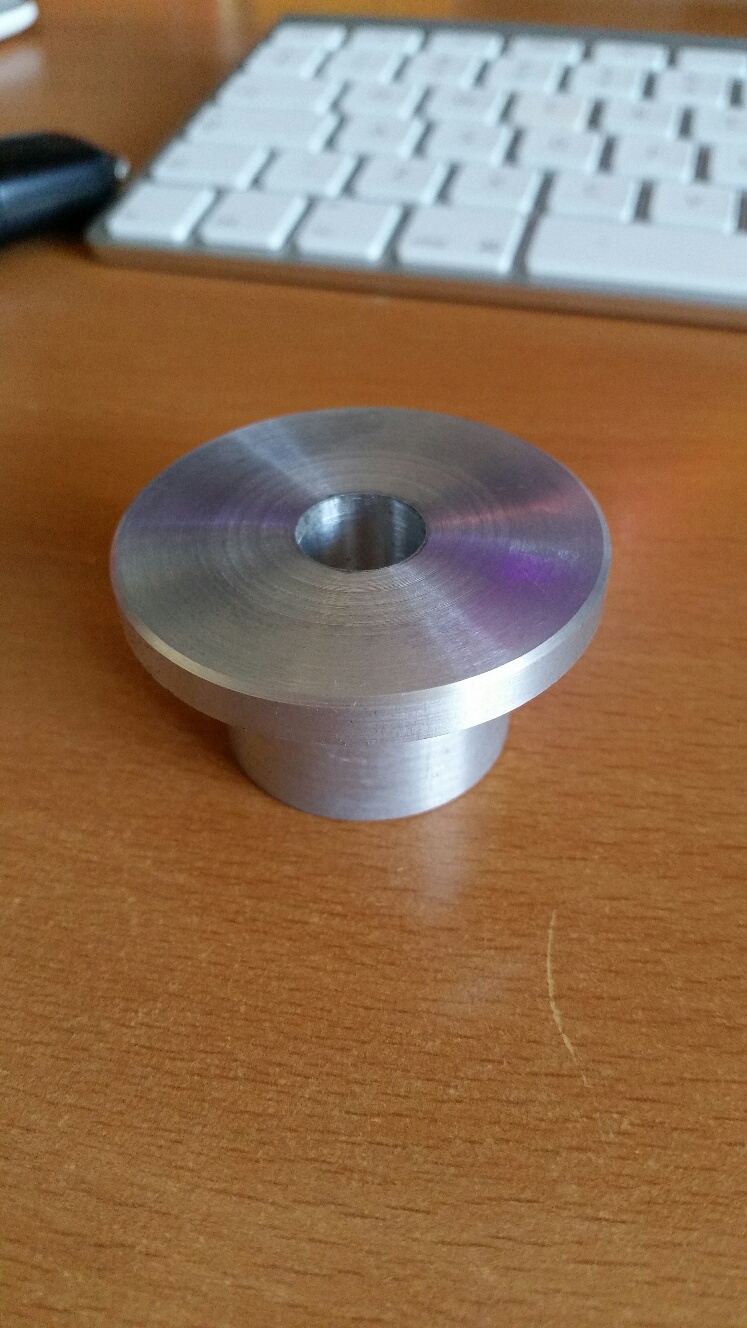

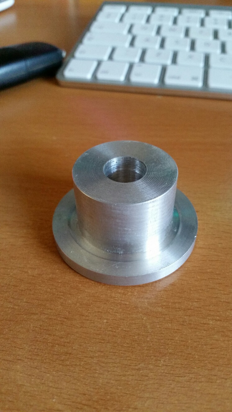

I finished the hub a little disappointed in myself i bored out too much. It was going great taking a little off at a time got it to 12.66mm and set the cut to 0.05mm. Then it ended up 12.97mm . I think this happened as i moved the tool away from the work to measure up got it touching with the lathe off then added 0.05mm and started up the lathe. What should i have done here??
It works i even unclamped the grinder from the bench and it did not move one inch (prior to this it would vibrate off the bench). But i can still see a wobble in the wheel and wonder if this would be there if i had been a little more accurate with boring the hole.
