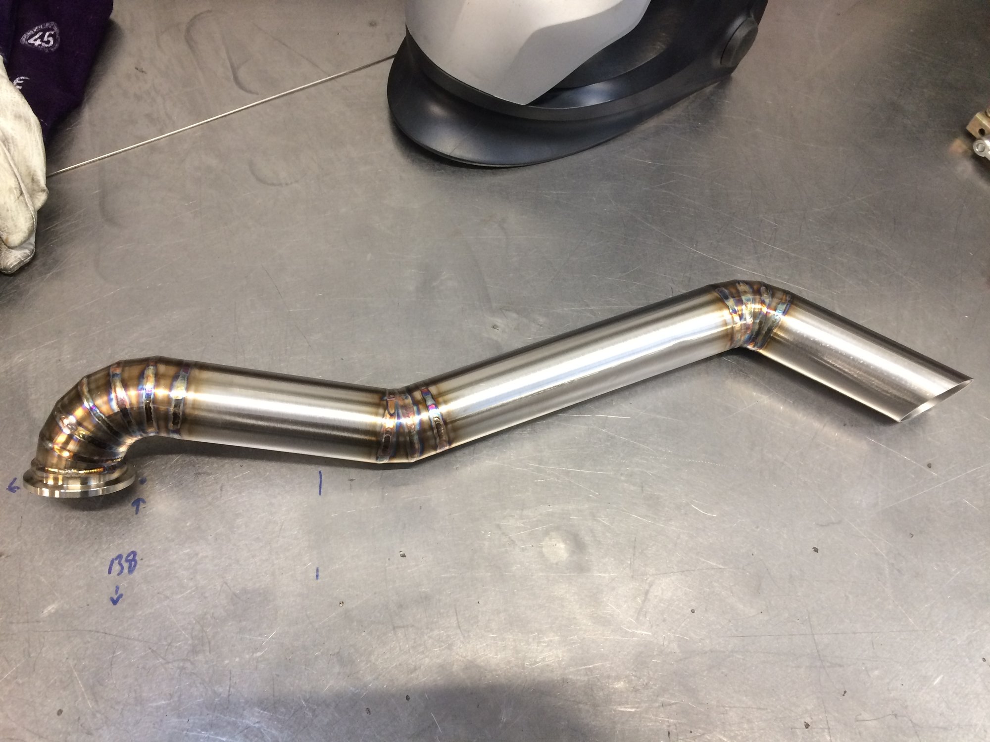

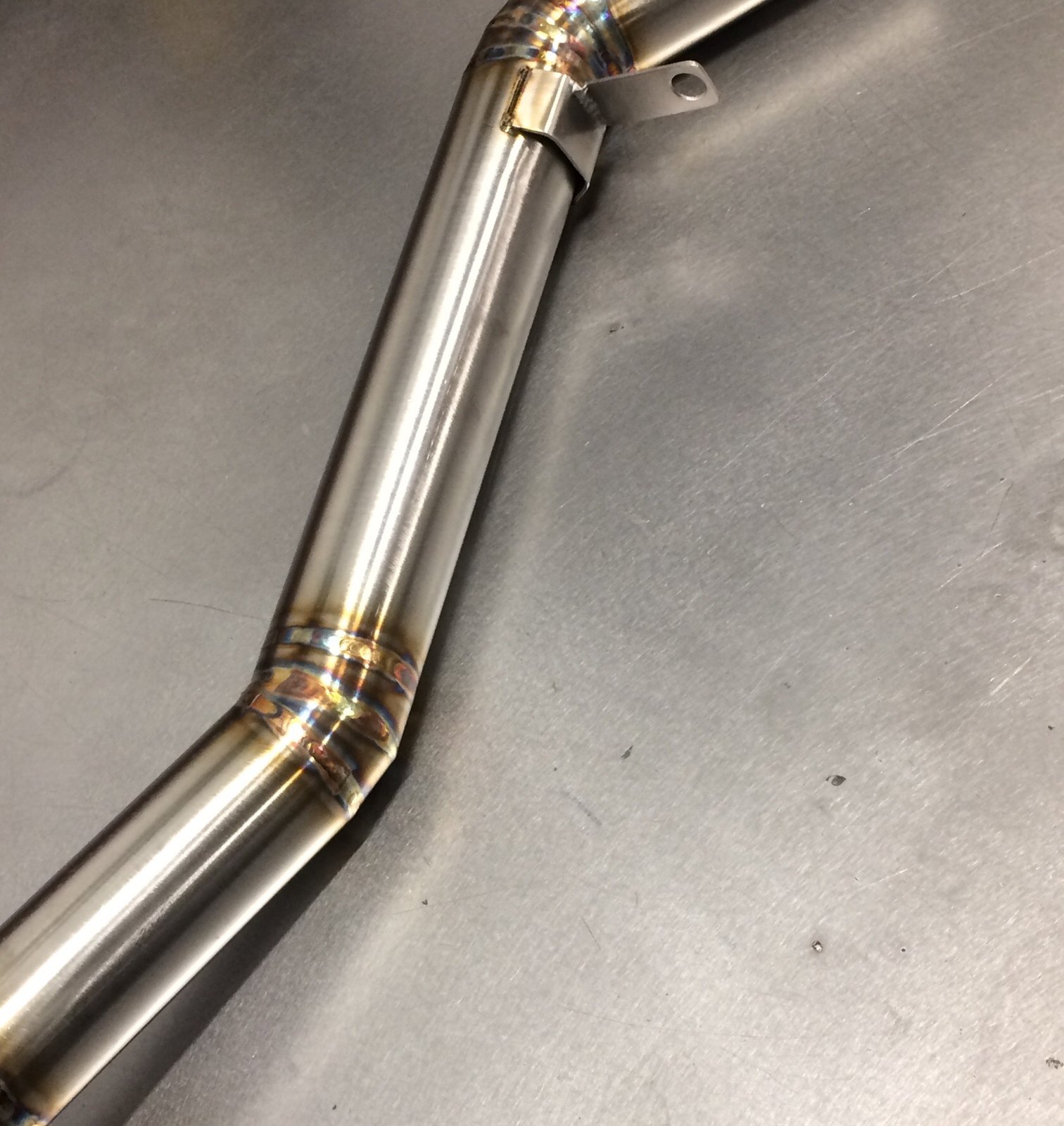

Waaaaaaay neater that.Hi
Yeah I nipped the edges on that

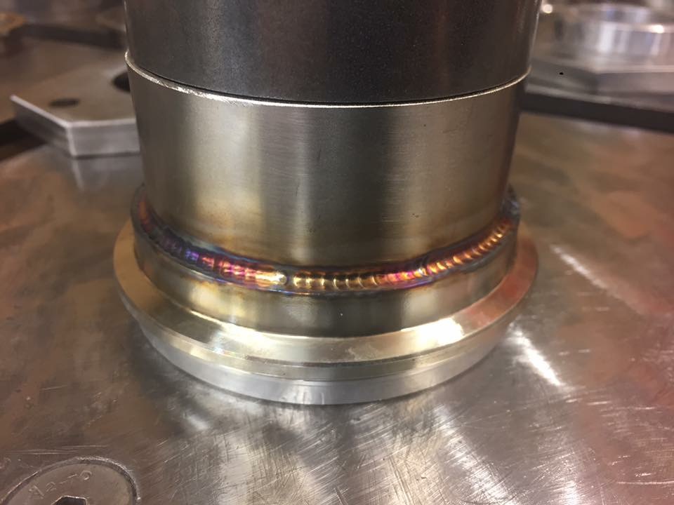

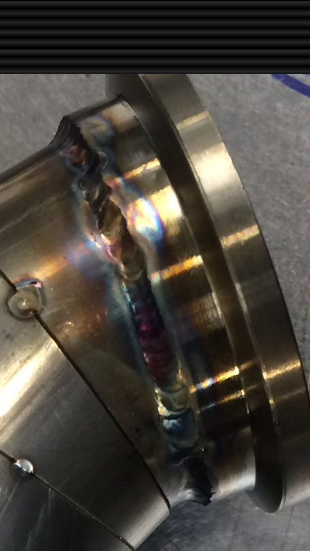

The only stainless filler work had was 1.6mm which is way too big and it washed out too far
I normally use 1mm max

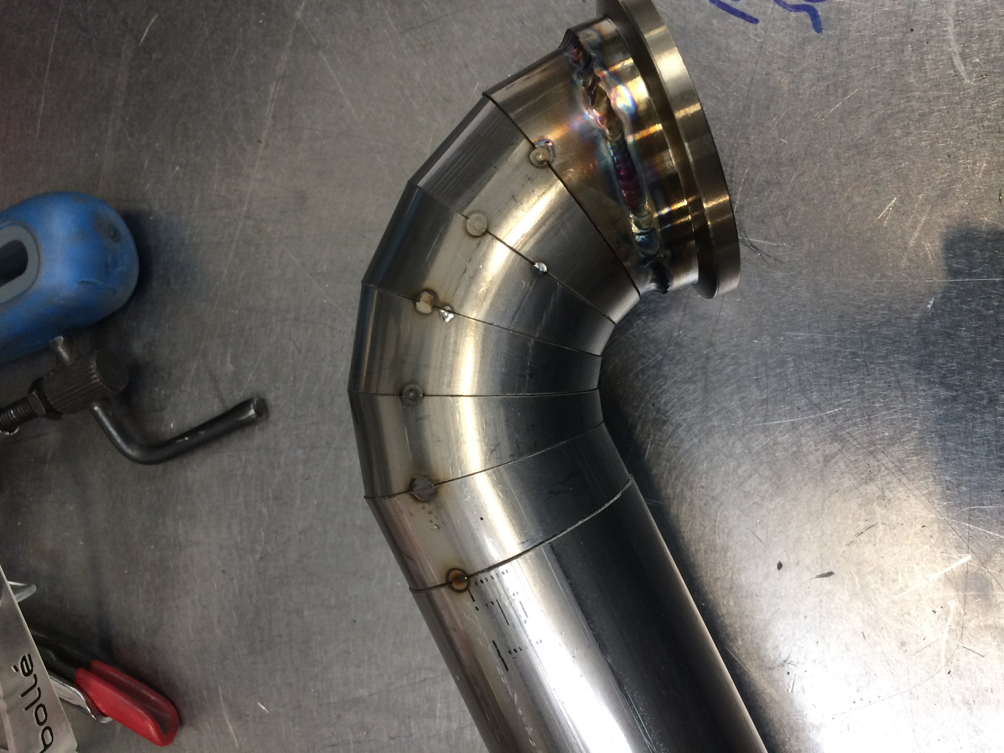

Heres another larger 3” flange I done recently at home with 1mm filler
