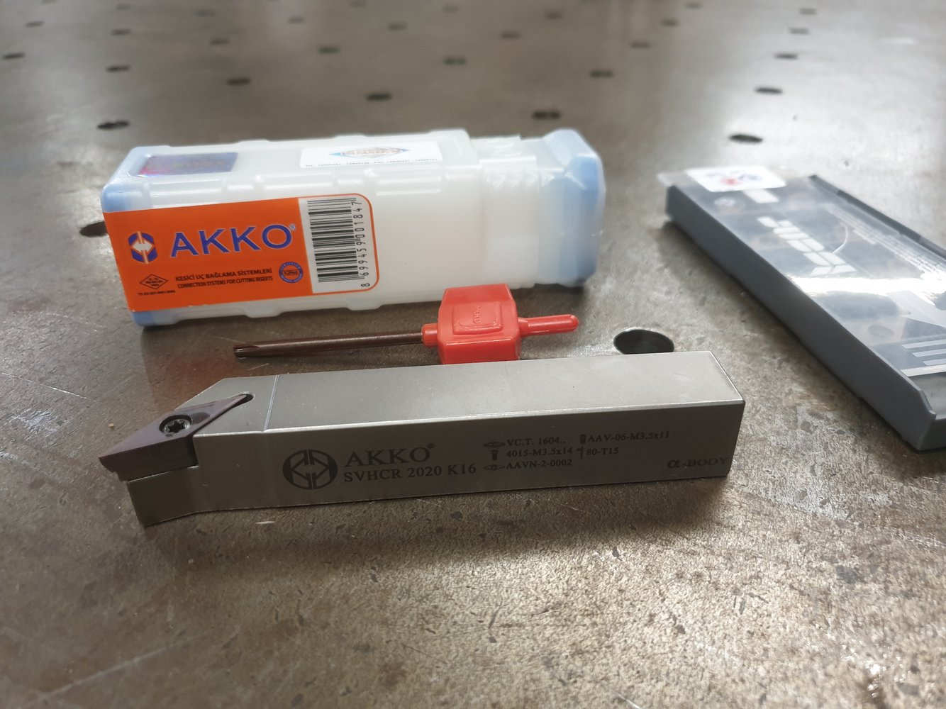

I got a new toy tonight... SVHCR and some VCMT16 inserts from ebay

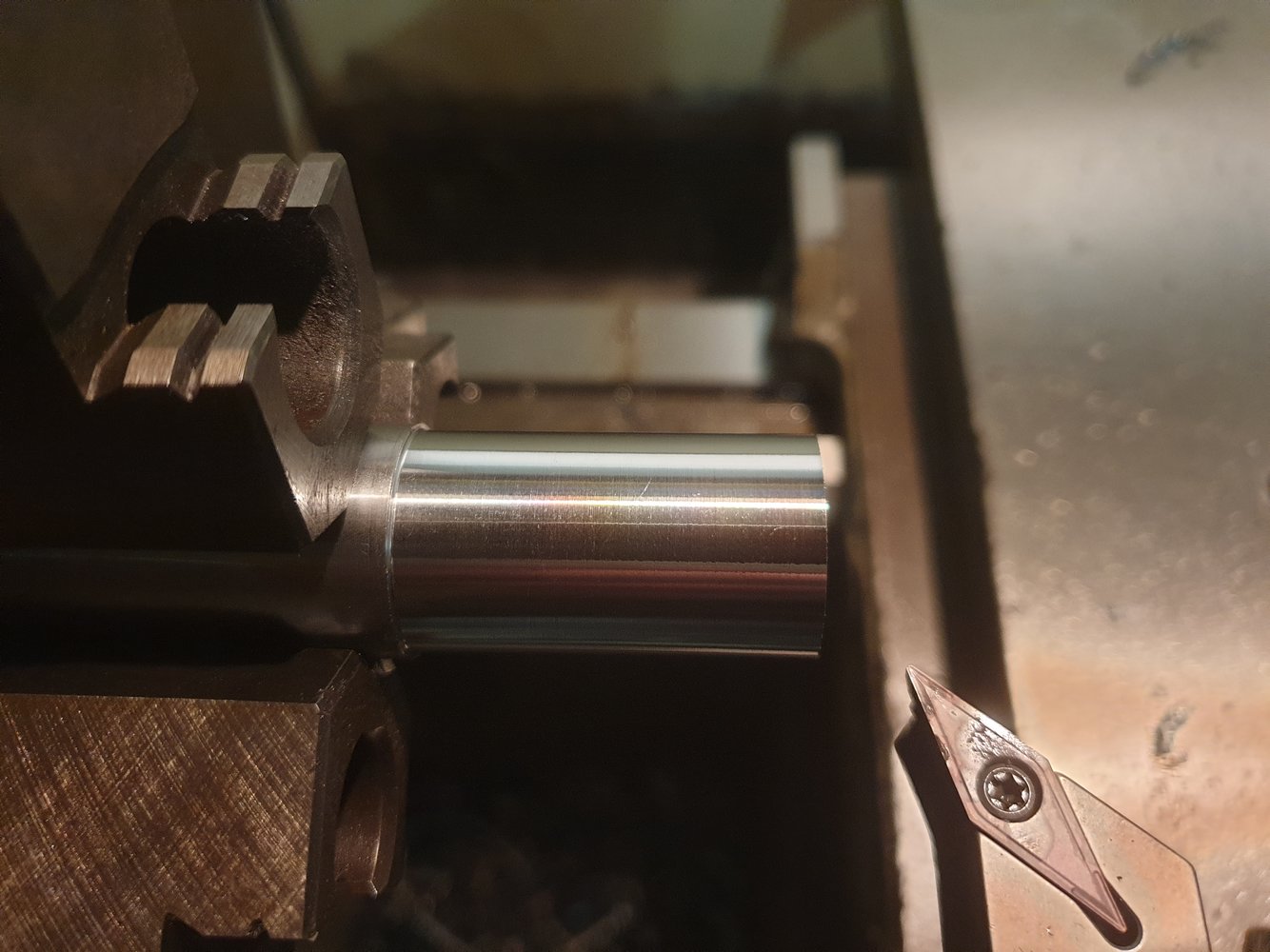

So, bear in mind this is gummy black bar, maybe EN1, maybe ungraded. This was a 0.5mm DOC, 25mm dia, 1000rpm, 5 TPR feed.
It's almost flawless! Again, pictures pick up more than the naked eye does, it's almost mirror finish. If it was a better steel, I think it would be flawless.. but then again, better steels give better finishes anyway.
I like this tool and these inserts very, very much. I only wish I'd got it with a 25mm or 30mm shank.
Added bonus: if you're lazy you can get a badly angled chamfer on one side shoulder by using the far edge, and run the lathe in reverse to chamfer the other side shoulder... ask me if I tried well it takes the sharp edge off anyway!
Downsides: It doesn't like deep cuts. I pushed it with a 3mm DOC and was rewarded with a hot stringy mess. It also doesn't like higher than 5 TPR feed. So no good for roughing. It literally likes 3-5 TPR and 0.5-1.5mm DOC. This is more or less exactly within the parameters written on the insert box. It doesn't mind going slower, too.
This is the tool:
Akko Rotary Holder 107,5° for Indexable Inserts Type Vcmt 1604 Svhr / L 2020 K16 | eBay
Akko Rotary holder 107.5° with the item designation: SVHCR/L 2020 K16 h= 20mm b = 20mm L = 125mm f= 25mm for inserts type VCMT 1604.. with backing plates Dimensions and other available sizes: .www.ebay.co.uk
These are the inserts:
VCMT 160404 CARBIDE TURNING INSERTS (Read Description For My Quality Guarantee) | eBay
My Inserts are a good all round grade that will cut various materials such as Steel, Stainless, Cast Iron etc. Anyone buying inserts from China on here be very careful.www.ebay.co.uk

I wonder if it was your original post that got me thinking I wanted an angled VCMT tool? The angle on this is great for turning and facing up to shoulders, loads of clearance for fiddly stuff too.
