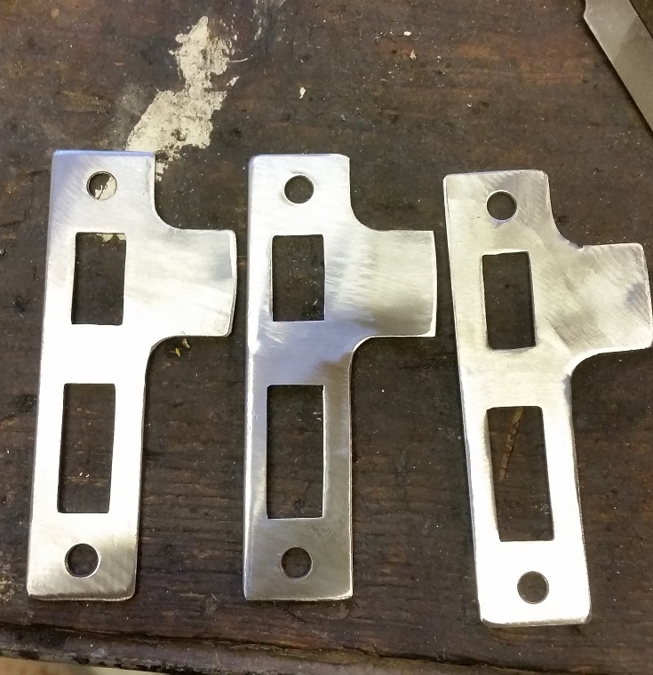

very goodI opted for making them myself and they've not come out too bad. Some of the edges could do with another going over with the file to make them straighter but they're almost there. I cut the basic shape out of some stainless sheet with the grinder and 1mm cutting disc. For the rectangular shapes I used a pillar drill to get rid of the bulk of the material, before filing down the edges. Having a selection of files certainly made life easier although it's an art to get a perfectly straight edge! Final step before taking the pic was to give them a once over with a 120grt flap disc. However, I intend to go over them again with a finer grit sandpaper to really make them shine.
