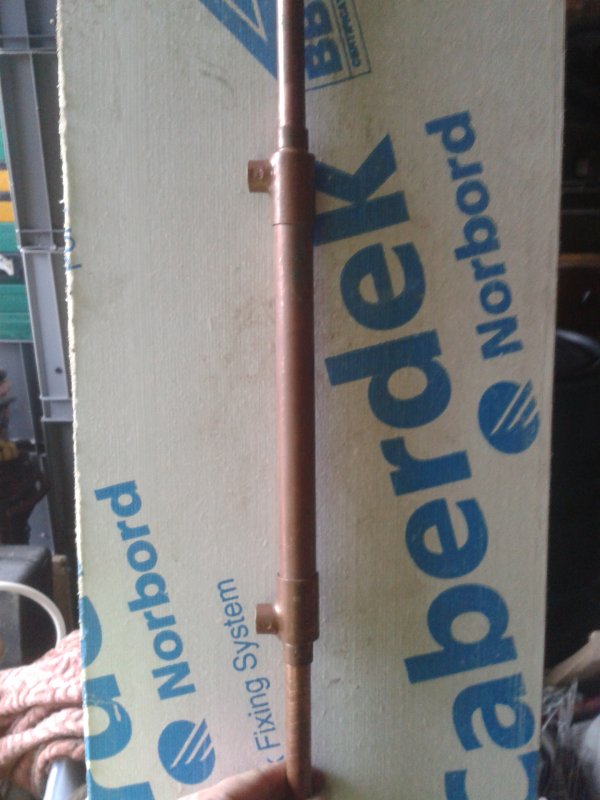

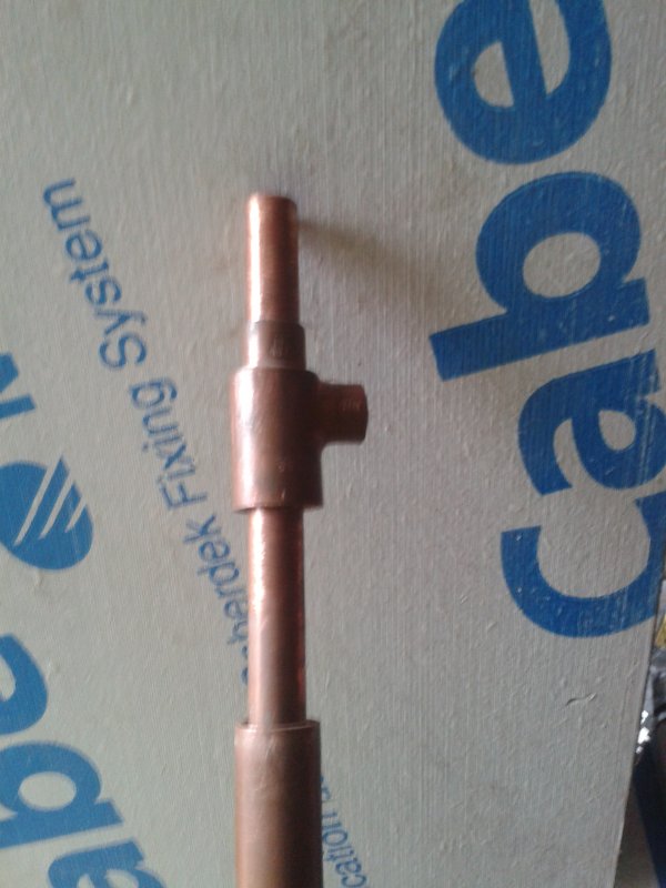

something like this???At my last place I needed dry air for a cnc machine tool. I rigged a 15 mm pipe to run co-axially inside a 22 mm pipe using 15 22 22 tees. Usually the air just ran though the 15 mm pipe, but when I wanted to run the machine I had cold water running to waste through the 22 mm - it only needed a trickle. The arrangement was screwed to the wall like yours at 45 degrees with a drain at the bottom
