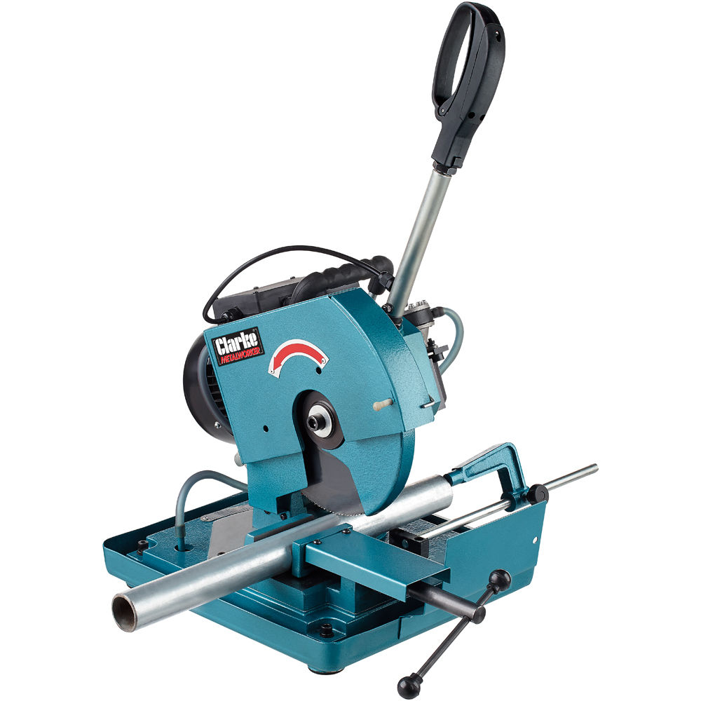

What cutting fluids can you reccomend for my cut off saw with built in pump, it will live in an unheated shed where everything goes rusty every winter, so maybe oil based ?
Is there anything cheap and homemade from off the shelf ingredients that works ?

I use to use that also but it leaves a sticky mess after a while and needs scrapping off.I use 20 parts water 1 part rapeseed oil (cooking oil) with a dash of washing up liquid

Fine for ally, I'd expect a smokey cut in steel though.What about WD40 , I have 5 L of it I don't need ?
In my experience it vaporises much too easily for anything but light cuts in aluminium.What about WD40 , I have 5 L of it I don't need ?
