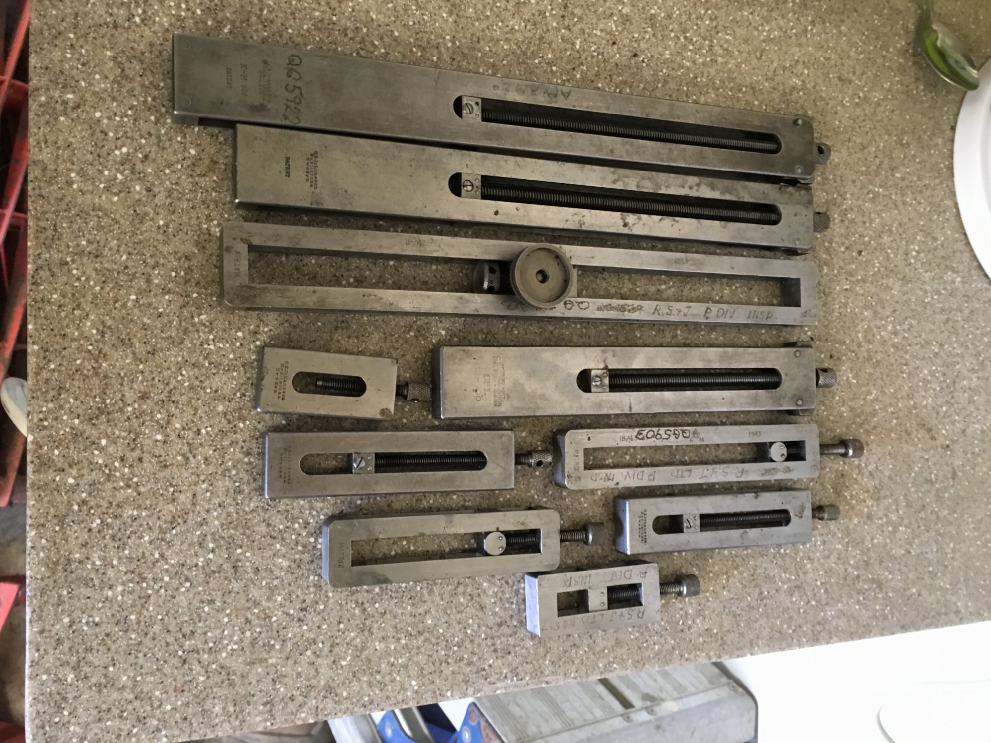

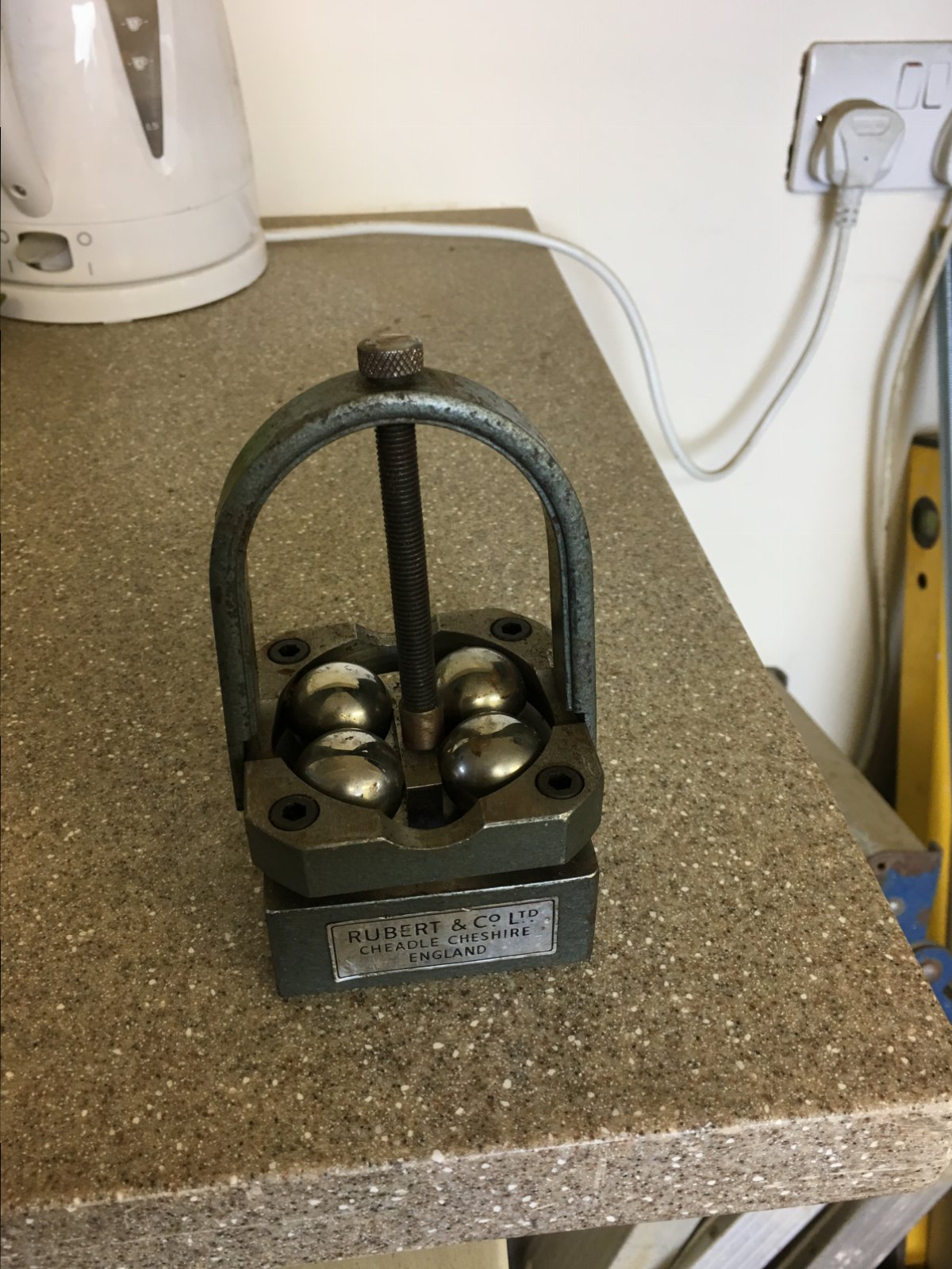

    IMG_0642.JPG Anyone know what these are please?
  2. rory1
    rory1 Member
    Messages:
    816
    Location:
    Macclesfield
    Bottom ones are for stacking slip gauges together
    Top one looks to be some sort of v- block

    Rubert make precision surface finish measuring equipment. Don't know if that helps? :dontknow:

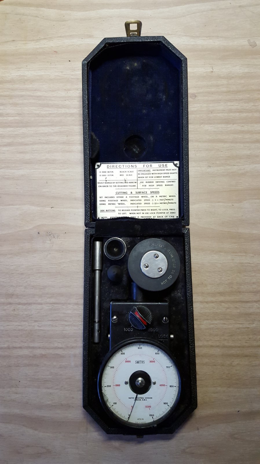

    IMG_0643.JPG Cheers thanks, what about this?

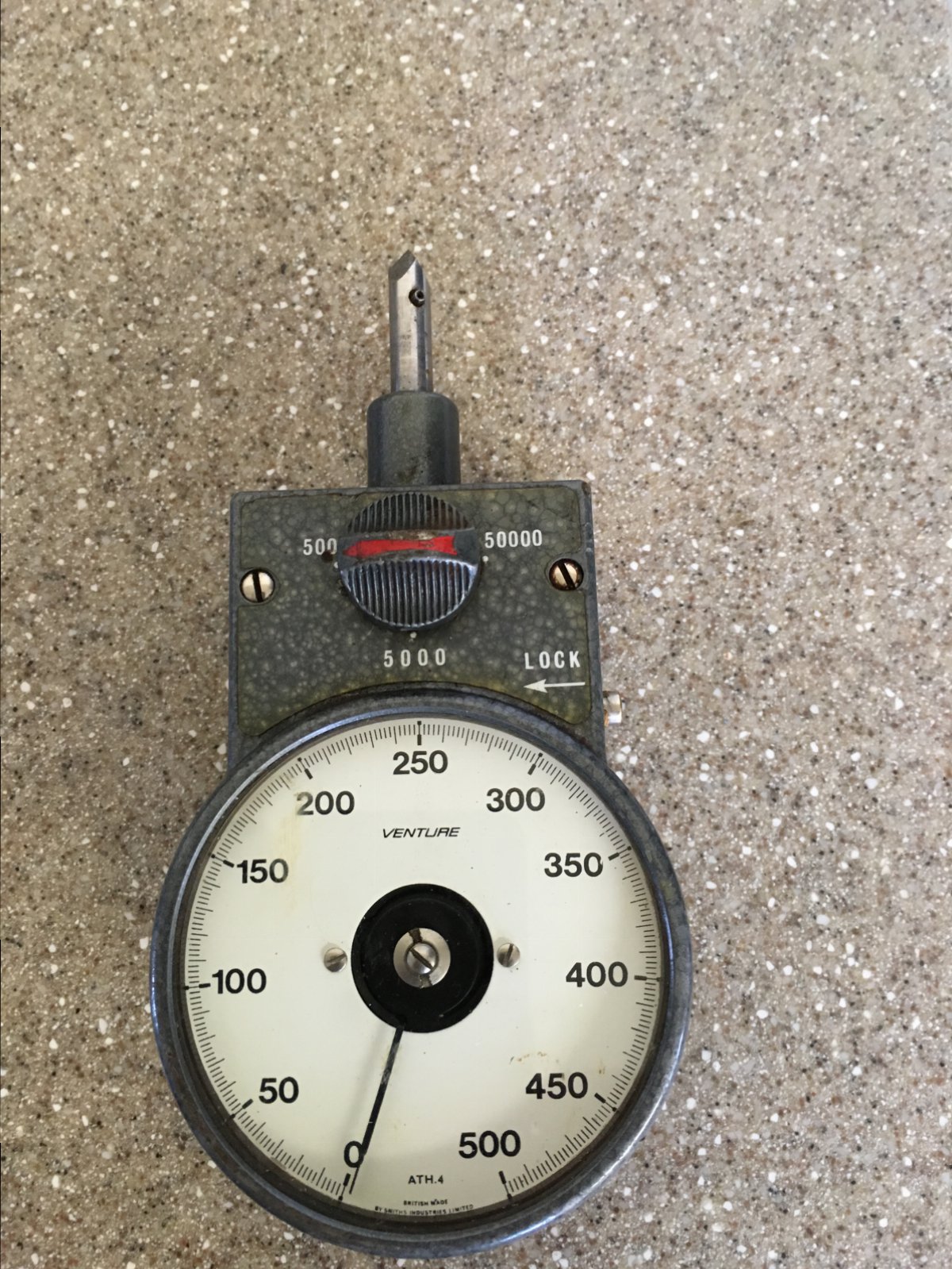

    That's a tachometer; measures rpm when you press the stylus at the top into the end of a spinning shaft.

    Pure guess for the top one, looks to me like it holds round items and the ball bearings allow for easy turning of the round item

    Tachometer should have changeable rubber ends to measure either shaft speed (cone adaptor) or run on outer diameter using the roller adaptor to calculate the RPM of parts that the cone centre adaptor wont fit.

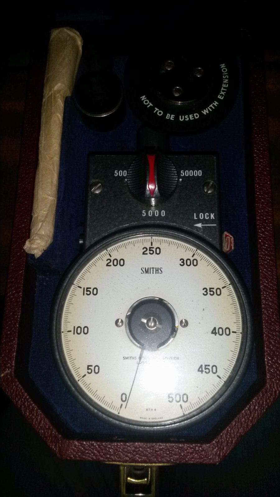

    like this Smith's one that I was given last year

    The top pic is a v block the guys are correct, its really a inspection grade and no use for machine shop use. I'm not sure if the balls are designed to rotate or very simply give minimal point contact for rotation of part to check for concentricity effectively removing any means of high spots or foreign bodies giving false readings.

    Ditto used too use an identical unit (when working) for checking for belt slippage on very large multi belt driven furnace waste gas fans.

    That tacho is unusual in that it has a much higher range than usual. Never seen a 50,000 rpm one before.

    It's for measuring run out on a turned component. It's a consentricity gauge it's used with a dti mounted onto the other end and you spin on the bearings and watch the dti move through high and low points
