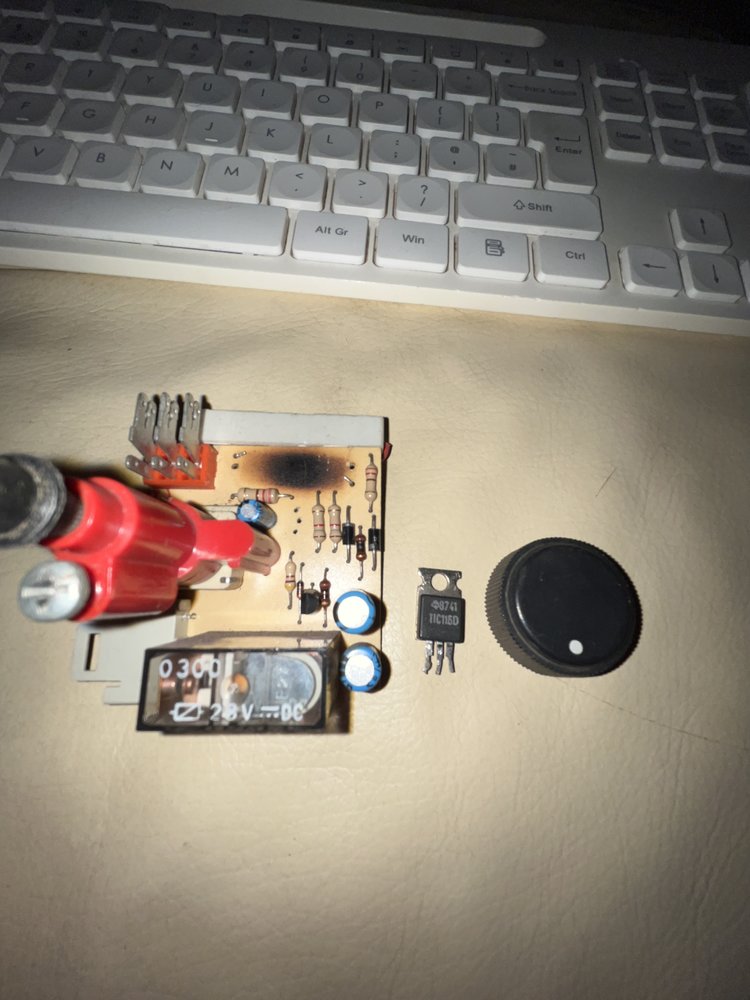

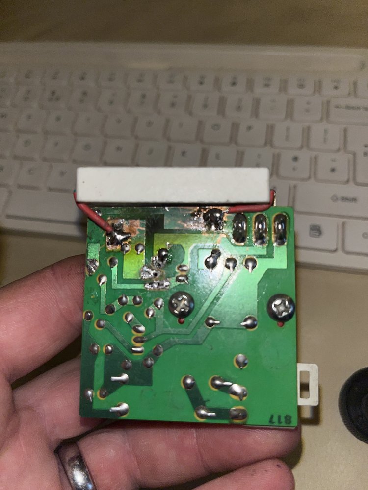

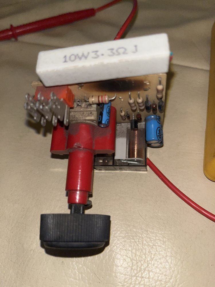

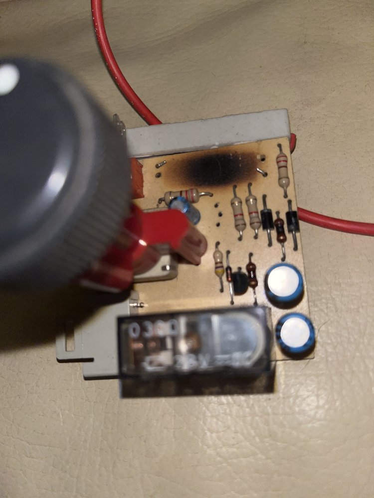

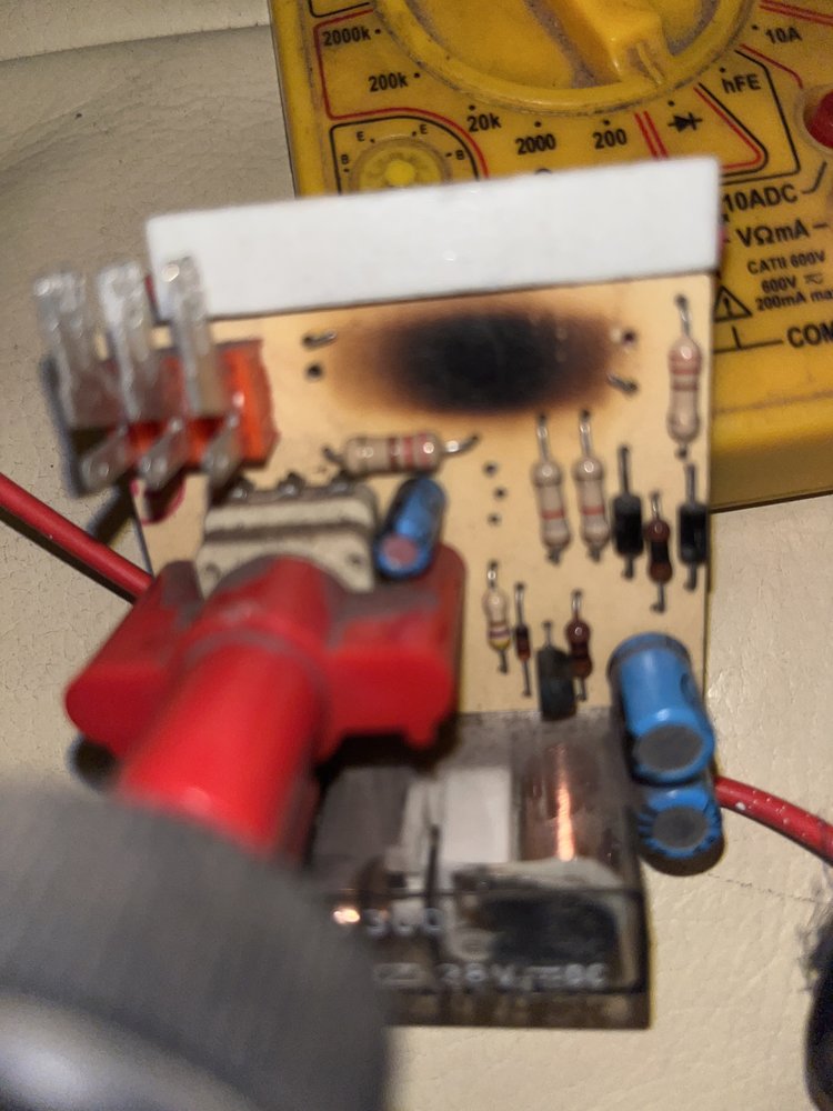

Just tested the SCR again and it's deffo shorted between annode & cathode, open between Annode and cathode to gate.
It's not assembled at the moment to test the trigger wire, however without it connected to the terminal the contatctor doesn't click.
