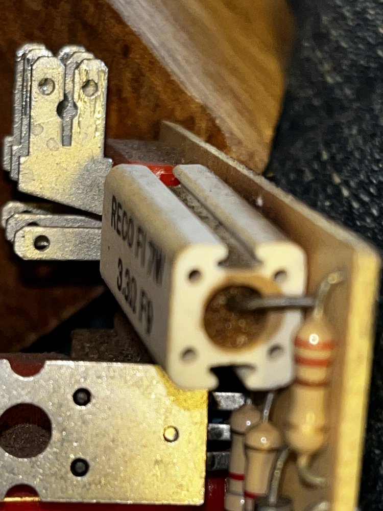

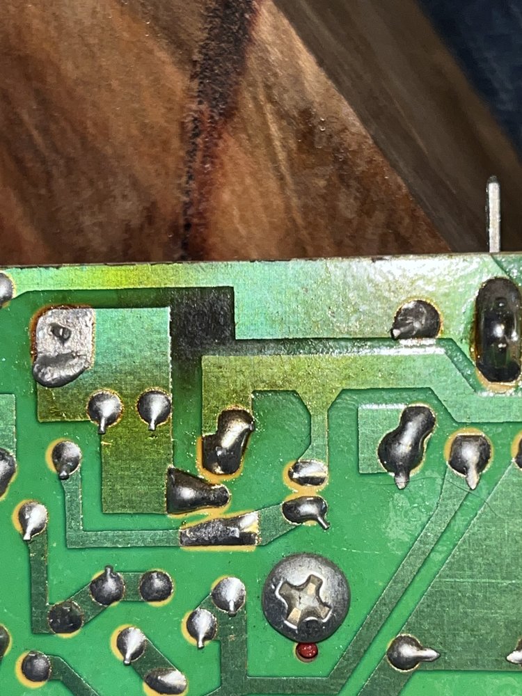

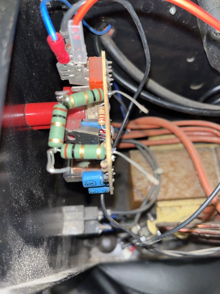

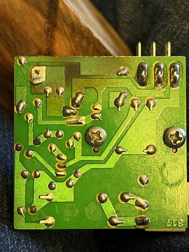

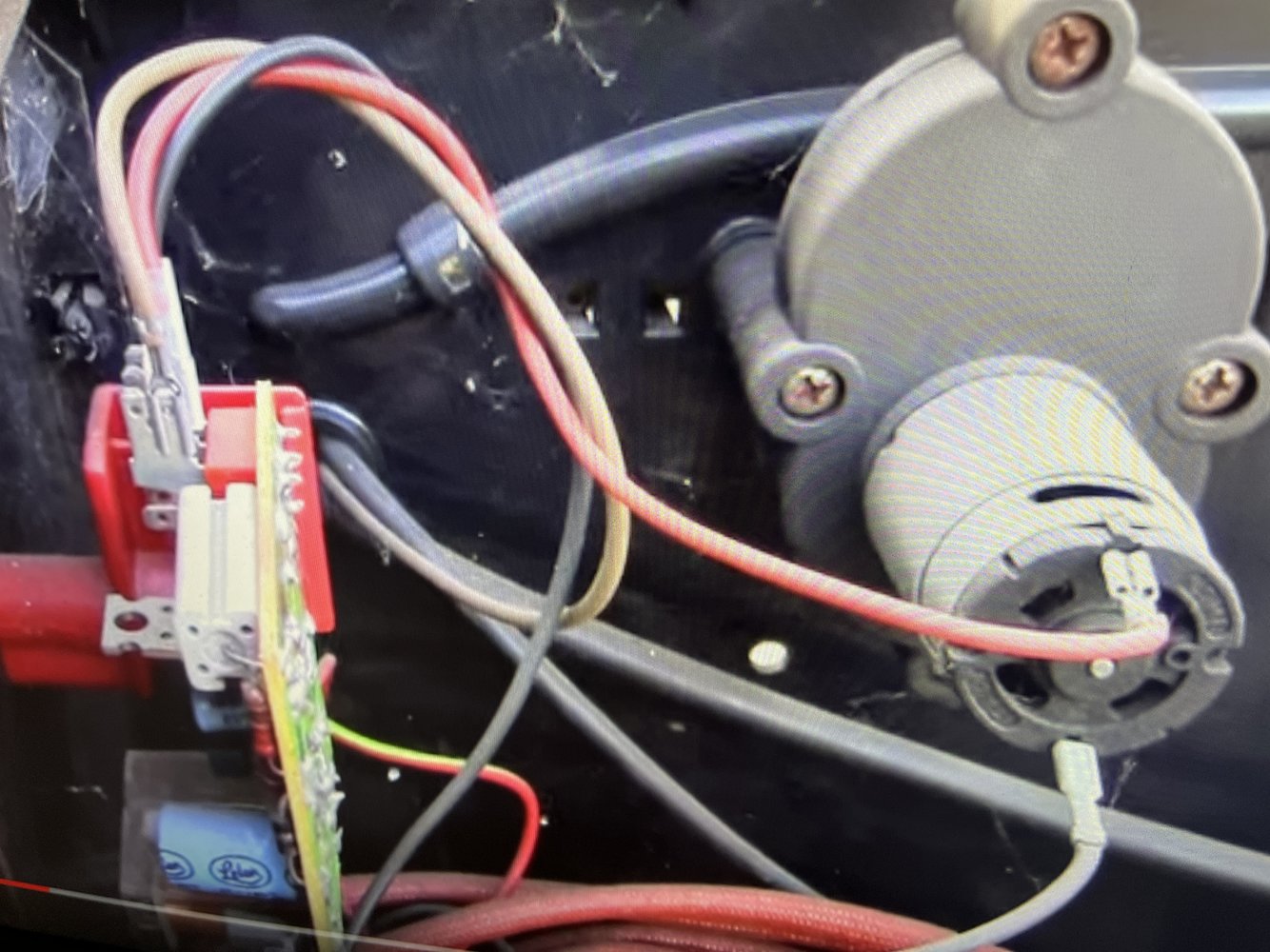

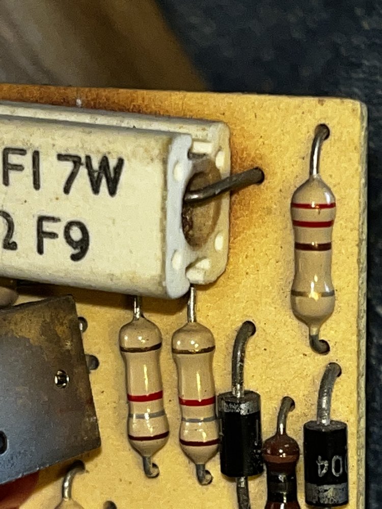

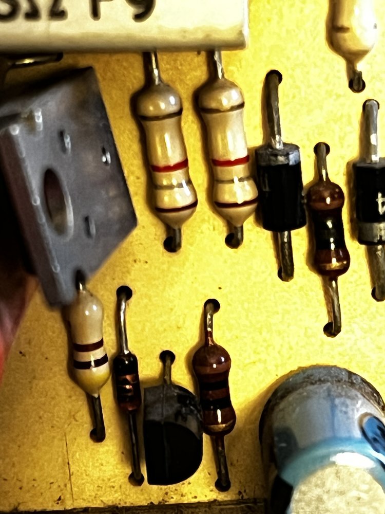

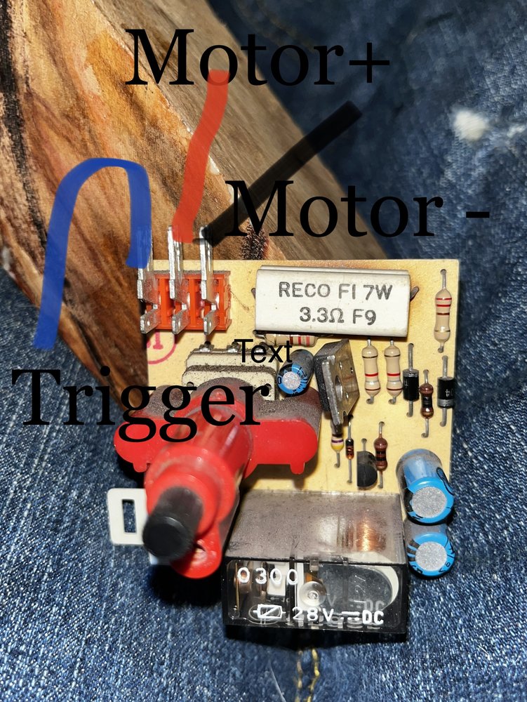

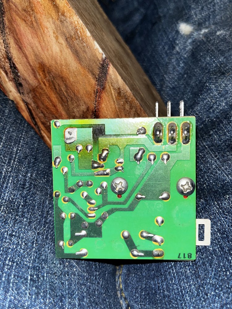

Hello all! Once again I have bought another welder in need of a bit of love.....
I bought this Cebora 883 for a whopping £15 of FB Marketplace, it had no torch or earth and needs a top roller / tensioner.
I have put a torch on that I had spare and powered it up. pressing the trigger makes the wire feed motor spin. However turning the wire speed knob does nothing at all.
I have tested the output on the wire speed PCB that goes to the motor and get from 12v on its lowest 1-min through to 25v on 2-max power setting.
I have looked at the board and can't see anything obvious that could be blown, however I only had a quick glance.
Anyone had any similar issues with one of these sets or similar?
Thanks in advance
