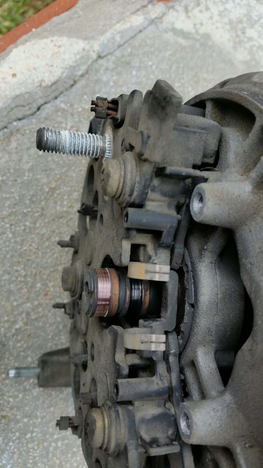

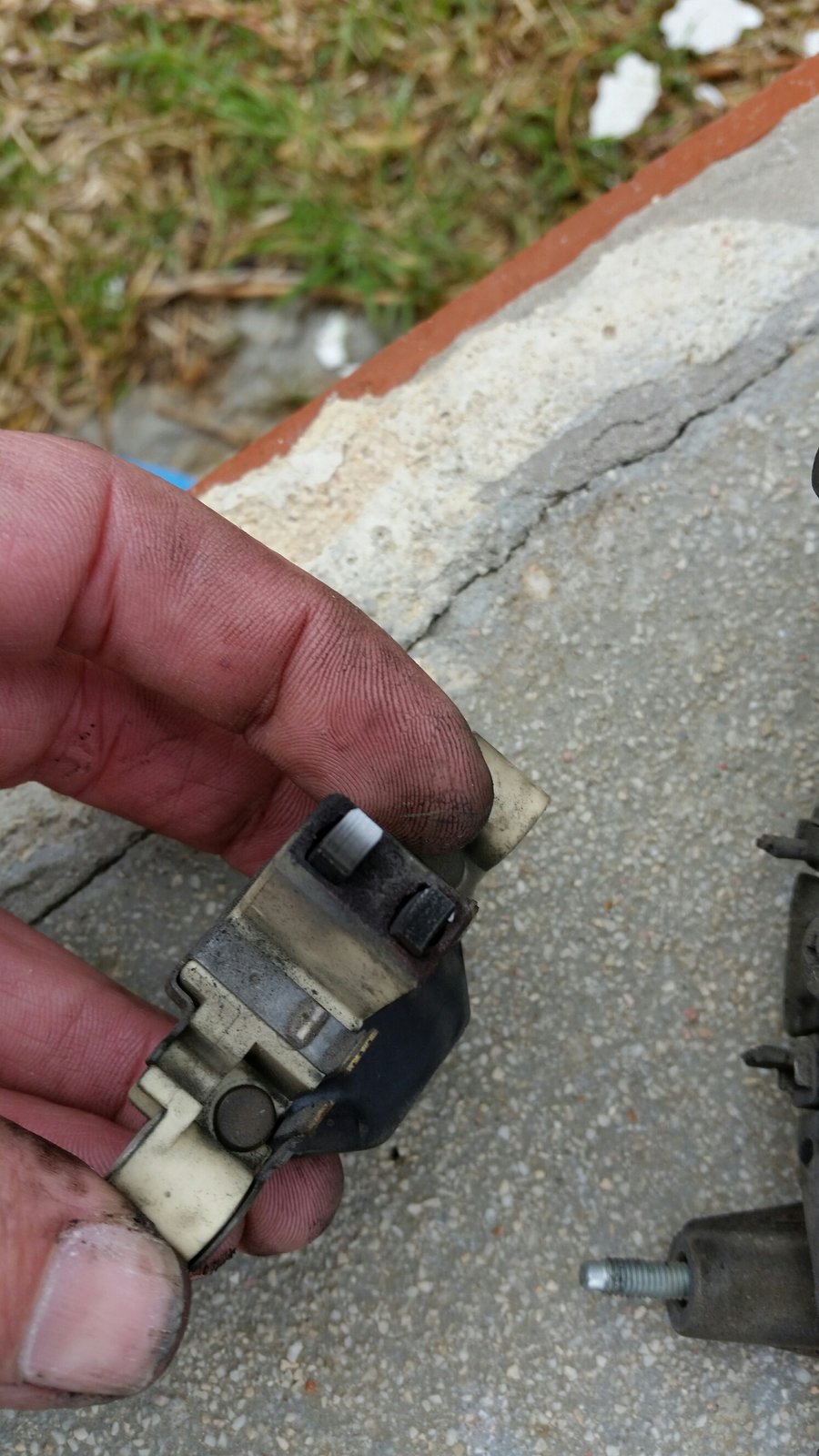

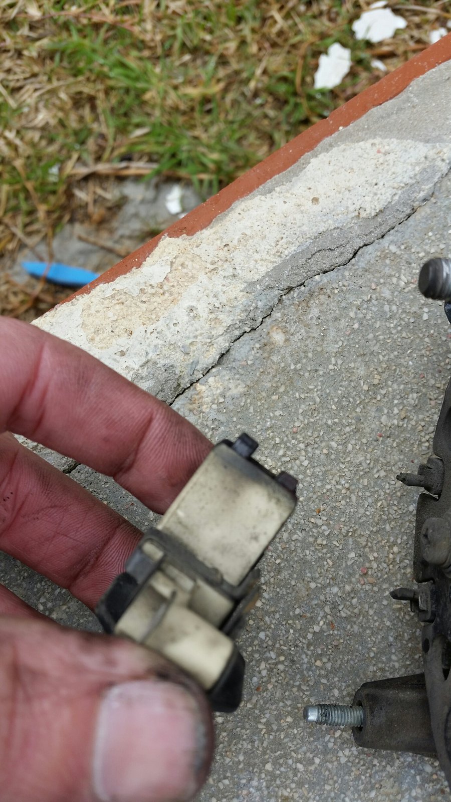

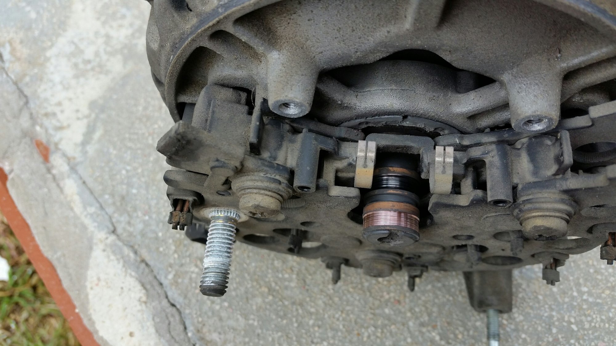

Battery light came on yesterday on my 98 seat alhambra.
Battery voltage 13.2.
12.6 When running no change at higher revs.
Pulled the alternator and by the looks of it one brush was not engaging as its dirty but the inner slip ring also looks worn. Should i just replace the regulator and see how it goes?
