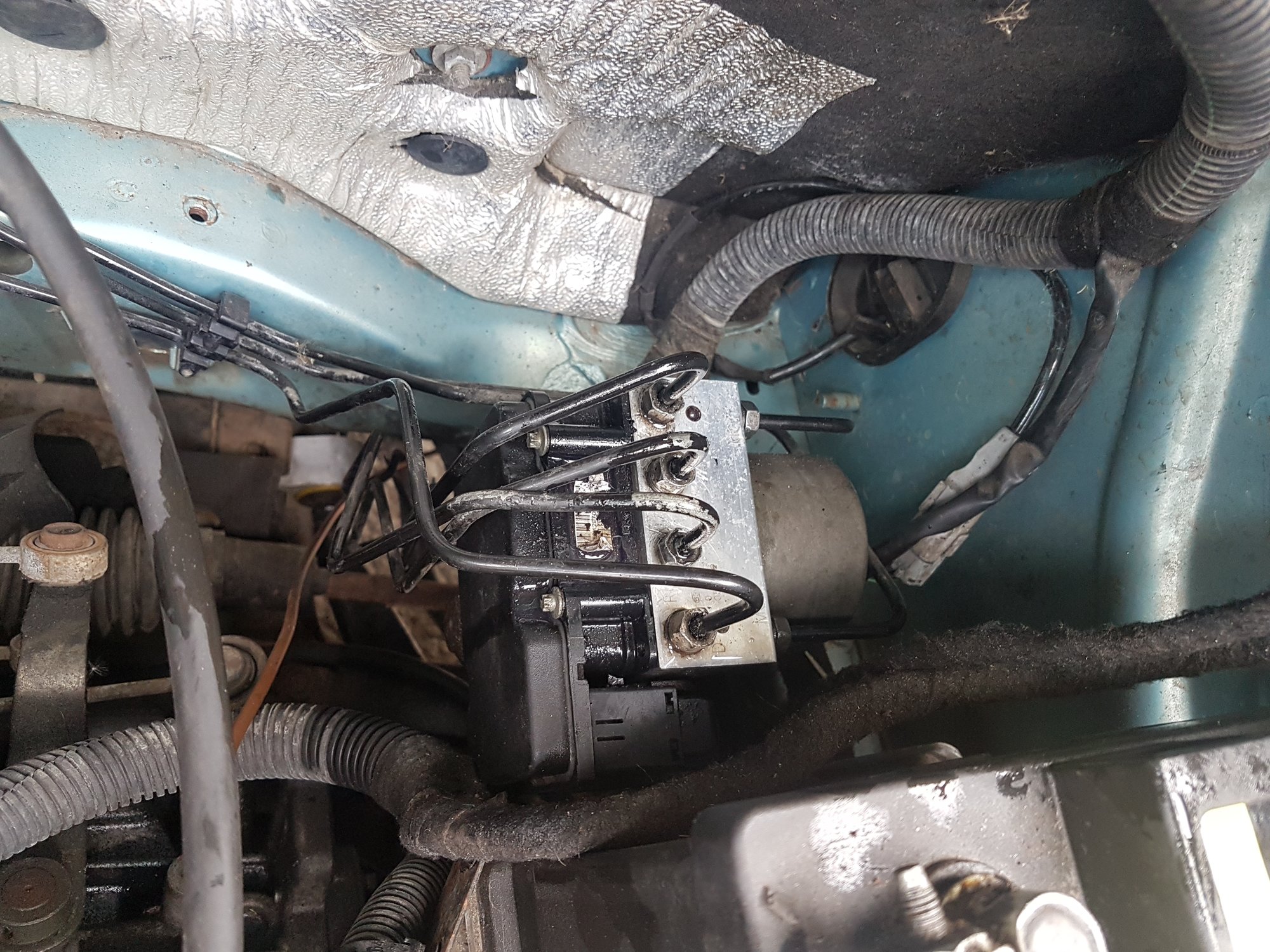

Well got a replies but at £200 for a used axle may sell go for recond for around £80 more, yes i get the lot brakes etc etc but no use to me as i have them.
That looks like an abs unit that the pipes are going into. If it is and air gets into it they can be impossible to bleed properly. I know on 406's that you need to use pp2000 to cycle the abs unit in a certain way in order to bleed it.
