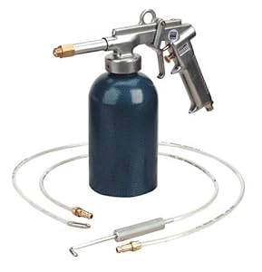

I'm not having much luck here. I bought two cans of Dinitrol 3125 HS, in 1 litre cans and a Schutz gun. These are the NON-aerosol cans. The stuff sprays nicely but nothing happens if I try using the cavity probe, the Dinitrol goes down the tube and doesn't come out the end. Read instructions, they say that the probe won't work with thicker products, suggests heating product.
The Dinitrol 3125 HS rattle cans come with a probe and they worked fine, but twice the price.
I'll try heating the Dinitrol. And I'll try it in the Sealey cavity gun, but starting to suspect the reason for the regular 3125 Dinitrol is that the 3125 HS is too thick to get into cavities
