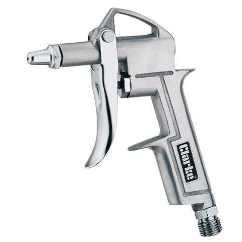

Can someone recommend a decent pro/trade make?
Fed up on these cheapy junk soft alloy ones that fall to bits.
Thanks!
Thanks!

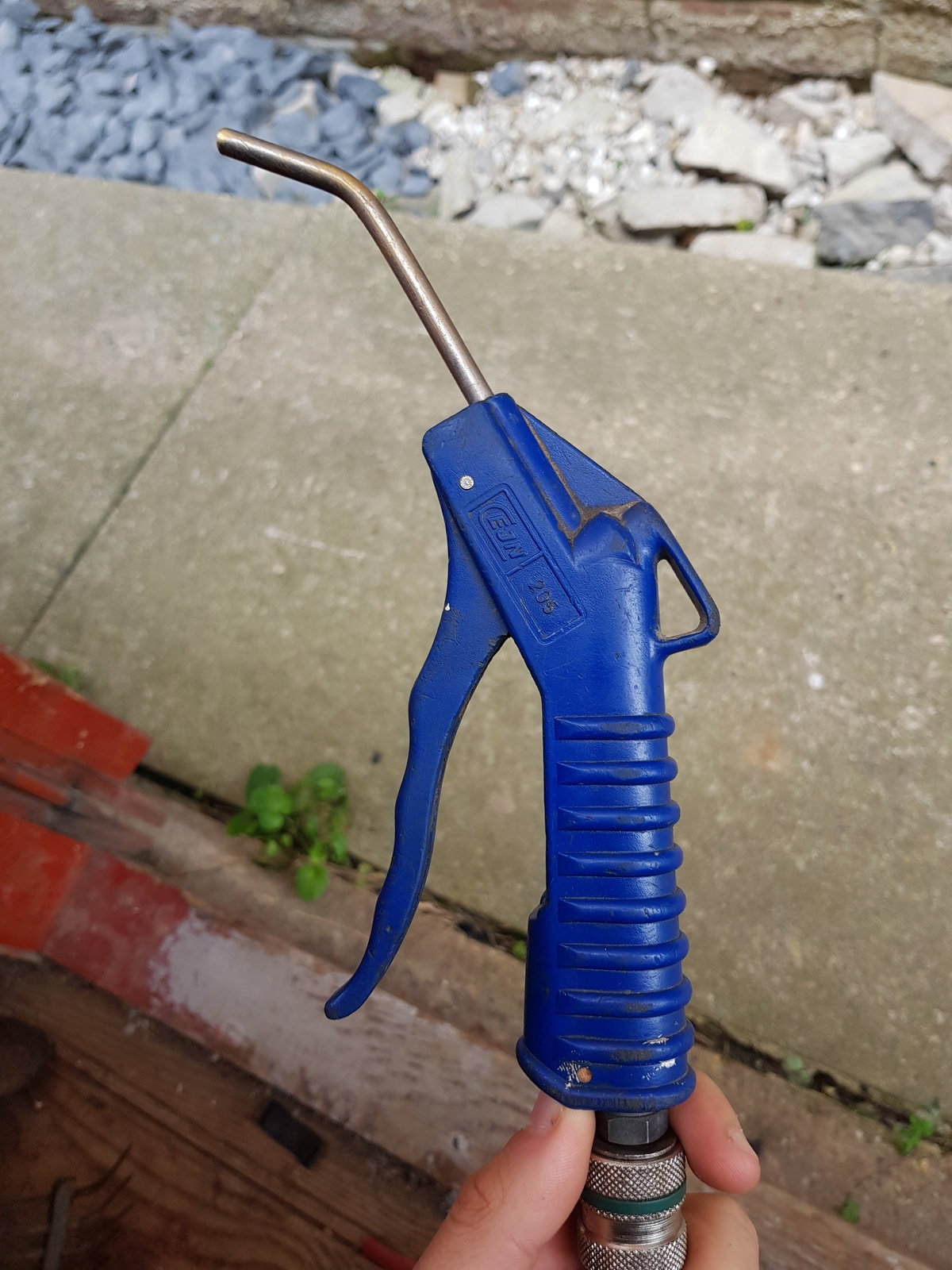

Get these, must have had mine three years. Cheap anyway just but a box of them if your guys keep busting themThis is mine;
It's got brass internals and tip and a Delrin body, I drop it all the time and it's never missed a beat. It's a Cejn 205, it seems they're still in business and make a few very fancy looking ones with all sorts of clever tip attachments.
